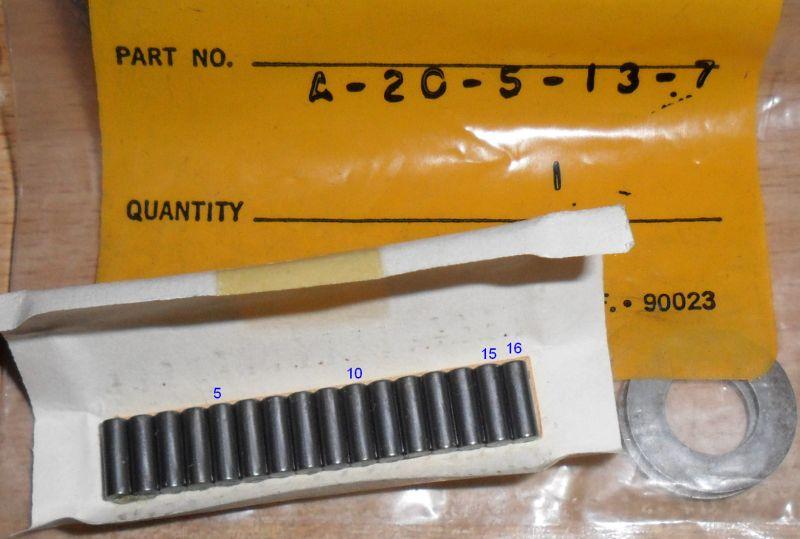

factory 487 #51 Posted March 2, 2020 I can't check tonight but I think the rollers from A-20-5-13-7 & A-20-5-16-7 may be the same as "20-5" is coded into both part numbers, 20-5 is the roller originally used in A-27-11. By the way I checked several packs of A-20-5-13-7 and they all have a waxed strip of 16 rollers, even though only 13 or 14 are needed depending on which service information is correct. David 1 CNew reacted to this Share this post Link to post Share on other sites

JUST O&R 237 #53 Posted March 3, 2020 Got digging in parts this morning The first pic is a-20-5-13-7 two different packages one has 13 rollers one has 16 roller. The last pic is a-20-5-16-7 all the roller are the same size the only difference that I see is the washers. All of this were on opened 1 CNew reacted to this Share this post Link to post Share on other sites
CNew 408 #54 Posted March 7, 2020 This roller situation may have just gotten a little more weird. Big thanks to JustO&R for providing the spare bearing rollers and plastic bearing cage! Good news is the plastic cage fit great. What is strange is when I started putting the connecting rod bearings back together I tried to use one of the spare rollers and there is absolutely no way to get 14 rollers in there. Everything measures out to be the right size It seems odd to have almost a full roller gap in there but maybe it’s only suppose to have 13. That matches the set that JustO&R reference only having 13 as well. I put it all back together with just 13, guess we will see what happens. I can send these spare spare rollers back to you JustO&R so you’ll have them when you need them in the future. Share this post Link to post Share on other sites

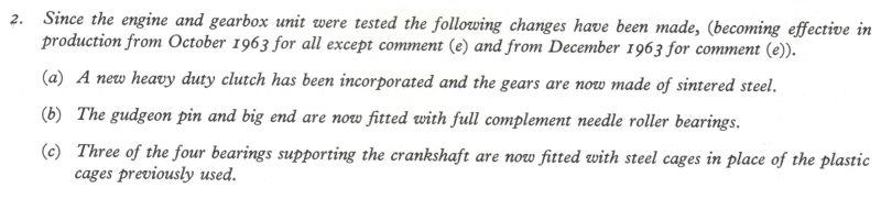

factory 487 #66 Posted March 8, 2020 18 hours ago, Wallfish said: Look at the engine rebuild thread. That rod uses plastic cage bearings. Two engines I did recently, same thing. No plastic cages on the last two engines and they have the open rollers with washers. Guessing that's what's going on. They updated them in 1963 to use all metal parts for the bearings with no change to the dimensions, the slotted con-rod is used with the all metal con-rod main bearing as previously mentioned, no need for guessing. See both points (b) & (c) in the NIAE test report below. Later engines increased the diameter of both the crank-pin for the con-rod bearing & the big-end bore of the con-rod, hence the need for 16 rollers instead of 13. David Share this post Link to post Share on other sites
CNew 408 #67 Posted March 8, 2020 Nice work David, case closed Share this post Link to post Share on other sites
