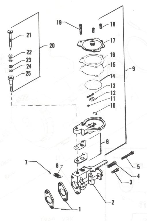

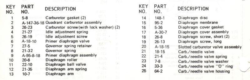

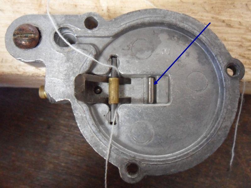

factory 487 #29 Posted March 10, 2020 22 hours ago, francisco said: i just took these pics that last pic was from one i found on google just checked out the member factory tutorial on that carb and it looks the same as mine only difference is the gas line port position and i noticed its only missing the little lever/arm inside has the rest it runs i just blew thru the top of gas tank to get gas to carb and starts right up Looks in very nice condition, it's the slightly less common & later large gas tank version. 19 hours ago, francisco said: its still needs the arm and probably a new spring too been looking all over for anyone selling the parts or a complete carb It's usually the little rod, ball bearing & U shaped spring that go missing. The engine on your Tiny Tiger dates from 1968, so unless the carb has been replaced it should use the standard arm & ball bearing check valve, those U shaped springs only have a slight bend & are usually reusable. Typical late 1960's carb diagram & parts list below; 17 hours ago, francisco said: i also have all the paper work and instructions with the parts list for it its in the original box i could look up part number for you if that helps and i just noticed that the plate for it the rim of it the little lip that it has is bent about half way around The plate? Is this the one attached to the cylinder? If it is someone has bent it to get the carb needle valve out without removing the carb from the engine. David Share this post Link to post Share on other sites

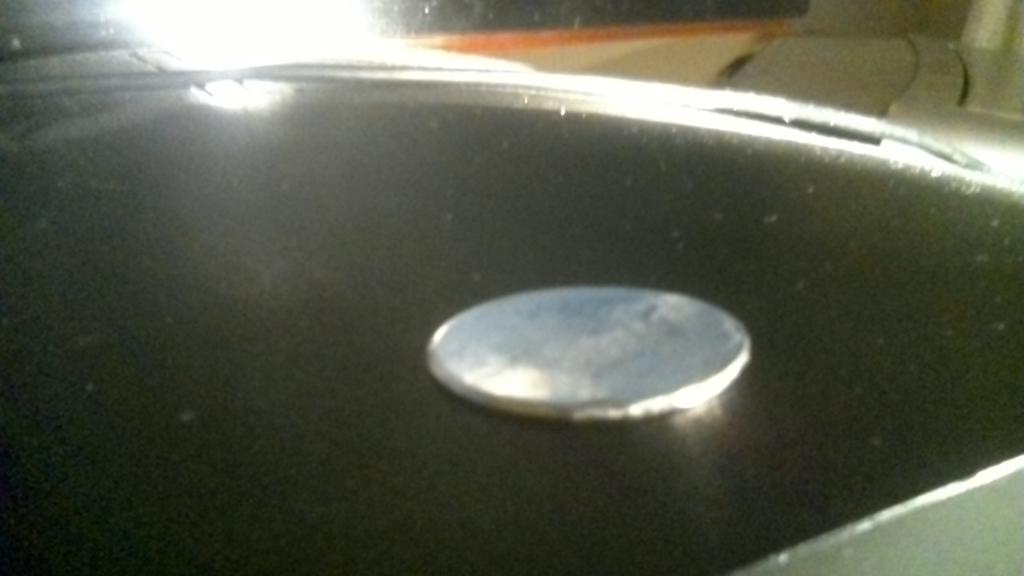

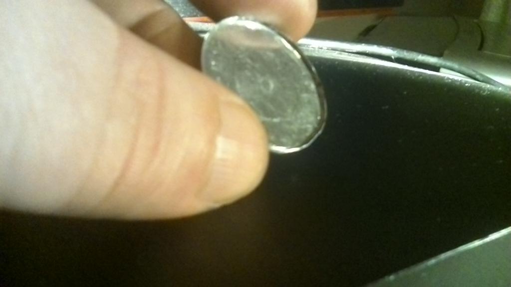

francisco 4 #30 Posted March 10, 2020 #14 the diapdram disc is bent im missing #10 #13 everthing else is mint yes the larger tank with the base on it Share this post Link to post Share on other sites
factory 487 #31 Posted March 10, 2020 Can the diaphragm disc not be straightened? Later carbs had a smaller flat disc glued to the diaphragm. I've used shafts taken out of broken cassette players to replace the roller and cut them down to fit. I thought Wallfish was looking for the diaphragm arm for you, give him a chance to look through his spares. David Share this post Link to post Share on other sites
francisco 4 #32 Posted March 10, 2020 i flatted it and put the little lip it had around the edge i got it as close as i could. yea im waiting wallfish and Cnew to go through their stash when they have time too Share this post Link to post Share on other sites

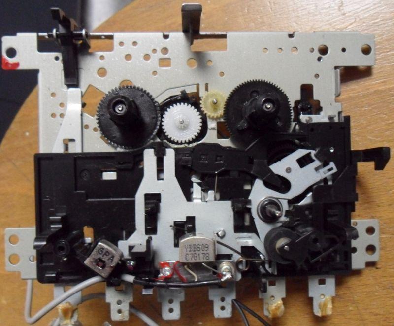

factory 487 #35 Posted March 10, 2020 (edited) I save the shafts from any broken electronic gadgets I take apart, cassette players are just one example of something that may contain these, here is a random picture of a cassette player mechanism I've recycled, full of little parts that can disappear under the bench. Here is one I made earlier (from a cut down shaft) fitted to the carb diaphragm bowl. Model engineering shops would have suitable diameter rod too. David Edited March 10, 2020 by factory Share this post Link to post Share on other sites
francisco 4 #36 Posted March 10, 2020 thanks for the info on the bar i just went through my kids rooms and in my 4y room found a broken toy car cut off the rod for the tire sized and filed to fit snug it looks like the original one 2 CNew and factory reacted to this Share this post Link to post Share on other sites

CNew 408 #39 Posted March 11, 2020 That’s not too bad, nice job flattening it out. I think it should still work, it’s definitely worth a try anyway. Share this post Link to post Share on other sites
francisco 4 #40 Posted March 11, 2020 thanks im hoping and praying it does work out i tried my hardest to get the little lip on it as smooth as possible Share this post Link to post Share on other sites
CNew 408 #41 Posted March 11, 2020 It shouldn’t be an issue, especially since most of the rim looks ok, it just has to make contact with the bottom of the carb when the lever is pushed down. I’ve seen much worse that still work. 1 francisco reacted to this Share this post Link to post Share on other sites
