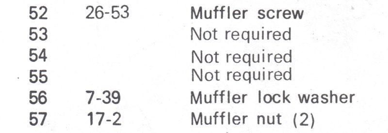

factory 487 #8 Posted March 22, 2020 On 3/21/2020 at 5:16 PM, JUST O&R said: Clint I think the exhaust bolt you need is a 26-53 its 3-1/4 long The generator I have has that muffler and that what itlook like. I have 10 of them if you need one Looks exactly as shown in the manual picture below, never seen one of the larger tank versions with an engine that early though. David Share this post Link to post Share on other sites
CNew 407 #9 Posted March 22, 2020 Mine has a Type 189 engine. Share this post Link to post Share on other sites
factory 487 #10 Posted March 22, 2020 Confirmed it uses a type 26-53 muffler screw, other standard parts not required. David 1 CNew reacted to this Share this post Link to post Share on other sites
