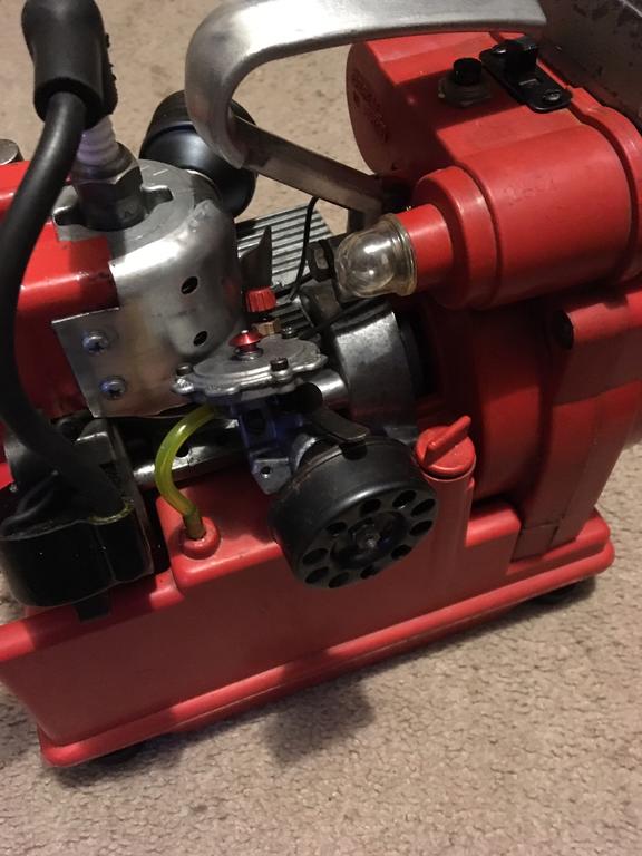

factory 487 #27 Posted April 5, 2020 11 hours ago, Wallfish said: Fixed'm for ya Sling Blade. I need to find a cover for the light bulb. Since you're the lawn mower man, would you happen to have a clear fuel primer bulb that size? Having looked at the pictures of your Creme Lure, I believe someone has shortened the threaded part for the lamp cover. By the way I did find a lamp cover that is close to the original but not the same thread, in the process I took the lamp out of mine and now can't get it back in, I guess the lamp holder is too badly rusted. David Share this post Link to post Share on other sites
Wallfish 717 #28 Posted April 5, 2020 Mine does not have any threads inside the hole to screw a cover in. Think it must've been just a push in thingy or nothing at all. I had to fix my bulb socket as it just spun while trying to install the bulb. Most likely your problem too? Share this post Link to post Share on other sites
factory 487 #29 Posted April 5, 2020 On 4/3/2020 at 2:20 AM, Wallfish said: I was comparing it with this picture, it looks shortened to me and the edges are all rough, someone's modified it just don't know why. The holder in mine could be loose, will need to repair it or replace the lamp holder if the contact spring has rusted through. David Share this post Link to post Share on other sites
JUST O&R 237 #30 Posted April 5, 2020 4 hours ago, factory said: Fixed'm for ya Sling Blade. I need to find a cover for the light bulb. Since you're the lawn mower man, would you happen to have a clear fuel primer bulb that size? Thought I replied before on this you guys are making me loose what little mind I have left . But now i see it was in the other post I do have primers in a few sizes Got those rite This may help. Share this post Link to post Share on other sites
Wallfish 717 #31 Posted April 5, 2020 2 hours ago, JUST O&R said: I do have primers in a few sizes It's difficult to see the size of the bulbs without any reference but if one of those clear 2 in the middle looks like it could used, let me know. Is one about the size of the cover on the Nichols? 7 hours ago, factory said: Looks more like small neon glow lamp to me, filled with neon gas not a vacuum. What would the purpose of that be? Share this post Link to post Share on other sites

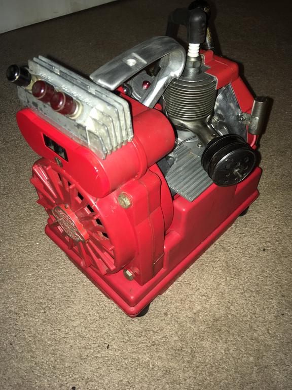

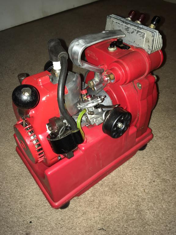

Wallfish 717 #32 Posted April 5, 2020 Got it all soldered up, cracks reinforced with epoxy and cleaned up best I can. All the electrical stuff works (in theory) using a meter and a couple of smaller batteries taped together for a power source. Haven't run it to test the generator power. Had to drill a hole in the top of the tank to get the fuel line all straightened out. It's undetectable with engine on and sealed using Seal All. 4 Fishnuts2, factory, JUST O&R and 1 other reacted to this Share this post Link to post Share on other sites
CNew 408 #33 Posted April 5, 2020 Man, you made quick work of that one, especially given all the speed bumps you hit along the way. That looks really nice, such a cool generator! 1 Wallfish reacted to this Share this post Link to post Share on other sites

Wallfish 717 #36 Posted April 17, 2020 Seems the primer bulb light cover is a success and fit perfectly. Thanks for sending those Terry @JUST O&R. Probably not the best solution ever but it works for this one as it's just a display piece anyway and now looks much better with a cover over the bare light bulb. 1 CNew reacted to this Share this post Link to post Share on other sites
