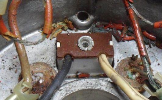

Mebob2 8 #5 Posted April 13, 2020 The diaphragm is very flexible when you touch it, no signs of being brittle. But I think your right the only way to be confident it’s truly cleaned out is to take it off. I don’t mind getting a new diaphragm I was just trying to rush things along a bit. I got points cleaned , adjusted and got a nice spark back so was getting anxious to see if it would fire up. Got a little aux. fuel supply geared up. I want to clean polish tank before I put back on. I attached a pic of some parts that came with them, are they even any part of these tiny tigers? Share this post Link to post Share on other sites

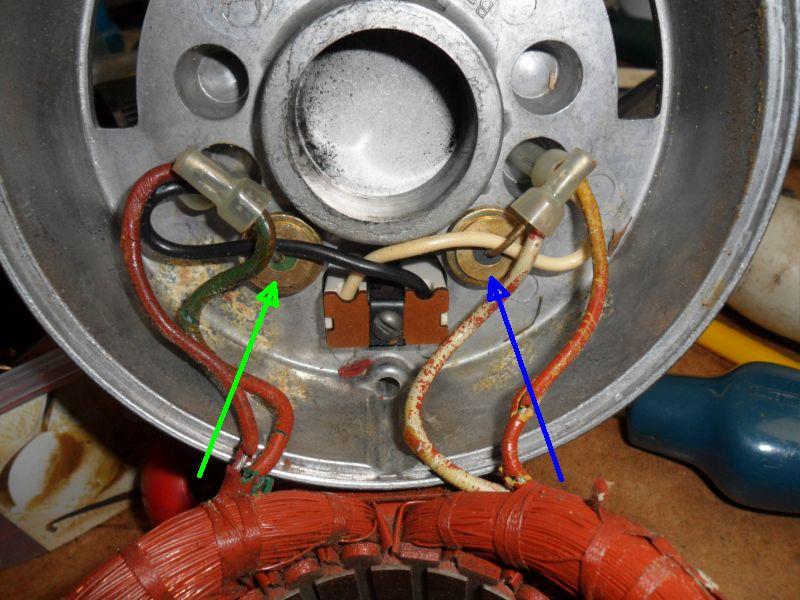

factory 487 #6 Posted April 13, 2020 (edited) Those are "press fit" diodes, they look similar to those used in the alternator part of the Tiny Tiger, which are used to rectify the AC generated from the alternator windings to supply the low voltage DC for battery charging. Do those have a part number on them? I've no idea why these diodes in my Tiny Tor have two different colors in the center, the picture also shows extra holes for the diodes to fit into, those are only used if one fails. Also available in "gold-plated rust" finish in my older Tiny Tiger. David Edited April 13, 2020 by factory Extra Info Share this post Link to post Share on other sites

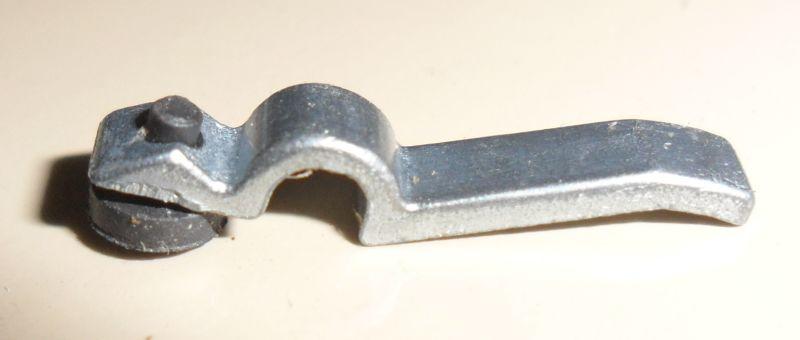

factory 487 #14 Posted April 15, 2020 20 hours ago, Webhead said: The rubber tipped lever is another story....I'll let someone else elaborate. The older engines used a ball bearing for the valve under the diaphragm arm, this would often get gummed up with stale gas/oil mix, they even recommend replacing the ball bearing instead of trying to clean it, but at least you can still get ball bearings as they are a standard part. The redesign uses the rubber seal on the diaphragm arm, these seem worse than the ball bearing as they no longer seal due to gas/oil mix and/or ageing badly. Unfortunately the seal was sold with the carb repair kits, same as the brass valve only being available in a new carb diaphragm bowl assembly, I can't help thinking one reason they did this was to generate more parts sales. The diaphragm arms with rubber seal are very difficult to find now, if it's bad you could replace the carb parts with the older versions (i.e. the carb bowl bottom half, a ball bearing & the older diaphragm arm). David P.S. Avoid using any gas that contains ethanol for the fuel mix for these engines, look for ethanol free (non-oxygenated) gas instead, it may be harder to find, but it should cause less problems with stale gas, swelling of rubber seals and corrosion from it attaching moisture. Share this post Link to post Share on other sites
factory 487 #15 Posted April 15, 2020 On 4/13/2020 at 11:59 PM, Mebob2 said: OK thanks for that picture, that is a Motorola 1N3491R diode rated at a maximum of 50 volts at 25 amps (date code week 49 of 1973), the 'R' in the part number indicates the polarity being anode to the case. This seems to have suitable ratings for the Tiny Tiger charger circuit and is the correct polarity. Note: This component is now obsolete, any for sale will either be new-old-stock or relabelled parts. Question is why they are with the Tiny Tigers, could it be possible they were returns that never got repaired? The manual does mention that they can get damaged if the battery is connected the wrong way round. David Share this post Link to post Share on other sites
Mebob2 8 #16 Posted April 16, 2020 Thanks for the info Dave and you brought up my exact question when you first mentioned they were diodes. Why 4 spare? hmmmmm. You mentioned battery being hooked up wrong way around , as clean and new as they appear to be I noticed a tiny mark on the side of one generator, first thought when I seen it was a electrical burn mark, as if positive lead touched case. I don’t know how much it would take to burn out a diode. On another note, I got my check valve working. Between soaking in wd40, Zep citrus HD degreaser, drill bit , paper clip and air pressure. I finally ever so gently got it moving, then open but very stiff. Kept at It every few hours. At first As hard as I could blow I could hardly get a squeak through it. A little can of compressed air would blow through no problem and still seal in opposite direction. Now I can blow through it and can’t suck through it. Not super easy but not bad. I’m assuming they have to move super easy. It seems that the rubber could be slightly swelled (As mentioned) but it’s getting better. I’m going to stick It in boiling water for a minute or two, might shrink rubber just a touch. Again I appreciate you help, tremendous insight and conversation. tks, Rob Share this post Link to post Share on other sites
