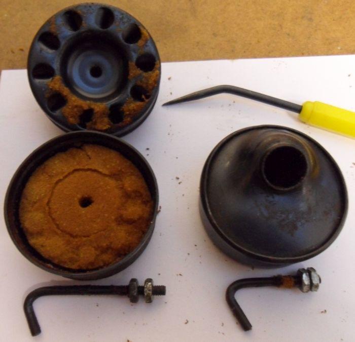

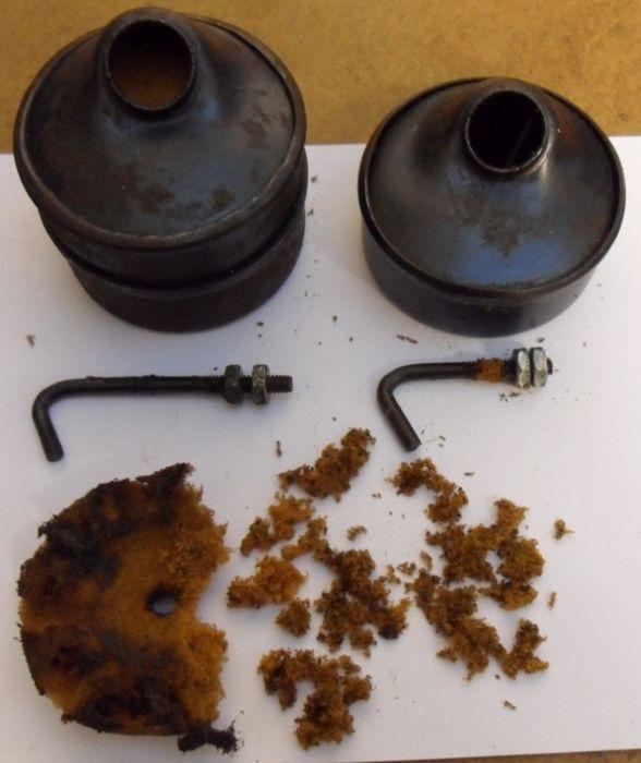

factory 487 #34 Posted April 18, 2020 12 hours ago, Mebob2 said: Also the advice about taking out the air filter before starting an old O&R was huge. I gingerly took mine apart, laid filter on bench it looked almost perfect, a little push on the top of it and the hole thing literally disintegrated, turned to powder. They can really ruin your day if they get sucked in, here are pictures I took a while ago to show how bad they are even if they look in one piece. They usually don't survive long enough for my to get the camera out. Before After There are two pieces of foam to clean out of the double air cleaner, I find one piece of new pre-filter is usually enough in both types (this may vary depending on type of foam you use). David P.S. I find similar disintegrating old foam in the vintage electronics I repair, I had to replace some yesterday in a HP voltmeter from the 1970's (used to either keep circuit boards in place, or prevent vibration being transferred to certain parts, such as some vacuum tubes). Share this post Link to post Share on other sites
