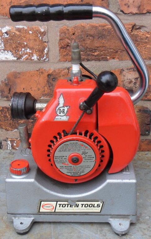

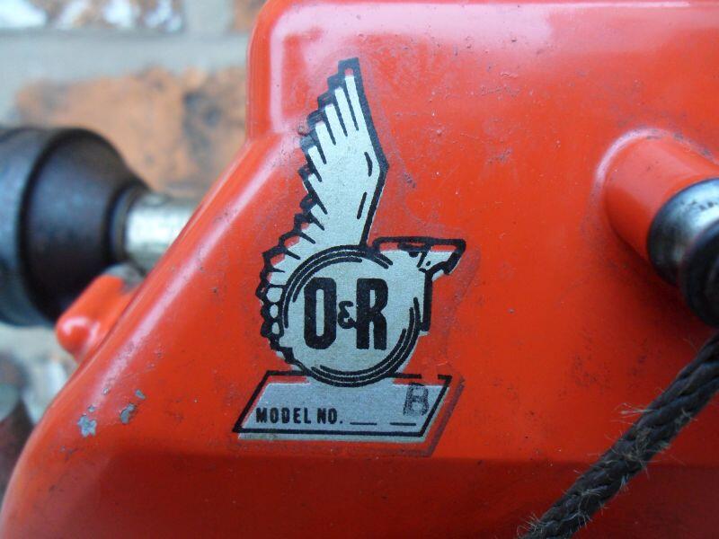

factory 487 #5 Posted May 22, 2020 That's the second O&R pump Cnew has that's missing the pump section, I don't think mine has an intact impeller either, being made of rubber they dry out & crack up with age, as well as fail if run dry. I do have at least one pump with a good impeller here somewhere. The handle is attached on the other side of mine, it's also one of the few older engines I have with the Model letter printed on the decal, I had to fit a new set of feet as the originals were falling apart; David 3 pmackellow, JUST O&R and CNew reacted to this Share this post Link to post Share on other sites
Wallfish 718 #6 Posted May 22, 2020 The one I have is also marked on the label with a B. It's been a very long time since and can't remember exactly what it was from but I found a new impeller to fit. Think it came from one of those drill pumps My handle comes from the coil side as well but they obviously could be switched. Not sure why Share this post Link to post Share on other sites
factory 487 #7 Posted May 22, 2020 That would be very useful if you can remember, I've looked at lots of impellers and have so far been unable to find one of either the correct size or shaft fitting. David P.S. Odd that the engines are labelled B as that is supposed to be the standard engine supplied with an O&R base tank. Share this post Link to post Share on other sites

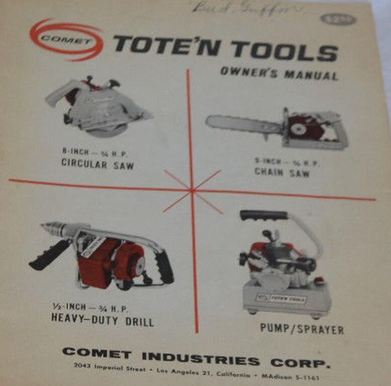

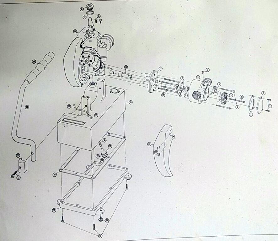

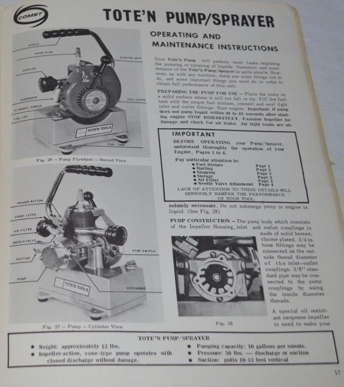

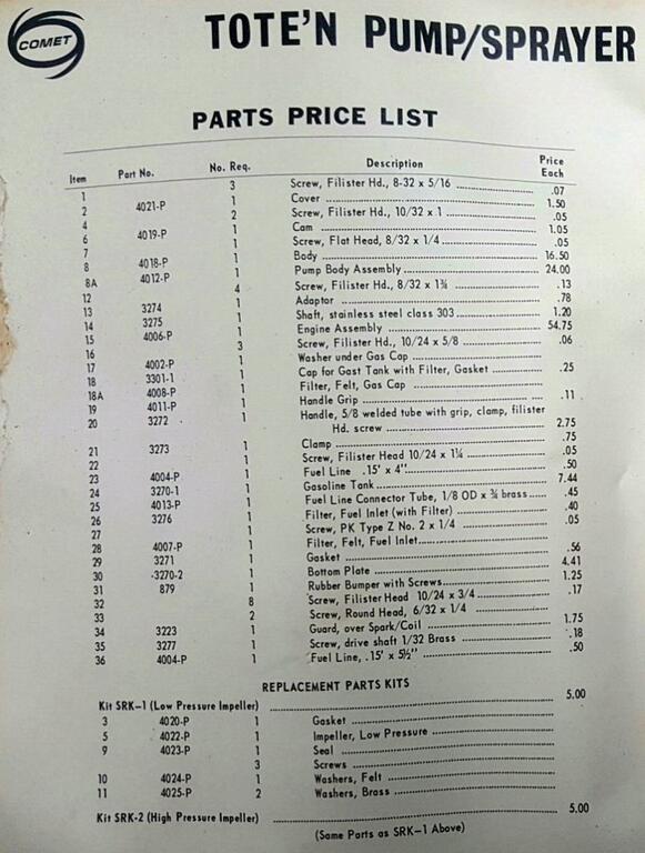

factory 487 #11 Posted May 24, 2020 1 hour ago, JUST O&R said: On 5/22/2020 at 4:20 PM, Wallfish said: My handle comes from the coil side as well but they obviously could be switched. Not sure why I thought that would be simply to figure out. ( some people are left handed) It's shown fitted on both sides in the manual, I don't have any original combined manuals that cover the four Comet Tote'N Tools, there are two versions (still looking), the C/Saw did come with a manual that only covers the C/saw. The other version of the Comet manual below was originally posted by @neons . David P.S. the only Comet tool I'm missing is still the chainsaw, OK I don't have the Comet drill but do have a much later Drillgine version. Share this post Link to post Share on other sites
