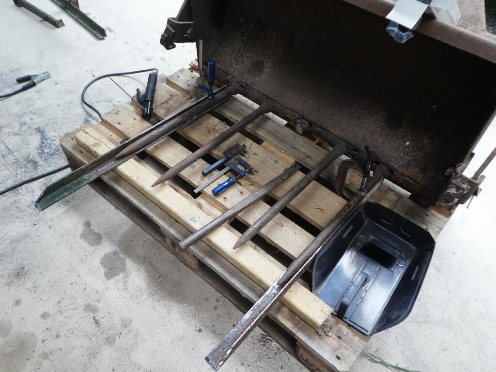

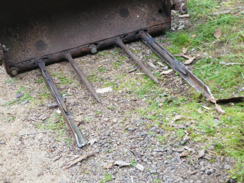

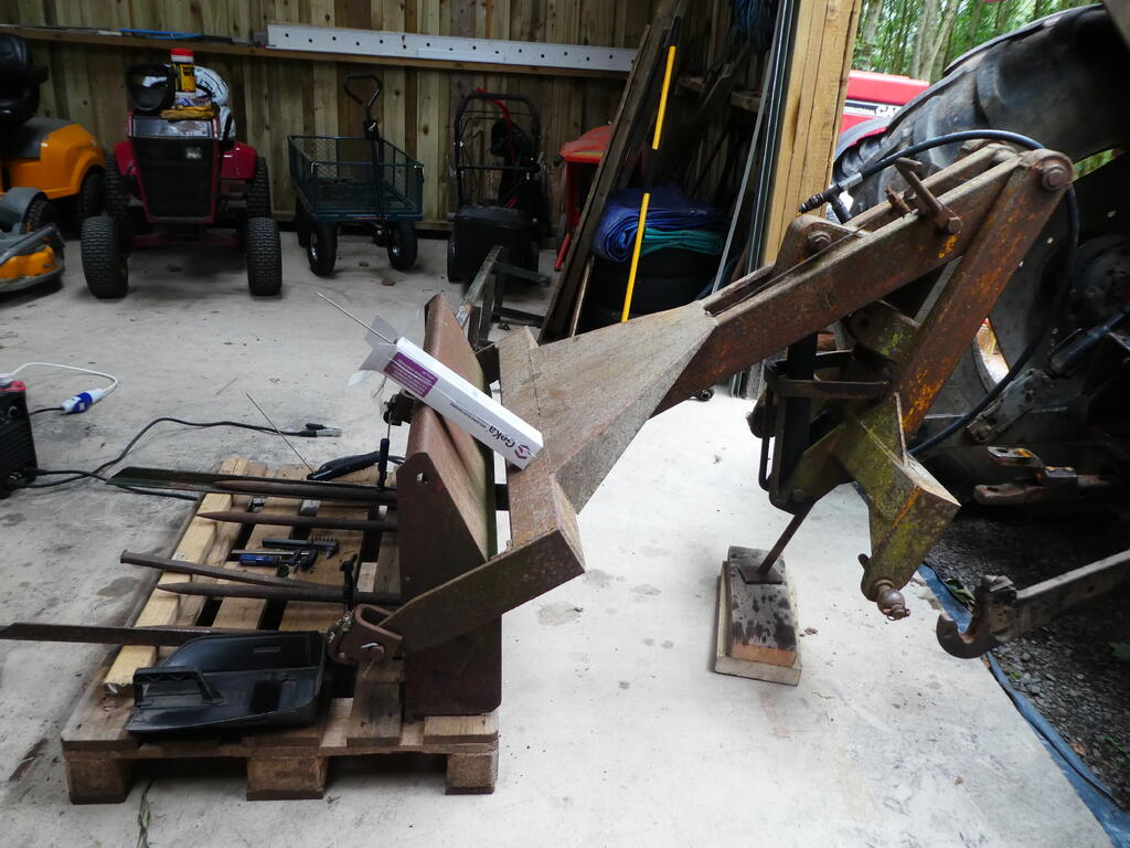

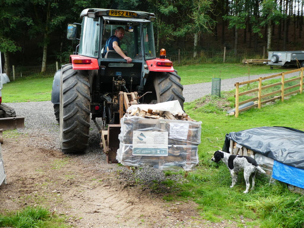

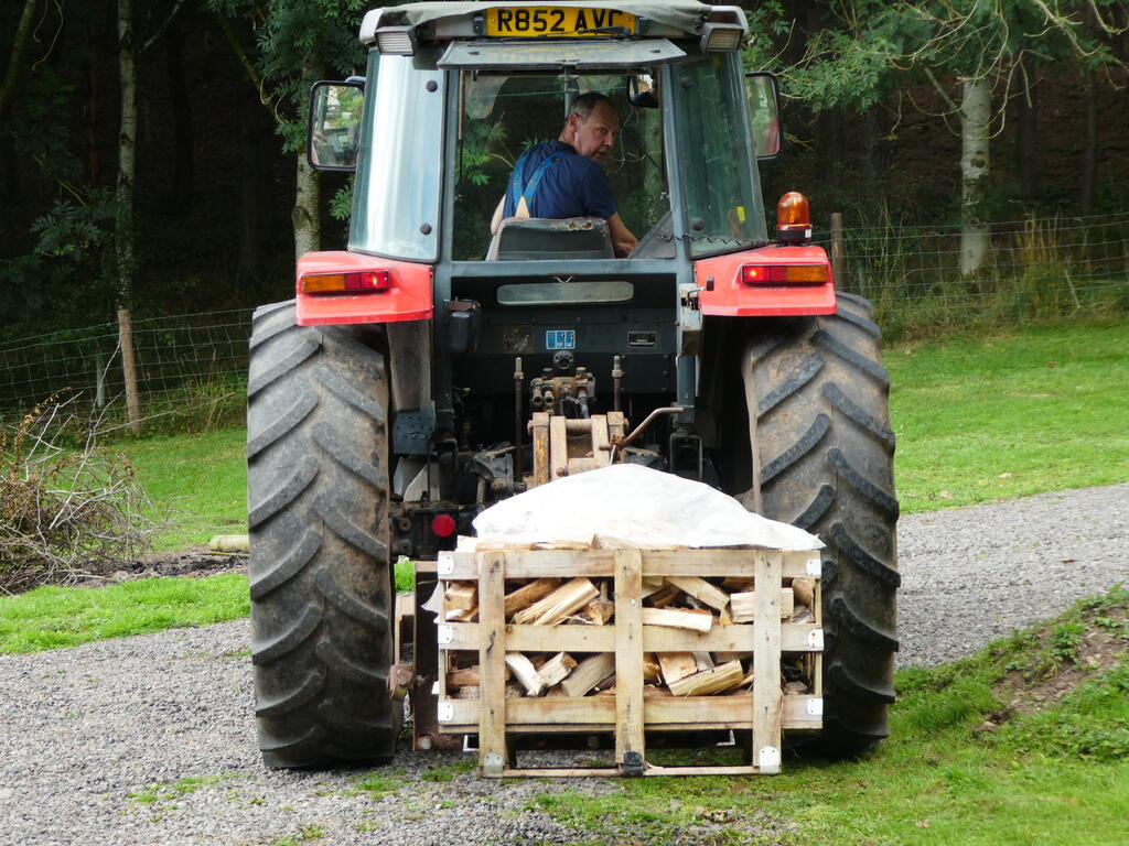

Stormin 4,458 #1 Posted August 19, 2021 My mate Dunc had an old buck rake of unknown origin lying about. For fitting on the rear of a tractor. We'd got it into the workshop last week to see what we could do with it. First thing was a new hydraulic hose which Dunc had got made earlier this week. With that fitted we set too to make it into a forklift, for mainly moving crates of firewood. First we cut off the two outside prongs and the centre one. Then some scrap angle iron was welded to the now outside prongs. This was to extend them to reach fully under a pallet. Pleased to say things worked well. And cheap as well. 3 nigel, ranger and expeatfarmer reacted to this Share this post Link to post Share on other sites
