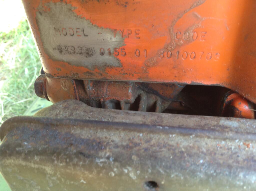

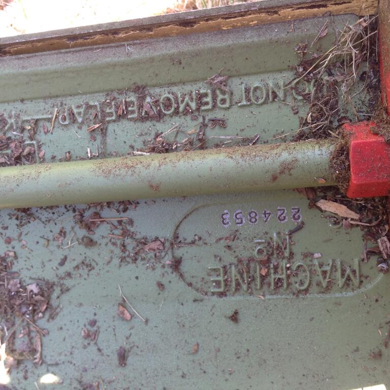

Anglo Traction 1,018 #8 Posted June 4, 2023 Afraid. there is still a problem with that first number. It cannot start with 224 on a B&S engine of 1980. a few pics of the numbers and the machine will help. Have a look at this Topic- B&S I/D Share this post Link to post Share on other sites
Aldy 1 #9 Posted June 4, 2023 Cleaned up rust area and found another number Model No 94908 Type 015501 Code 80100708 Machine No 224853 See attached photos 1 Lauren1985 reacted to this Share this post Link to post Share on other sites
Anglo Traction 1,018 #10 Posted June 4, 2023 OK, That is exactly what I need. It's below 10 cu inches, so model nbr is only 5 digits. The last digit will be an '8' which refers to the starting method (Vertical manual pull). If it was a 3, you would have a 110volt gear drive start!. I'll get back on here when I've checked the Service Manual. Share this post Link to post Share on other sites
