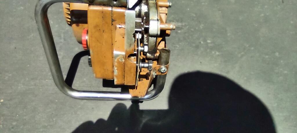

Wallfish 718 #6 Posted August 15, 2022 That's a Mustang saw. Lots of parts on ebay. Can you post close up pics of the carb problem? Share this post Link to post Share on other sites

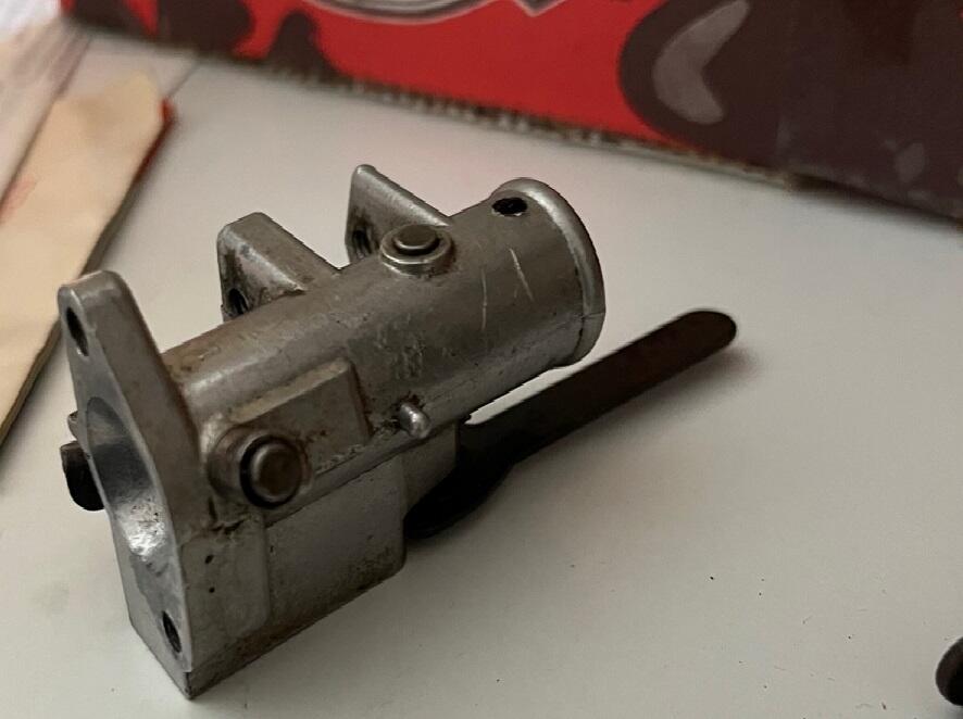

Wallfish 718 #8 Posted August 15, 2022 Many carbs are interchangeable as those type are the most common. Not just chainsaws but most O&R engines have those which will bolt right on. If the ear is completely broken off then you will probably need a replacement. Repairs will not be strong enough to hold it tight and the vibration will probably crack JB weld. If it were just cracked then maybe it's salvageable. The little ball bearings can typically be found in the old school type hardware stores with the little drawers full of that small stuff. There were 2 different size bearings used--they are 1/16" or 3/32" ball bearings Found a carb body if you need it Share this post Link to post Share on other sites

Wallfish 718 #11 Posted August 17, 2022 A closer look. This cover is different from the Mustang saws but that seems to be the only major thing that's different. Maybe the paint color but that could just be pics. Many were branded under different names with minor adjustments like many other O&R tools were. Mostly paint and decals but some with body panels too. All the other parts are the same. Share this post Link to post Share on other sites

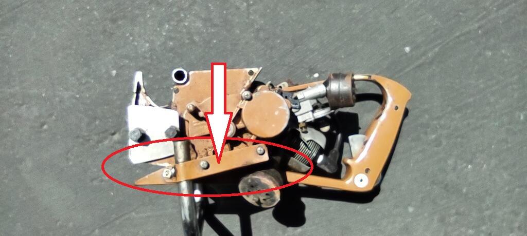

Fishnuts2 22 #12 Posted August 19, 2022 That looks like a homemade fix for the missing clutch cover. Fortunately, that's an easy part to find. Share this post Link to post Share on other sites
Wallfish 718 #13 Posted August 19, 2022 7 hours ago, Fishnuts2 said: That looks like a homemade fix for the missing clutch cover. Fortunately, that's an easy part to find. That was my first thought as well but then in this pic it looks more professional. Not that someone couldn't make that but then there isn't any other paint color obvious under that color at the scrapes and missing paint. Someone could paint it too but I'd guess if someone was to go through all that trouble of completely striping the paint and building a part it would be easier to just find a correct part and make it a complete restore job. I'm guessing it could be another branded Mustang with little change to the cover Share this post Link to post Share on other sites
Fishnuts2 22 #14 Posted August 21, 2022 On 8/19/2022 at 3:29 PM, Wallfish said: That was my first thought as well but then in this pic it looks more professional. Not that someone couldn't make that but then there isn't any other paint color obvious under that color at the scrapes and missing paint. Someone could paint it too but I'd guess if someone was to go through all that trouble of completely striping the paint and building a part it would be easier to just find a correct part and make it a complete restore job. I'm guessing it could be another branded Mustang with little change to the cover Yup, I think you're correct on that. I didn't study all the photos, just the one from the side which looked simply like a strap had been fashioned to fasten the front handle. I noticed now that it even has the starting instruction decal applied on the top too. There seems to be a large number of variations for us to collect! Share this post Link to post Share on other sites
