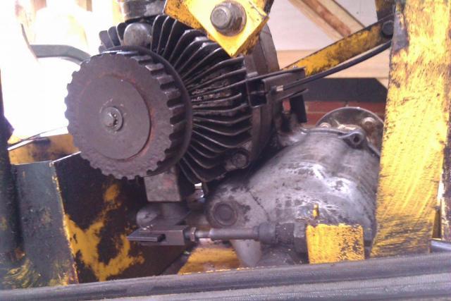

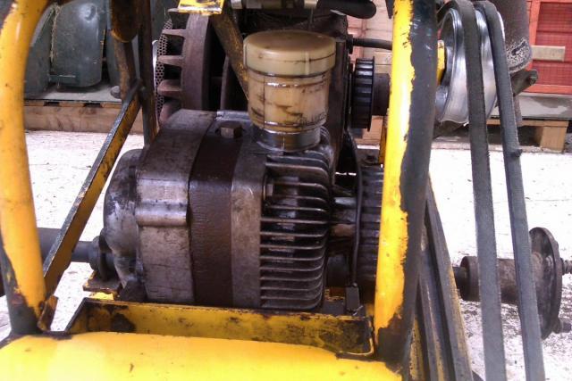

snowy the grey AKA Chris 6 #3 Posted June 12, 2014 Sorry for delay but here are 2 pics which may help. I have had the unit off the mower and there is no ID as far as I can see.Nearest I can find is on e-bay a Craftsman fan but it is not the right blade pitch. Fan fits on the end of the toothed pulley wheel in first pic and top of belt which goes round the pulley moves right to left. If that makes any sence! Any help appreciated. 1 mrtimrose reacted to this Share this post Link to post Share on other sites
Wristpin 400 #4 Posted June 22, 2014 (edited) I think that it may be an Eaton hydro. Been used on a lot of garden and ground scare machinery of that era including a Dennis Premier cylinder mower that we used to look after. Unfortunately I left all my hydro stuff behind at my old business but try Googling Eaton .com. Edit. This may be a better link, even shows a fan but make sure that it's the right rotation. http://htluk.co.uk/Products/light_duty_hydrostatic_transmissions/700-040 Or this http://www.truturf.com/pdf/old_manuals/5.pdf Edited June 22, 2014 by Wristpin 1 snowy the grey AKA Chris reacted to this Share this post Link to post Share on other sites

Anglo Traction 1,017 #6 Posted June 27, 2014 Just a point to add what Wristpin says above, Eaton do not provide the Cooling Fan for their units or the Pulley requirements. These are left to the Customer due to varying applications. So Wolseley would have sourced or made parts to fit their needs and applied their own part numbers to them. If, as you described, that the Belt travels from top right of Pulley to the left in your first Image, then you have a CCW ROTATION requirement of the Fan to pass air over the unit (possibly a Model 6 unit). The diameter of the fan should only need to be the same diameter as the Unit. You'll probably have to guess the amount of Blade pitch and number of them to provide the required cooling, when looking for a suitable Fan to modify and fit. Just need to ensure it is fitted concentrically and balanced on the pulley. I'm sure you'll find a solution. Share this post Link to post Share on other sites
snowy the grey AKA Chris 6 #7 Posted June 27, 2014 Having just looked through the info I have just concluded that it is back to the drawing board to make a new fan. Will update when I have something that seems to work. Thanks again all who have commented and assisted. Share this post Link to post Share on other sites
Ian 2,417 #8 Posted June 27, 2014 Years ago I replaced a missing cooling fan on an Eaton 1100 trans (in a Wheel Horse) with one the same size from a small household fan. It worked a treat Just a thought.. Share this post Link to post Share on other sites
Wristpin 400 #9 Posted June 27, 2014 The illustration on page 4 of this link would suggest that all the identification information including the rotation is stamped into the flat area above the shaft. http://www.truturf.com/pdf/old_manuals/5.pdf Share this post Link to post Share on other sites

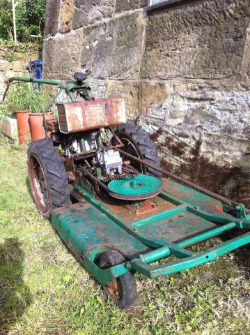

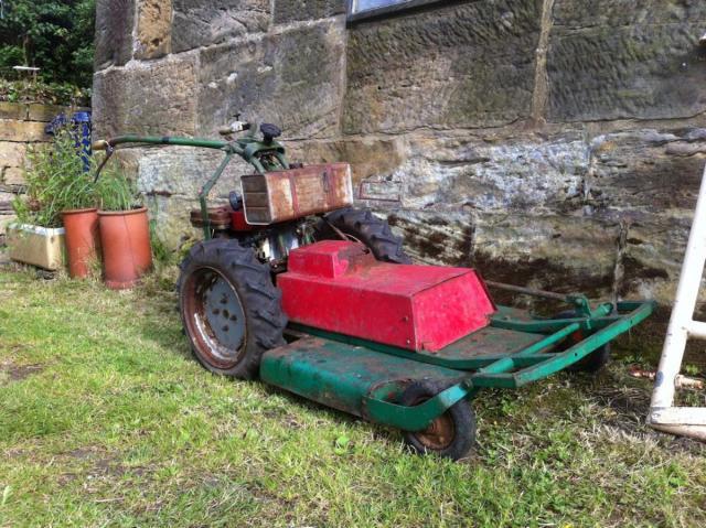

kevin 1 #10 Posted June 28, 2014 Hello, sorry to barge in , but I saw the post about a Wolseley Clearway, would any one be able to tell me if this is older Wolseley Clearway without the Hydrostatic drive? I bought this machine about 25 years ago and it had, had a hard life before I bought it. After many good years of service the differential packed up and in the process of my friend re engineering the parts it got thrown out! Does any one know who made the diff and is there one lying around somewhere? For the past 10 years it was left out in the elements under a hedge until last week when I decided to bring it back to life, the engine and pulleys etc all worked with the minimal of fuss. Without the drive it must be the heaviest push mower in existence, that said I did push it into a very wild overgrown piece of garden and it cut down 4 foot tall undergrowth with ease the date on the engine is 1970 I think. All help gratefully received. 1 mrtimrose reacted to this Share this post Link to post Share on other sites
Wristpin 400 #11 Posted June 28, 2014 (edited) I've got a parts list for a Wolseley 27" Self-Propelled Grasscutter, standard and professional models. (no mention of Clearway) which visually matches the images that you've posted.The parts list just says WR189 for the diff assembly with no other information but it looks as though it was possibly either a Foote or a Peerless part. Foote disappeared entirely many years ago and Peerless became part of Tecumseh who ceased to make engines and transmissions some years ago. The manufacture of some of their range of transmissions was taken over by Husqvarna but I believe this was confined to transaxles for ride-on mowers. Edited June 29, 2014 by Wristpin Share this post Link to post Share on other sites
Dibnah 19 #12 Posted June 29, 2014 (edited) The part you require is a 12 blade fan anticlock wise rotation Pt no SHF 3793/01 made by Smiths- Axle is Peerless. Edited June 29, 2014 by Dibnah 1 snowy the grey AKA Chris reacted to this Share this post Link to post Share on other sites

Jagger 1 #17 Posted September 28, 2014 Just come across your post. If you have not solved the problem then the fan from an old mini fits perfectly. You have to cut down the blades by about 25mm to make it fit but it works well. I bought two off ebay. 1 Ian reacted to this Share this post Link to post Share on other sites
