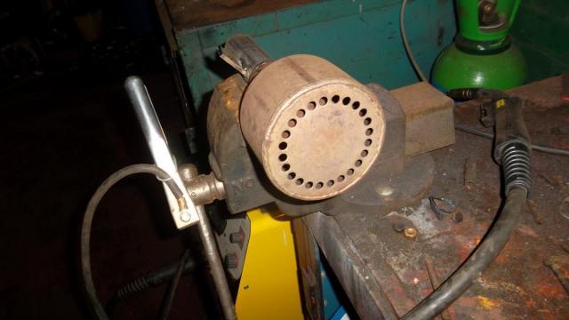

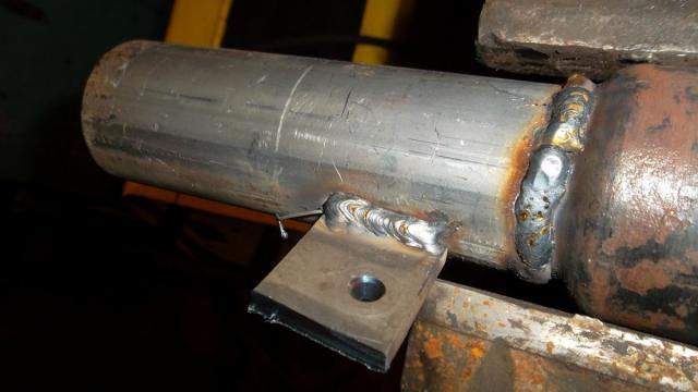

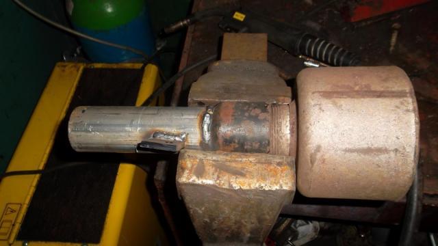

nathanwhittaker 50 #132 Posted October 14, 2014 Good evening all. I've had a quick hour on the crawler trying too make a exhaust. My Lister decided too lend me its exhaust what I believe is near the original it should have on. The next stage is too cut the end of and fill with wadding to dampen the sound and weld back up. I'm going to have too tap the head for the Exhaust manifold due too the lack of threads so that's why I've added on the extra bracket. Share this post Link to post Share on other sites
nathanwhittaker 50 #133 Posted October 14, 2014 the exhaust is actually a little shorter now tho Share this post Link to post Share on other sites

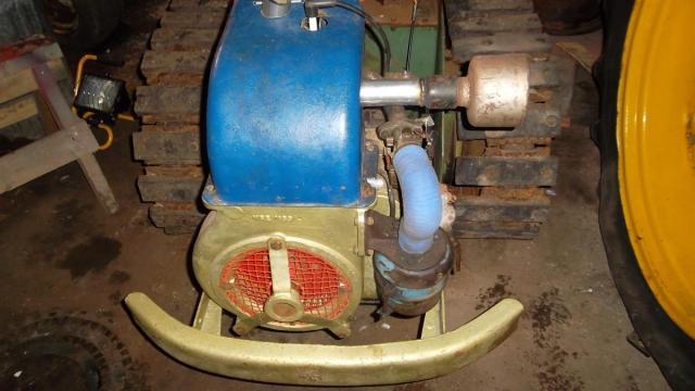

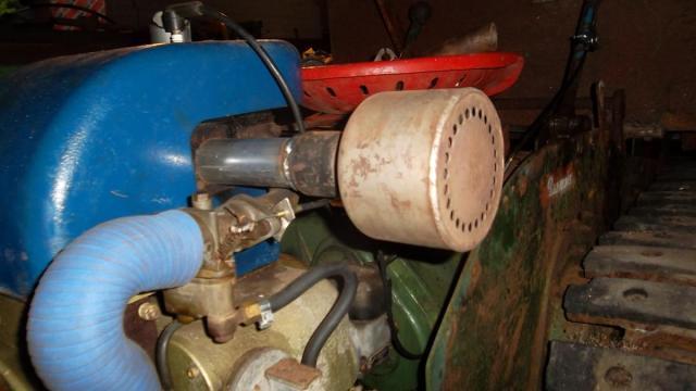

Stormin 4,458 #134 Posted October 14, 2014 the exhaust is actually a little shorter now tho Just as well. Sticking out like that it could catch on a forklift. 1 nathanwhittaker reacted to this Share this post Link to post Share on other sites
nathanwhittaker 50 #135 Posted October 14, 2014 Haha that's true norm Share this post Link to post Share on other sites
expeatfarmer 591 #136 Posted October 14, 2014 Hi Nathan The standard silencer is about 7" dia. and about 4" deep but looks very similar to the one you have made, no wadding in it though. Share this post Link to post Share on other sites
nathanwhittaker 50 #137 Posted October 14, 2014 Not yet buddy how would u put wadding in it do you just pack it full and the exhaust gasses go thru it ? Share this post Link to post Share on other sites
Rocboni 257 #138 Posted October 15, 2014 yes, you just pack it in, its just heat resistant fabric and absorbs the noise as the gasses go through. Share this post Link to post Share on other sites
nathanwhittaker 50 #139 Posted October 15, 2014 I can get it locally but they say it's a foam block they have now will that be ok Share this post Link to post Share on other sites
Rocboni 257 #140 Posted October 15, 2014 never heard of foam, if it does the same thing i can't see it being a problem. Share this post Link to post Share on other sites
nathanwhittaker 50 #141 Posted October 15, 2014 I will pick some up and give it a try Share this post Link to post Share on other sites
