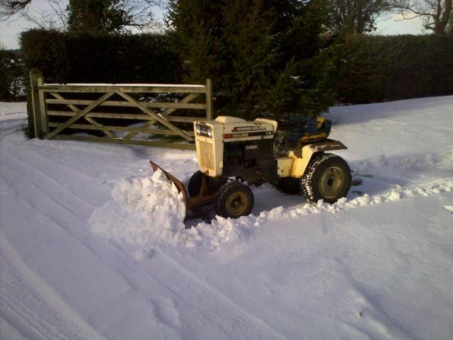

slf-uk 914 #12 Posted September 25, 2014 Agreed, pushing snow is one of the most fun things to do on a tractor. I think I may have already posted this picture already somewhere, but it is one of my favourites I broke a weld on mine a while back pushing soil. I must fix that before the winter. If we get a bit of snow it would be good if everyone posted some snow pushing pictures or videos. Iain 3 Dibnah, Triumph66 and Ian reacted to this Share this post Link to post Share on other sites

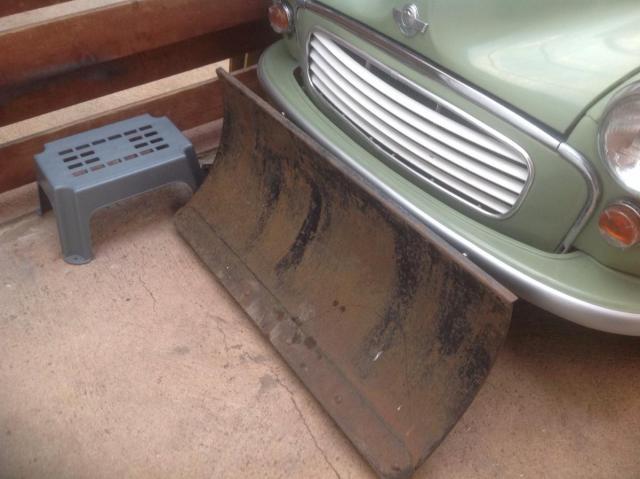

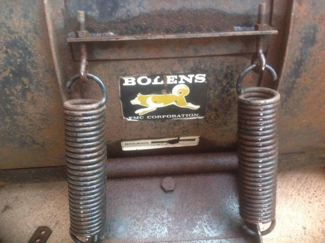

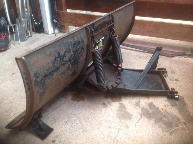

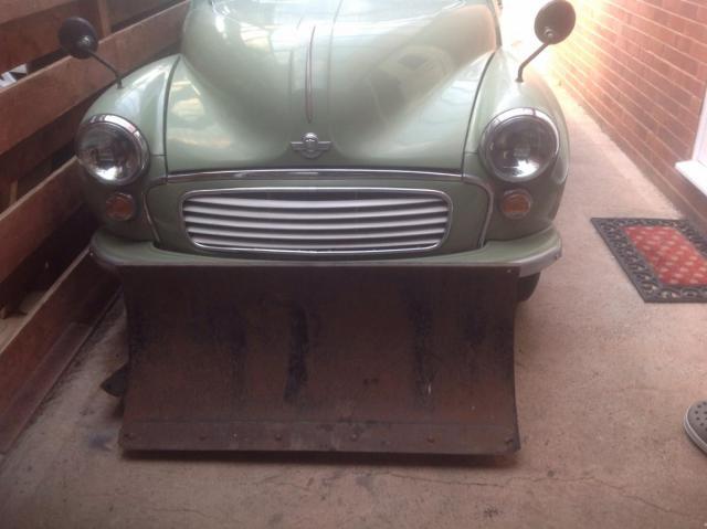

Triumph66 1,256 #16 Posted October 6, 2014 Here's a photo of my snow plough which arrived today. All I need is snow....... 1 Ian reacted to this Share this post Link to post Share on other sites
slf-uk 914 #17 Posted October 6, 2014 Andrew, I think it would look better attached to the Bolens rather than the Morris :-) Looking in great condition Iain Share this post Link to post Share on other sites
Stormin 4,458 #18 Posted October 6, 2014 Your right Iain. Bit narrow for the Moggie. Share this post Link to post Share on other sites
Robins 55 #19 Posted October 6, 2014 Looks good Andrew Fits nice on the Morris Any news on the Bolens 800 yet? Share this post Link to post Share on other sites
Triumph66 1,256 #20 Posted October 6, 2014 Cheers chaps. I thought the plough gave my van a meaner street cred look,,,,,,,, Daniel, the long awaited arrival of the Bolens 800 will now be here NEXT week............ Share this post Link to post Share on other sites
slf-uk 914 #21 Posted October 6, 2014 Andrew, Your plough is interesting as the ends have a 45 degree edge. As it is painted black it will be a later plough. Mine is painted yellow and does not have the 45. You might want to consider painting it yellow to fit with the age of the 800 and 1254. Alternatively, just wait until you buy the next Bolens and it might be a later model. Iain 1 Triumph66 reacted to this Share this post Link to post Share on other sites

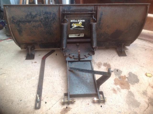

Triumph66 1,256 #24 Posted October 10, 2014 I gave the plough a good pressure washed this afternoon to remove any grime etc. I also applied some WD40 on the moving parts. I am going to buy a Bolens snow plough manual so I know how to attach it properly. Also I need to fabricate a rod which hopefully Iain will give me some measurements to work off. Share this post Link to post Share on other sites
slf-uk 914 #25 Posted October 10, 2014 Andrew, The good news is that you have everything you need to fit to the tractor and the fitting will fall in place once you have your 800 that has the lift mechanism. To save the purchase of a manual and give you the smile factor sooner I have marked up one of your pictures. I will attempt to describe what goes where 1 - A and B - fit to the attachment points on the bottom of the front axle 2 - The end of the lift bar marked E goes onto point C on the plough 3 - D fits on the top point of the lift mechanism 4 - Have fun Longer term I would suggest cutting down the bolt that you have at A and B, then drill and fit R clips. With bolts this long it is likely it will be a pig to fit and interfere with the steering. Iain Share this post Link to post Share on other sites
