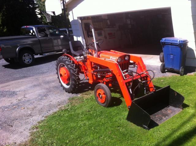

squonk 71 #1 Posted September 27, 2014 Finally got a good pic to post of my Economy Power King 2414. THe loader was home built. The uprights and arms were copied from the PK drawings and the bucket is a scoop hybrid. Exhaust stack was made from a Gravely muffler and electrical conduit. 3 Ian, Triumph66 and Stormin reacted to this Share this post Link to post Share on other sites

squonk 71 #4 Posted September 27, 2014 Built by Engineered Products Waukesha Wisconsin. They began in 1946.14 HP K321 Kohler single. Single 3 spd Crosley transmission all gear drive. These also came with dual trannies. Dana rear axle with a final drive ratio of 12.25:1 Also has hyd 3 pt. rear hitch. 24" rear wheels, they are actually Farmall Cub rear wheels and 12" fronts. Offset Ross steering gear. Rear weights are off a Farmall A and the fronts off of Cub Cadet. Share this post Link to post Share on other sites

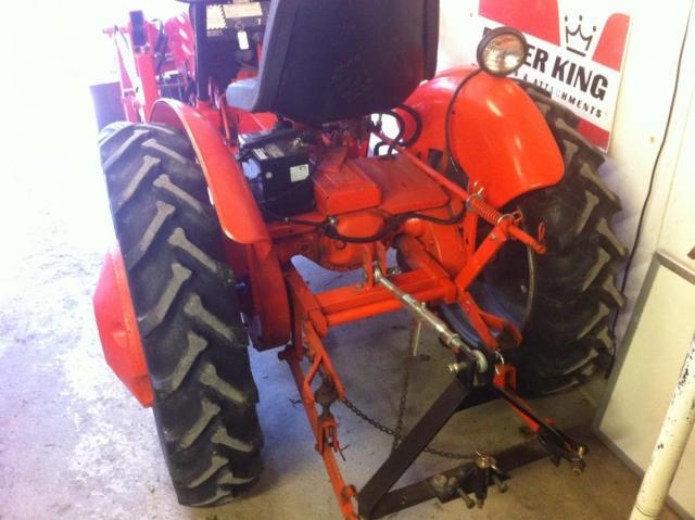

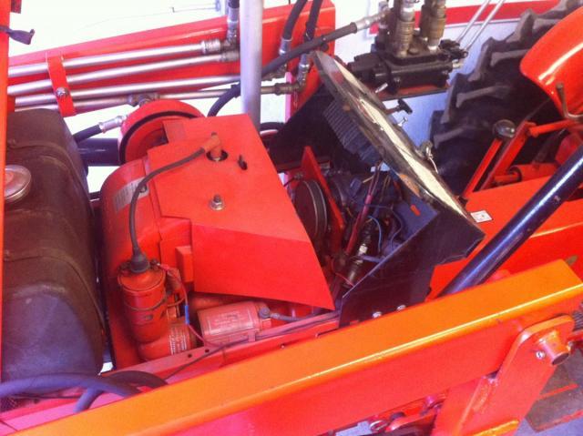

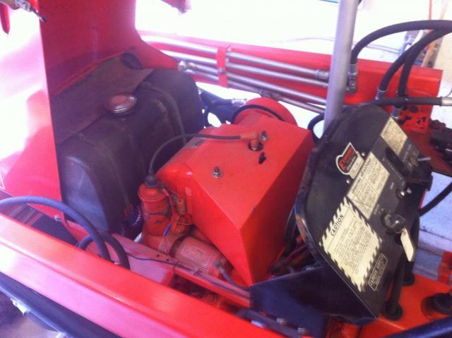

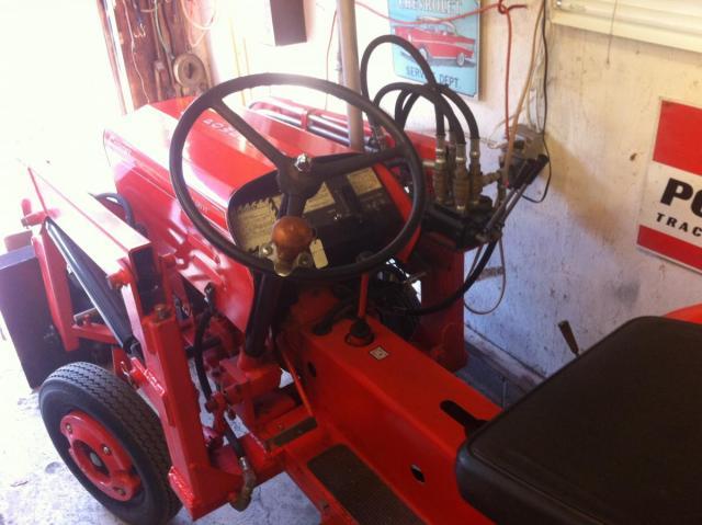

squonk 71 #9 Posted September 28, 2014 A few more pics. The loader was built in a small one bay shop much like the shack that belongs to a friend of mine. He's a retired fabricator and races go-karts. I did the layouts and he did the welding. I did all the plumbing ect. What I really like about the PK is I can stand up on it and stretch out when I'm on it for a while. I mainly use it for snow removal Share this post Link to post Share on other sites
