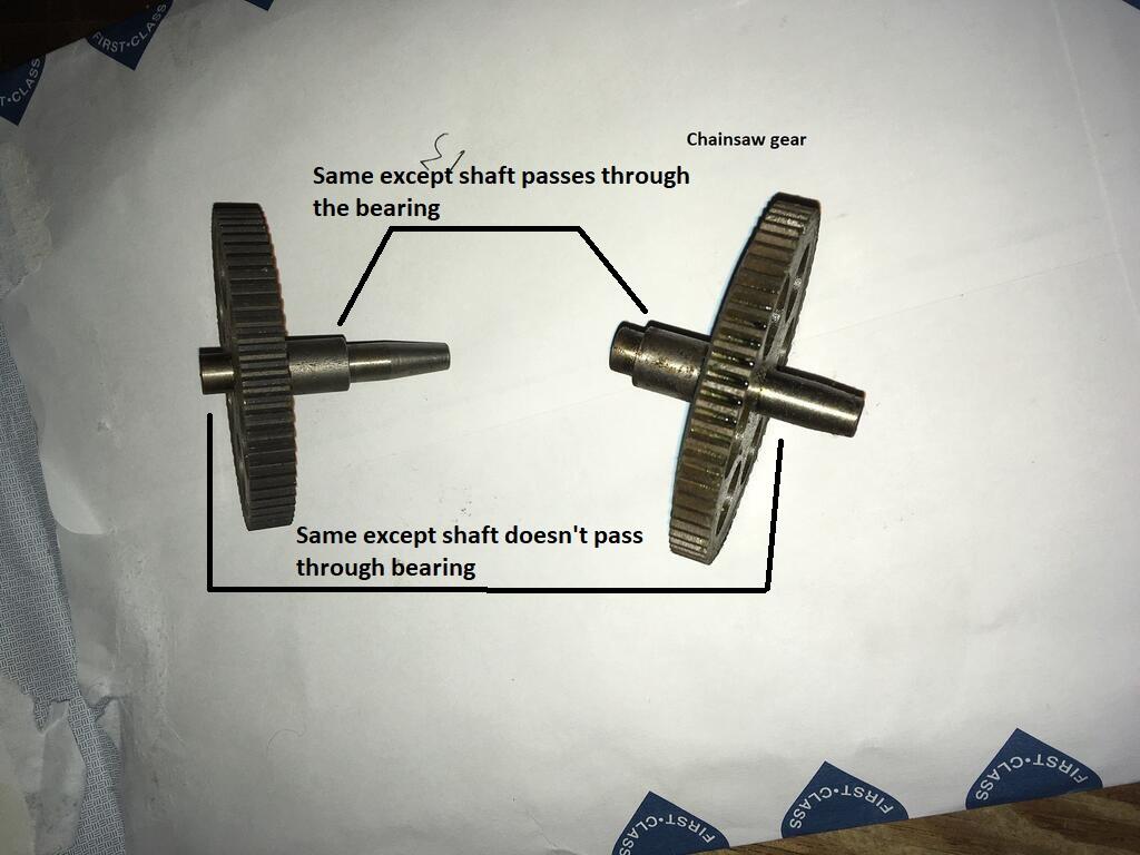

CNew 408 #40 Posted March 19, 2021 On 11/16/2019 at 8:02 AM, factory said: According to the 1971 Series 13A price list (special types), engine Type 216 has a 1700 R.P.M. single reduction gearbox with centrifugal clutch. It looks very similar to the Type 195 (H-III) but with the fuel/gas tank fitted on the opposite side to normal (i.e. below the carb), the Type 216 uses fuel/gas tank part number #A-32-30 with bracket #97-12. David What other tools might have used this type of gearbox? Share this post Link to post Share on other sites
factory 487 #41 Posted March 20, 2021 Will have a look through the information I have, another one to look for is the 13B Type 295. David Share this post Link to post Share on other sites
factory 487 #42 Posted March 20, 2021 The Orline Hedge trimmers have a reduction gearbox with the same gears (66 tooth & 18 tooth), if your looking for engine types that may have been removed from these on ePay, search for types 13A183, 13A208, 13A224 and 13B259. David Share this post Link to post Share on other sites
CNew 408 #43 Posted March 20, 2021 Thanks David! I thought I had a used gearbox like this but turns out I don’t. I have an engine I think I can use but need to figure out what to do for a gearbox. Share this post Link to post Share on other sites
factory 487 #44 Posted March 20, 2021 Was your used gearbox from a chainsaw by any chance? those are the same reduction but the PTO is on the wrong side for the compressor. David Share this post Link to post Share on other sites
CNew 408 #45 Posted March 20, 2021 Exactly. I had forgotten the PTO was flipped. At first I thought the compressors just had direct drive until I looked a little closer, I wasn’t expecting it to use a gear box. Share this post Link to post Share on other sites
Wallfish 718 #46 Posted March 24, 2021 On 3/20/2021 at 6:09 PM, CNew said: the PTO was flipped Think this should solve your problem How about flipping it? Found this NOS gear sitting in the parts stash The shaft will be lower rather than up higher but it should work if you want to try flipping the PTO in your chainsaw case. I've never tried it but always wanted too. Share this post Link to post Share on other sites
CNew 408 #47 Posted March 24, 2021 Interesting idea - thanks! Would you just have to drill out the opposite side of the cover plate for the shaft to go through? Not sure how you would reorient the little bearings that ride on the short section of the shaft(I’m trying to think by memory) but I’ll have to take a closer look at this tonight. I’m intrigued though... Share this post Link to post Share on other sites
Wallfish 718 #48 Posted March 24, 2021 There's a welch plug in the closed end. remove and reuse it for the other side to close the end and the bearings should all be the same. No need to change them. Plug and play except for moving the welch plug from one side to the other for the closed end. It may be easier said than done for that plug as I have never removed one. YET The NOS gear on the left in the pic will be flipped 180 so the shaft goes out through the end of your box which has the plug in it now. I'm about 99% sure it will work. Share this post Link to post Share on other sites
Wallfish 718 #49 Posted March 24, 2021 Just went and had a better look. That doesn't seem to be a plug to close the end so it will need to be drilled and then use something to seal the other end Share this post Link to post Share on other sites
CNew 408 #50 Posted March 24, 2021 This is genius, I think it is worth a try! Share this post Link to post Share on other sites
