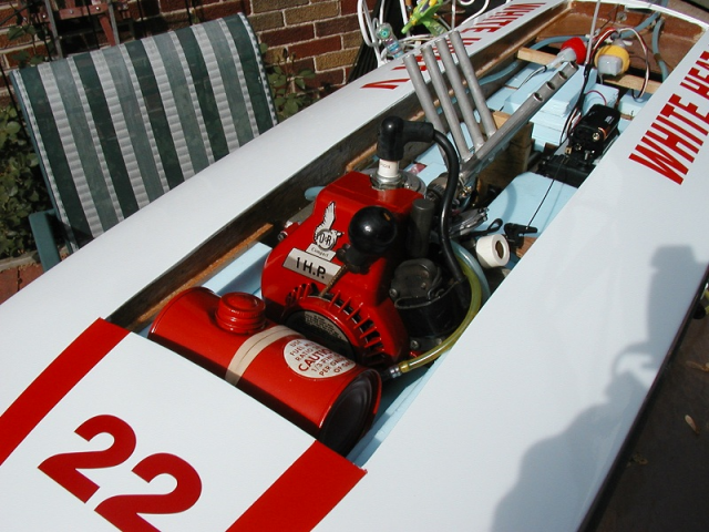

Wallfish 718 #1 Posted November 18, 2014 Courtesy of Webhead 4 hollywood2979, amcrules00, pmackellow and 1 other reacted to this Share this post Link to post Share on other sites

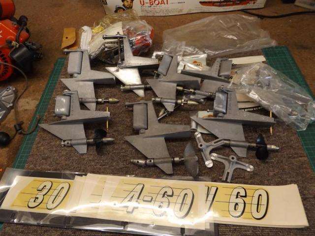

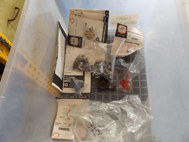

Daren89 18 #2 Posted April 7, 2015 Hi I have been collecting parts to build a white heat for a while, I first saw a WH60 as a school kid in a book at the library So about 15 years ago I started searching ebay for parts and the plans, I have WH V / X / 30 / 60 plans and a WH30 built also 4/60 kit and I'm looking for other White Heat owners so we can share info 2 pmackellow and hollywood2979 reacted to this Share this post Link to post Share on other sites

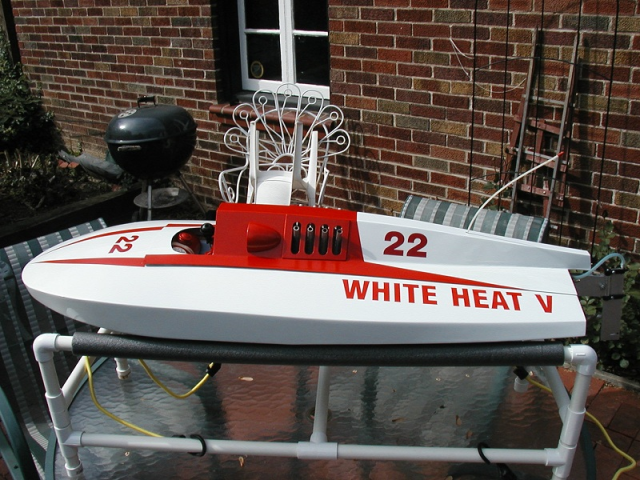

Webhead 95 #5 Posted April 10, 2015 Yeah, I think that idiot tried to sell that boat a few times, and received bad feedback from all of them! That's my boat at the top. It was professionally built in the late 1990's by a cabinet maker, he used marine grade mahogany and had a body shop do the paint work. Share this post Link to post Share on other sites

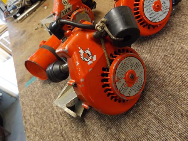

Ghosty 3 #15 Posted June 2, 2017 Hi All, I have just found this site., I helped my dad build one of these in the mid 70's from plans out of Popular Mechanics, and I have a complete copy of the article. I have just acquired a 3/4 hp engine to power it, After a lot of cleaning out of the carby it is a good runner, still need to do some fine tuning of the carby. The only info I don't have is the prop size, any info on this would be helpful. If any one is interested I will post the rest of the article. Share this post Link to post Share on other sites
Webhead 95 #16 Posted June 2, 2017 Did you install a new diaphragm? If not, it will definitely need one for the best performance. As for props, it's almost a nightmare to find the optimum one without trying multiple pitches. I was lucky enough to hook up with a rc boat club and a knowledgeable guy with a box of props helped me figure it out. We ended up with a 3 blade, beryllium Octura prop, not sure of the number. How about a photo of the boat? Share this post Link to post Share on other sites
Ghosty 3 #17 Posted June 2, 2017 1 minute ago, Webhead said: Did you install a new diaphragm? If not, it will definitely need one for the best performance. As for props, it's almost a nightmare to find the optimum one without trying multiple pitches. I was lucky enough to hook up with a rc boat club and a knowledgeable guy with a box of props helped me figure it out. We ended up with a 3 blade, beryllium Octura prop, not sure of the number. How about a photo of the boat? I will be replacing the carby with another, not shore from what yet, Looking at quite a few from OS, Super Tiger and OPS. I will make up an adaptor to fit the new carby to the OEM housing. I run and race boats with RCMK K30's, I was just after a base number for the prop to start with. I don't have any photos of the original boat that we built as they were old school photos that were either lost or tossed out on the many moves since. Cheers Andrew Share this post Link to post Share on other sites
factory 487 #18 Posted June 2, 2017 That looks a nice clean engine, it probably hasn't had much or any use, which may explain why it's running with the original diaphragm. They tend to harden & crack after being exposed to fuel, it's rare to find an original that is OK. Those earlier style carbs are quite hard to find, I have a few O&R engines that may have had RC use in the past, often the governor vane is missing and the carb permanently modified for the RC servo. Google has scanned the entire archive of the US Popular Mechanics magazine. The article for building the White Heat V hydroplane by Tom Perzentka (of Octura Models) is in the June 1962 edition, available for free on google books here; https://books.google.co.uk/books?id=mtwDAAAAMBAJ&pg=PA124#v=onepage&q&f=false It's on pages 124 to 130, pages 186 to 188 and page 190. Seems that your scans slightly are different, is it from the Australian edition? David Share this post Link to post Share on other sites
Ghosty 3 #19 Posted June 2, 2017 (edited) David, My copy is out of the Popular Mechanics Do It Yourself Encyclopedia set, Volume 8 published in 1968, That could be the difference. The diaphragm is in very good condition, may not had much running, After looking around here a lot, I have noticed that the clear on-way valve is missing from mine, this could be causing the problems that I am having. When I change the carby over I will machine up an adaptor piece, so I can always convert it back. Cheers Andrew Edited June 2, 2017 by Ghosty Share this post Link to post Share on other sites

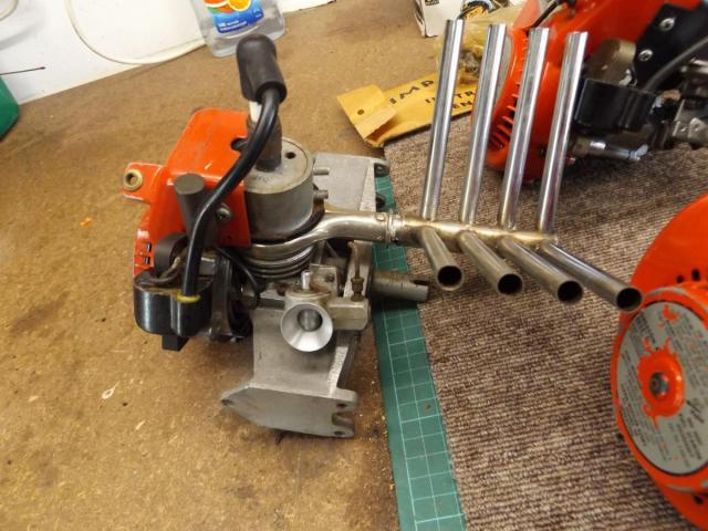

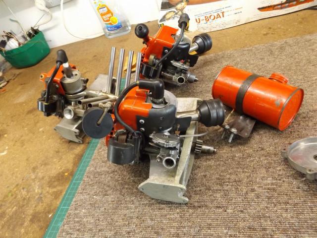

Ghosty 3 #23 Posted June 20, 2017 (edited) Hi All, Does anyone know where I could buy one of the Octura boat engine mounts or anyone who is willing to sell one. Or can someone can supply me detailed photos of a mount with some basic dimensions so as I can machine one. Thank you for your help. Cheers Andrew Edited June 20, 2017 by Ghosty Named the mount Share this post Link to post Share on other sites

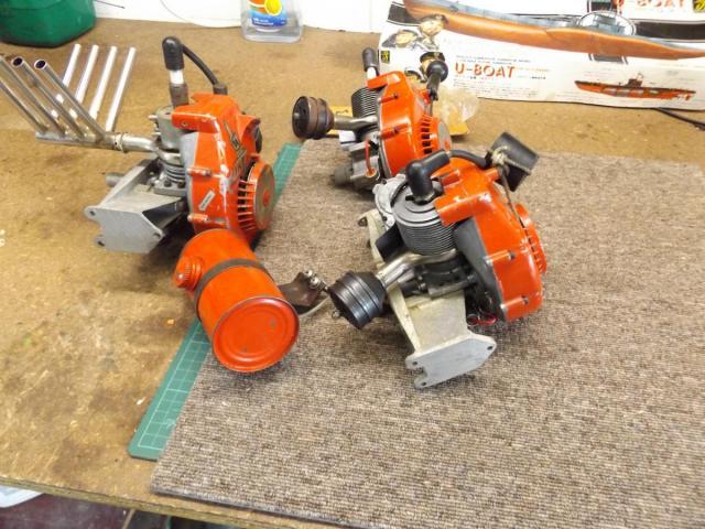

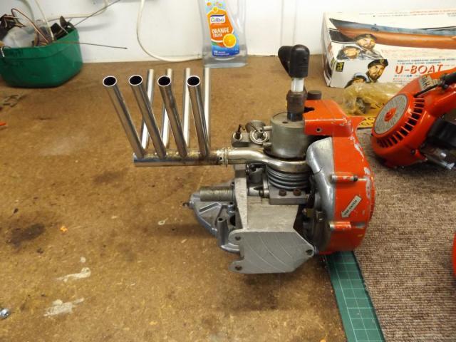

factory 487 #24 Posted June 20, 2017 I can probably get some measurements and some pictures of the Octura mount I have, if no one has one for sale. They seems to be two versions of the Octura mount, mine is the standard cast alloy version, but I have also seen a version made from a section of extruded & machined aluminium. Here are a couple of pictures of one (not mine); David 1 Ghosty reacted to this Share this post Link to post Share on other sites
Ghosty 3 #25 Posted June 20, 2017 1 hour ago, factory said: I can probably get some measurements and some pictures of the Octura mount I have, if no one has one for sale. They seems to be two versions of the Octura mount, mine is the standard cast alloy version, but I have also seen a version made from a section of extruded & machined aluminium. Here are a couple of pictures of one (not mine); David David, Thank you for the photos, that one looks like a piece of extruded alloy, the other one that I have seen is a cast one. Looks like I will just machine one out of a block alloy. Photo is just one engine I have built over the years. Share this post Link to post Share on other sites
