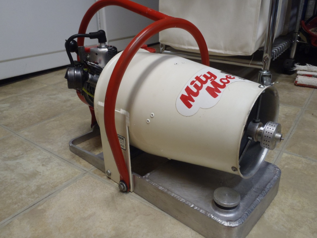

Mitymoehelp 5 #3 Posted February 23, 2020 I aquired one, I found it in my friends dead neighbors barn I was wondering if you could help me find a new carb diaphragm or if I can make one and how to do it or any info would be a great help thank you Share this post Link to post Share on other sites

CNew 408 #7 Posted February 23, 2020 8 hours ago, Mitymoehelp said: I aquired one, I found it in my friends dead neighbors barn I was wondering if you could help me find a new carb diaphragm or if I can make one and how to do it or any info would be a great help thank you Welcome to the forum! You have us drooling over the fogger, that is a really neat tool. PM me and I can also help you with a diaphragm if someone else hasn’t already got you fixed up. please add some photos of your Mity Moe. Share this post Link to post Share on other sites
Wallfish 718 #8 Posted February 23, 2020 Nice find, Those Mighty Moe sprayers are neat little items. Share this post Link to post Share on other sites
Mitymoehelp 5 #9 Posted February 23, 2020 I’ll add some pictures in a little bit, I don’t have any pictures of when it was together sadly but I do have some of when it is all torn apart and I do have access to a laser cutter is there a way I can purchase carb diaphragm material and then cut it out myself Share this post Link to post Share on other sites

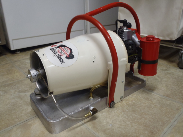

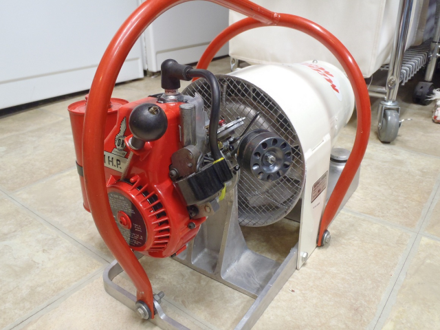

Wallfish 718 #12 Posted February 23, 2020 Thanks for adding some pics. Unfortunately that's about the condition many of these tools are found in but they clean up nice if you spend the time. Looks like you're well on your way. Share this post Link to post Share on other sites
