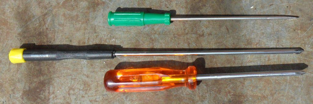

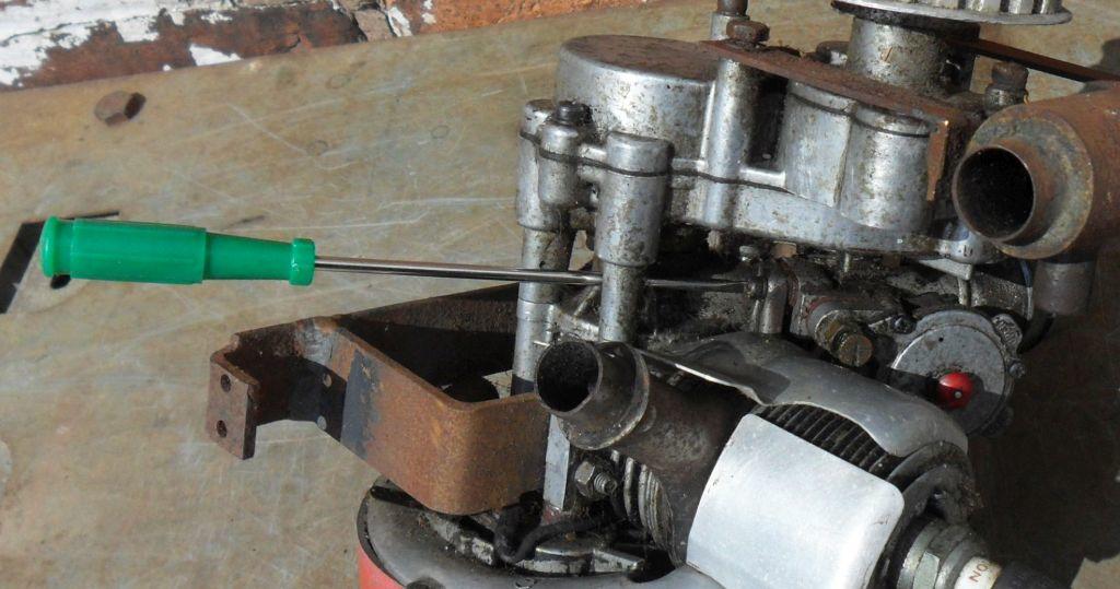

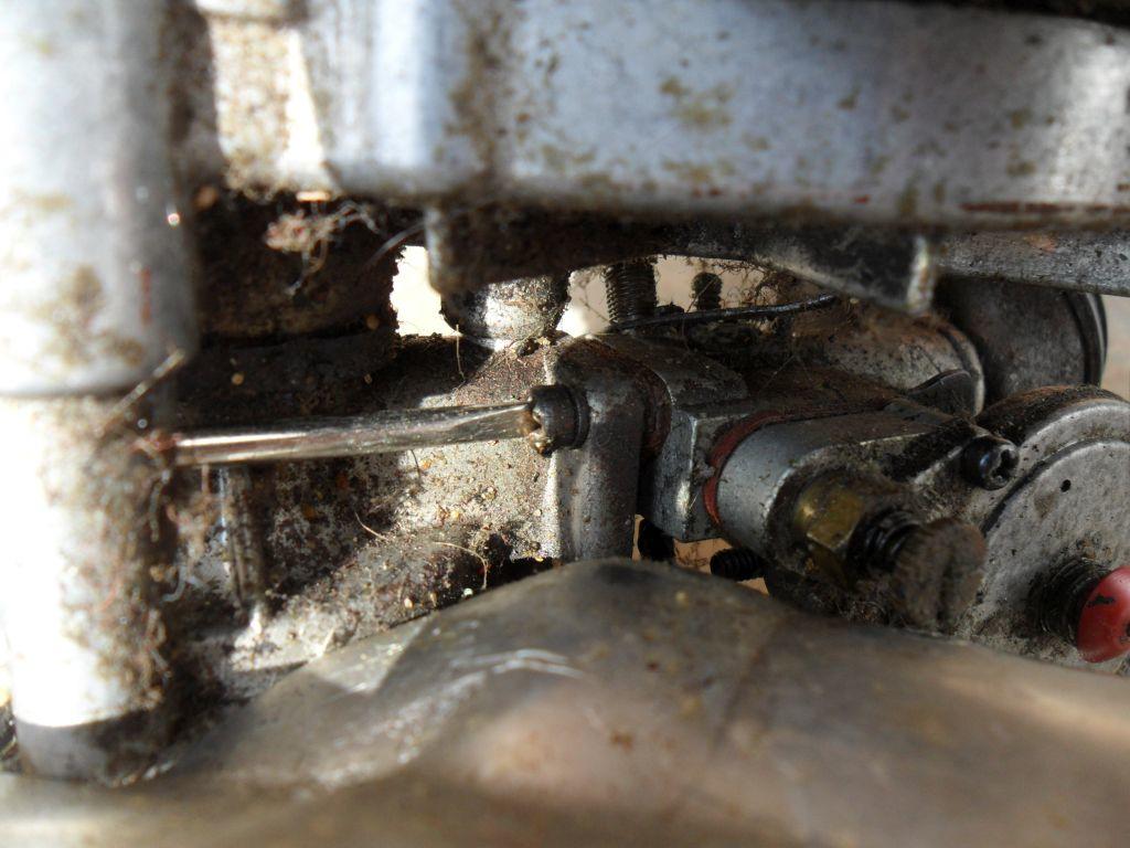

WOWaLotOfBees 0 #43 Posted July 12, 2018 I have one of the older models of drill that uses this carburetor. Could someone please tell me how to take the difficult to reach screw off? Is there a trick to it? Share this post Link to post Share on other sites
factory 487 #44 Posted July 14, 2018 Here is what the manual suggests for getting the lower Carb screw out; This is what I have been using if I need to get the carb screw out without removing the adaptor plate or gearbox (but I usually do a complete engine rebuild instead and remove the adaptor plate or gearbox first). The first two pictures below shows a small flat blade screwdriver (being misused) that fits between the adaptor plate or gearbox mountings, you may need to remove the cylinder plate to gain access. And the last picture shows some other Phillips screwdrivers together with the flat blade one, to use these they would need grinding down to fit between the mountings, I don't want to do this to the orange Wera one but the cheapo one may get modified vandalised. Hope this helps. David Share this post Link to post Share on other sites
