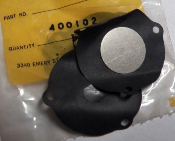

factory 487 #51 Posted July 14, 2019 (edited) On 2/16/2015 at 2:10 AM, tackdriver56 said: Webhead: diaphragm received and metal disc transplanted with Seal-All adhesive. Curing overnight. Tomorrow will be the moment of truth... On 7/14/2019 at 1:15 PM, JUST O&R said: THE DIAPHRAGMS FOR MY OLDER ONE ARE HARD TO FIND I THINK THE # IS 400102. DO YOU KNOW WHERE I COULD FIND A FEW? I have found a service bulletin about the later carb diaphragm membrane assembly part no #400102, used to replace the separate diaphragm membrane (#95-2) & diaphragm disc (#148-1) that may be found in later 1HP engines (or 3/4HP & 0.85HP engines that were serviced at some point in their working lives). If you find one of these diaphragm membranes with the disc bonded to it, be sure to transfer the disc to the replacement diaphragm. David Edited July 26, 2019 by factory Added picture. Share this post Link to post Share on other sites

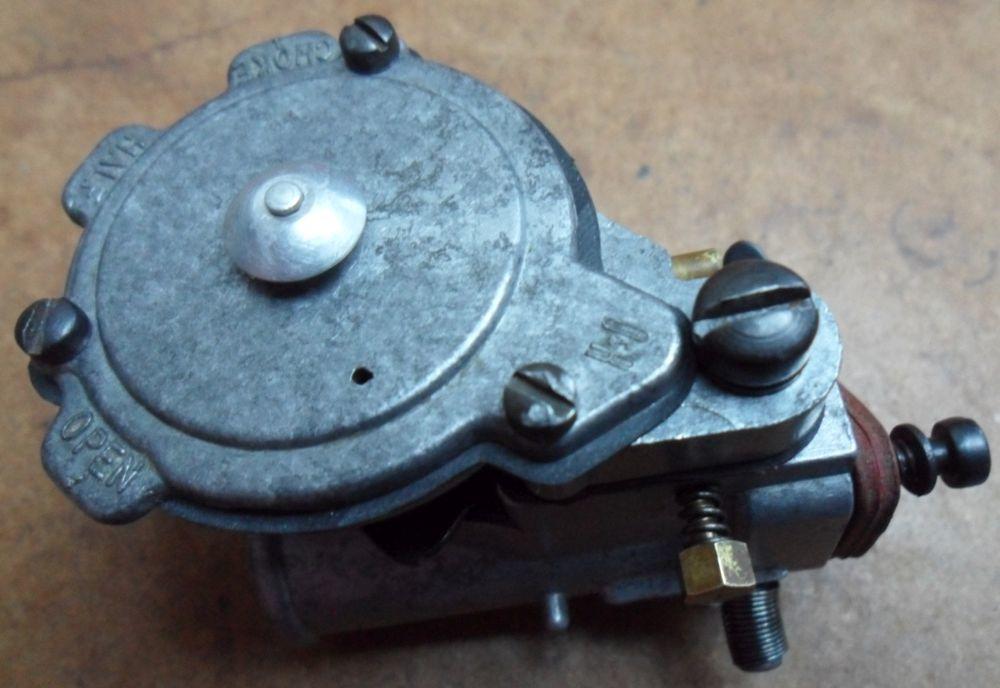

JUST O&R 237 #52 Posted July 27, 2019 I need help!!!! does someone have a breakdown of the early carburetors the needle valve assembly that I have is to long . Somewhere I must have misplaced it. And there is a hole on the side of it that I have never seen. Share this post Link to post Share on other sites

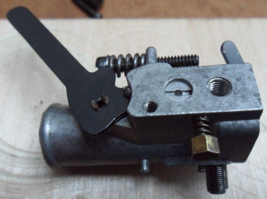

factory 487 #53 Posted July 27, 2019 That's an early carburettor as you already know, which would have originally had a side mounted needle valve, the diaphragm bowl has a screw in place of the later needle valve shown in your pictures. It's possible it got converted to the later style needle valve at some point in the past, in this case the hole in the side would have a small screw to blank it off, the later needle valve assembly should fit if you unscrew the needle part before fitting. Here are some pictures of a side needle valve carb I rebuilt sometime ago, if you need any more pictures let me know. All the parts (note: that rubber check valve in these goes bad the same as the diaphragm does). Lower half showing side needle valve. Complete early carb (note: the earliest ones didn't have the primer button, but a modification kit was produced for a very short time to add this). David P.S. I'm sure we can find you a side needle valve should you need one. Share this post Link to post Share on other sites

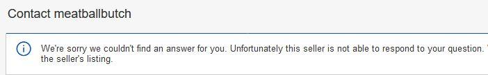

factory 487 #73 Posted October 11, 2019 On 10/2/2019 at 11:23 PM, Wallfish said: Joe added a link to the old forum in his ebay ads when we started. That was a major advertisement to drive people to it. Maybe contact the seller and ask? I'm just glad to see them being offered as I just don't have the time to do it Well I've tried to contact meatballbutch, but as usual ePay has blocked international messages as my address isn't in the US, why do they do this? You can't send helpful information to sellers either. David Share this post Link to post Share on other sites
JUST O&R 237 #74 Posted October 11, 2019 What is your question or comment I will ask him for you ? Share this post Link to post Share on other sites
factory 487 #75 Posted October 11, 2019 13 minutes ago, JUST O&R said: What is your question or comment I will ask him for you ? Just thought I would ask if they would like to add something to the description to help people find the forum, should they need any help with their O&R's, same as Joe (Webhead) did in the past. Note eBay doesn't like direct links any-more, they tend to automatically remove them. If you could ask for me that would be great, thank you. David Share this post Link to post Share on other sites
