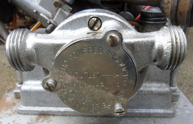

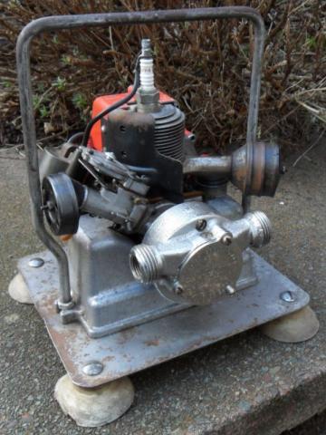

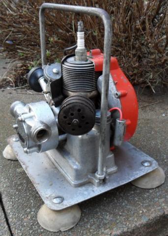

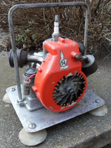

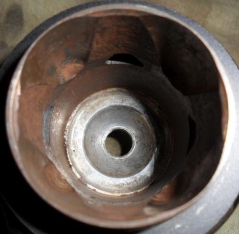

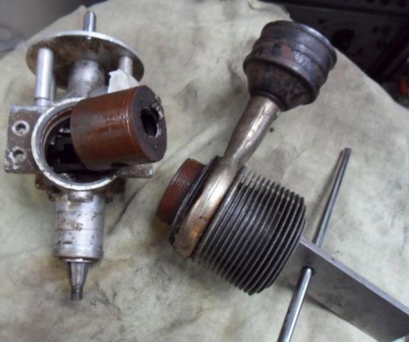

factory 487 #1 Posted December 20, 2014 (edited) This is the latest addition to my O&R collection, a Petro Powered Products Chug-A-Pump. The engine is an early compact I with the side mounted carb needle & screws in the back of the starter/blower cover. Unfortunately a previous owner disliked the starter mechanism so much that they cut it off completely. The engine was also seized & the flywheel nut threads were stripped, fortunately the crankshaft threads are OK. After removing the sparkplug I discovered someone had tried and failed to unseize it by hammering the piston with a rod, the piston has a hole in it. I left it overnight with some oil poured in the cylinder. Today I stripped it down further, I was surprized to find the flywheel key was steel, it does have a different part number to the later engines so may be original? The oil left in overnight did the job and I was able to turn the flywheel a bit, which enabled me to remove the cylinder without damaging the conrod. The cylinder is a bit rusty but hopefully it will clean up for reuse. The missing bits of the piston were shaken out of the crankcase. The gudgeon pin is also different to the later engines as it is solid, it is also smaller in diameter, I have a few spare pistons but they can't be used because of this. David Edited December 20, 2014 by factory 2 Ian and CNew reacted to this Share this post Link to post Share on other sites

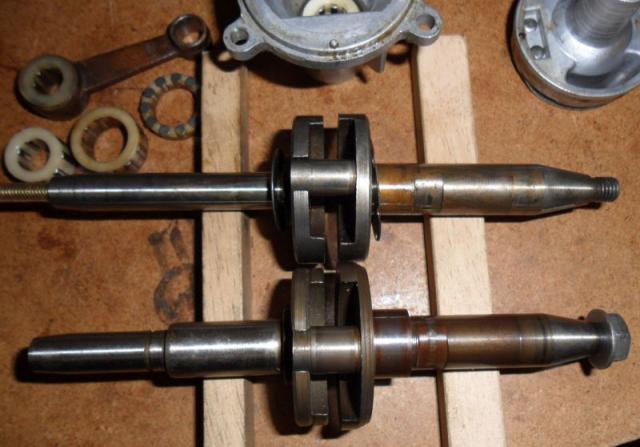

factory 487 #5 Posted December 23, 2014 Yes I made the tool for removing the cylinder, I have added a new thread about it here: http://myoldmachine.com/topic/1499-cylinder-removal-tool/ As for the engine I have come to the conclusion that it cannot be repaired without the correct piston, as both the conrod & crankshaft/backshaft are completely different to those from a later engine. This is due to the redesign they did to change all the bearings. The later one is at the bottom of the picture. David Share this post Link to post Share on other sites

factory 487 #7 Posted December 24, 2014 I haven't yet as I keep forgetting to measure the gudgeon/wrist pin. It's also going to need a set of early type starter dogs as well as a complete replacement blower/starter cover. David Share this post Link to post Share on other sites

factory 487 #10 Posted December 24, 2014 Finally got round to measuring the gudgeon/wrist pin, the size is 0.312" I guess O&R used a standard 5/16" rod the make these. The later one measures 0.317". The picture shows the damaged piston together with a later one. David Share this post Link to post Share on other sites
