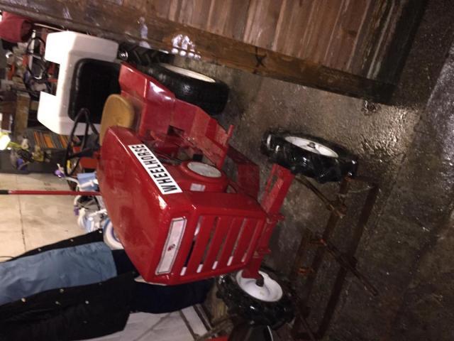

Jackthehat 14 #1 Posted January 14, 2015 Needs some bits and terrible stickers taken off but I'm happy with it the one behind is my friends 😀😀😀😀🎉🎉🎉🎉🎉 How to I upload a photo to show u Share this post Link to post Share on other sites
Jackthehat 14 #2 Posted January 14, 2015 5 nigel, OldBuzzard, neil and 2 others reacted to this Share this post Link to post Share on other sites
meadowfield 1,901 #3 Posted January 14, 2015 awesome what is it? - looks like a commando 800. Share this post Link to post Share on other sites
Jackthehat 14 #4 Posted January 14, 2015 I think it's is 1972 I've been told not a RJ buts a start first thing I wanna get is some chevron tyres for the back can't seem to find any sensebly priced at the mo Share this post Link to post Share on other sites

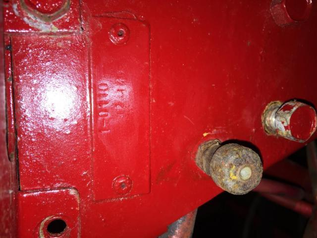

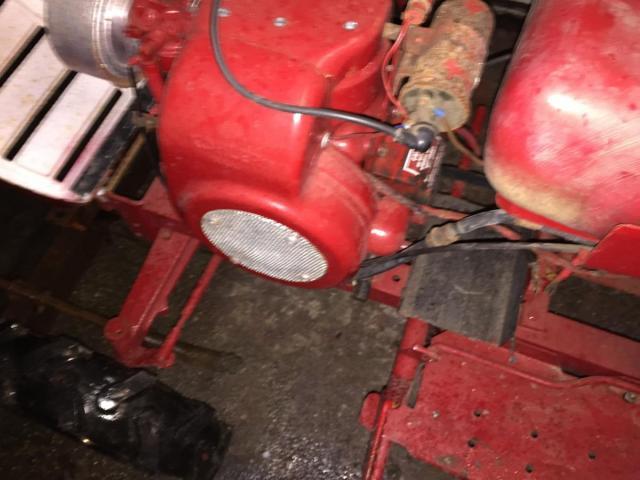

meadowfield 1,901 #5 Posted January 14, 2015 what engine, how many gears and is there a model number plate under/on the hoodstand. Guessing 1-0130.... Btw it's later than 1969 because of the hood and footplates, engine looks like an 8hp kohler - and I think I spy an old style battery tray Share this post Link to post Share on other sites
Jackthehat 14 #6 Posted January 14, 2015 Unsure on the gears as I have closed up the shed what year do you reckon mate I'm guessing 8hp too Share this post Link to post Share on other sites
meadowfield 1,901 #7 Posted January 14, 2015 1972 commando 800, 3 speed, 8 hp kohler Share this post Link to post Share on other sites
Jackthehat 14 #8 Posted January 14, 2015 I thought you said 1969 ? Mate an cool cheers Share this post Link to post Share on other sites
meadowfield 1,901 #9 Posted January 14, 2015 Ha, read the thread I said it looked like an 800, then by design it was definitely newer than 1969... Share this post Link to post Share on other sites

Jackthehat 14 #15 Posted January 15, 2015 Got it running tonight it runs lovely new plug some clean fuel sweet little engine just seems to struggle getting gears [emoji15] Sent from my iPhone using Tapatalk Share this post Link to post Share on other sites
the showman 4,074 #16 Posted January 16, 2015 First thing I would do is drain and refill the tranny, it might have water in it quite common on these. Have the engine at idle and make sure the belt stops when you press the clutch Share this post Link to post Share on other sites
Stormin 4,458 #17 Posted January 16, 2015 And just incase you don't know, don't try to change gear on the move. Share this post Link to post Share on other sites
Jackthehat 14 #18 Posted January 16, 2015 The belt doesn't stop when clutch is down an even when it does it grinds Share this post Link to post Share on other sites
Tom 215 #19 Posted January 17, 2015 Hi Jackthehat, Nice tractor you have there. Regarding the transmission problem if the gears are grinding when you put them in it's probably because the transmission is still spinning so try to avoid this as it can cause damage. Do you have a belt guard in place? I can't see from the pictures. Also, do you have any belt guides in place? These will help shape the belt so that it does touch or grip the engine pulley meaning the belt shouldn't spin. Tom Share this post Link to post Share on other sites

Jackthehat 14 #22 Posted January 18, 2015 Gear problem solved clean diff oil an Henry clothed the pullys an it's good as new Sent from my iPhone using Tapatalk Share this post Link to post Share on other sites
