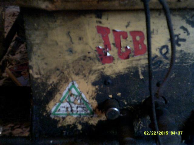

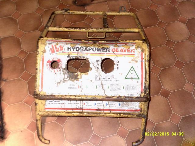

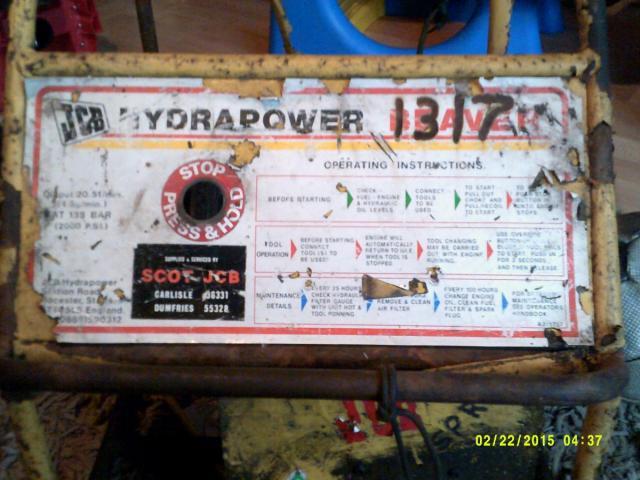

S1g 579 #31 Posted February 22, 2015 hope you get better soon gareth i caught shingles a few years ago and it was very very painfull and i certainly would not want it again Thank you Nigel, painful is certainly one way of putting it. Ive spent this afternoon, measuring up and sketching the decals with a view to getting them reproduced.- I'm unable to do much else due to the pain. Share this post Link to post Share on other sites
nigel 1,881 #32 Posted February 22, 2015 send these photos to titch at machinrey decals he will soon sort them out for you 2 pmackellow and S1g reacted to this Share this post Link to post Share on other sites
S1g 579 #33 Posted February 22, 2015 send these photos to titch at machinrey decals he will soon sort them out for you He has allways done a top job for me in the past, and have allready packaged up the sketches etc to send to him. I've had to do a lot of detective work and educated guessing at the missing words where the decal has been damaged, just hope I've got it right. Share this post Link to post Share on other sites

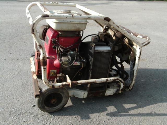

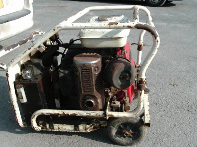

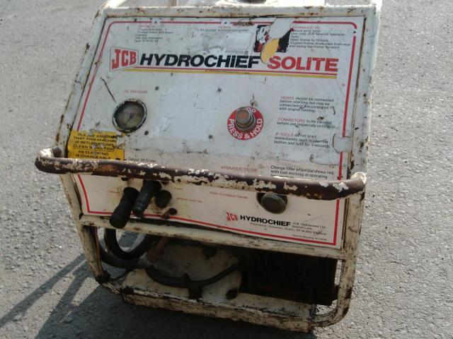

S1g 579 #36 Posted April 9, 2015 Looks like I've done it again, tonight I've just purchased the beavers predessor, a Hydrochief Solite. About twice the size of the latter, yet only gives out the same power. It's a good job that its so rare otherwise I'd of simply told the seller to f*#k off and got back in the van. I've never had a deal that someone has had such a bad attitude!! Photos to follow on the weekend. 2 nigel and Triumph66 reacted to this Share this post Link to post Share on other sites

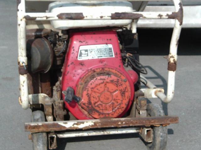

S1g 579 #37 Posted April 10, 2015 Heres the beast. Heres the beast. Probably dates from around 1980. 1 Triumph66 reacted to this Share this post Link to post Share on other sites
S1g 579 #38 Posted April 11, 2015 I've been giving this a once over this morning and am very pleased. It appears to run well, on the hand start anyway , yet I'll have to rig a battery up to test the electric start option out. I will also have to plug the flow gauges into it to see what oil it's producing. About the only things that I can see wrong is it needs a new rear castor, one engine mount is perished( I believe I've got one in my spares) and the oil cooler is a bit marked( 3 brand new old stock units are sat on my shelf). I've also just had arrive a very nice sales brochure off ebay covering these machines and all their attachments, it's in full colour and 8 pages so should look good displayed with this machine. Also I've found a solitary photo on the net of these packs when new. 2 Triumph66 and nigel reacted to this Share this post Link to post Share on other sites

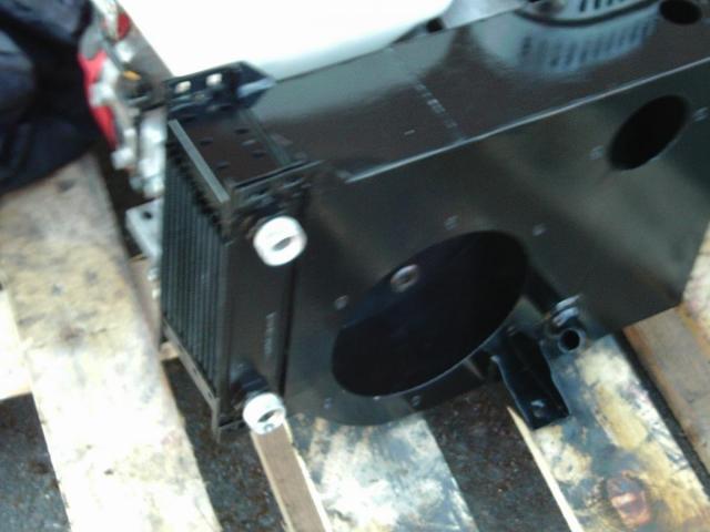

S1g 579 #39 Posted April 11, 2015 18,4 This afternoon I've finally felt up to doing some more work on the Beaver (thanks mainly to a stronger prescription for my shingles). This involved stripping the paint off the oil tank and removing the ground in name and dents. Then several coats of high build etch primer. This was then followed by several more of gloss black. In the final picture it looks like ive missed some of the inside but this is down to the trick of the flash. 2 Triumph66 and Stormin reacted to this Share this post Link to post Share on other sites

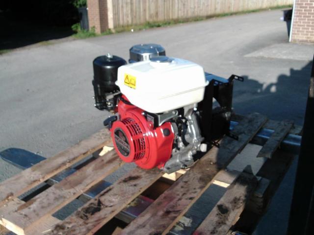

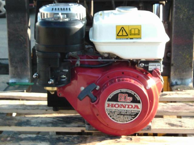

S1g 579 #44 Posted April 13, 2015 Went into work just gone 6 am this morning and bar the coil have got the beavers engine ready to trail run. My cameras battery died just as I went to take a pic. Will see if I managed to get one, once I'm back at the PC tonight. Share this post Link to post Share on other sites
S1g 579 #45 Posted April 13, 2015 I cant get the picture off the camera, however I have now fitted the coil and the engine genuinely started first pull, not bad considering it must of been stood for at least 10 years prior. The other good news is theres no smoke what so ever, its allways a concern when fitting new rings to Hondas. Share this post Link to post Share on other sites
Stormin 4,458 #46 Posted April 13, 2015 Sounds as if all the work is paying off. Well done. 1 S1g reacted to this Share this post Link to post Share on other sites

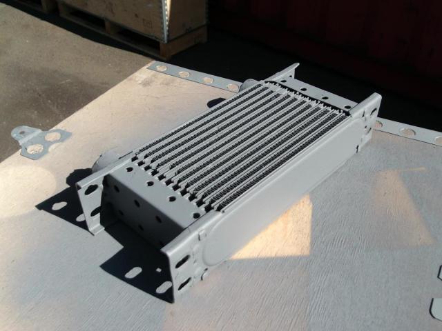

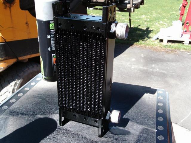

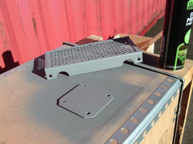

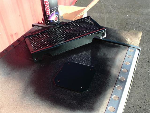

S1g 579 #47 Posted April 14, 2015 Heres the finished engine in the sun. Just needs a bit of spit and polish. As the weather was good I took advantage of it and repainted a few items. The first was an original spec oil cooler, boy did it take some finding as they were discontinued 15+ years ago and the latest beaver ones are different.i had to go through nearly all my contacts in the trade before I traced one. I also cleaned up and painted the oil cooler cover and the tank plate. 1 Stormin reacted to this Share this post Link to post Share on other sites
