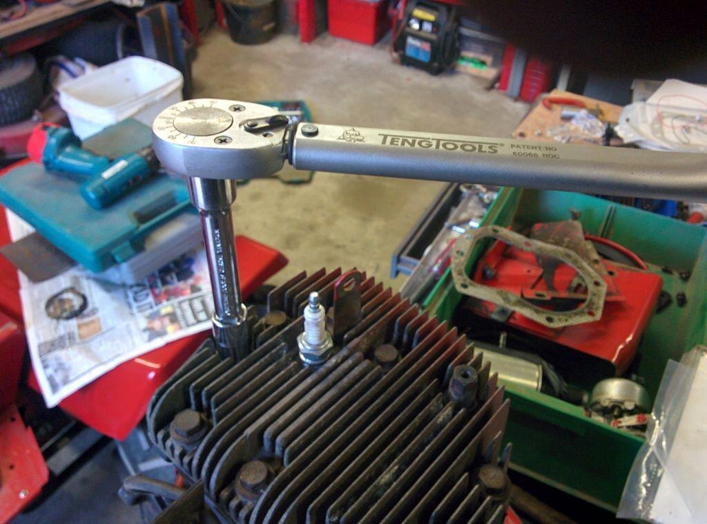

meadowfield 1,901 #26 Posted March 15, 2015 Brief update, new head gasket Head on and torqued up! Share this post Link to post Share on other sites

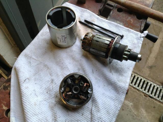

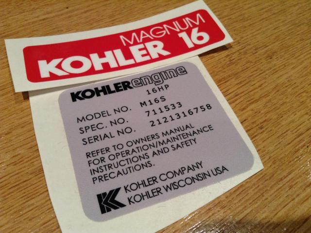

meadowfield 1,901 #28 Posted March 22, 2015 Been a busy week, managed an hour though...Rebuilt the starter, though I think it's brand new anyway - so it just needed a blow through with the air line. Cleaned up the fuel pump, and rebuilt and cleaned the breather which was full of silicon!!! morons, a gasket costs a few quid and it was full of bathroom silicon!!!! Before I strip the cowl as it's got hammer rash, that's why it has a new starter... I took the liberty of making out a very vague serial number and printing a few new decals. 2 the showman and diggerjames reacted to this Share this post Link to post Share on other sites
