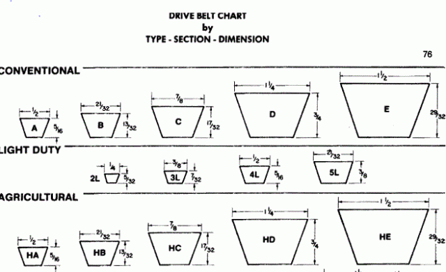

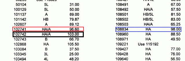

Anglo Traction 1,018 #52 Posted May 12, 2015 Ok Martin, I bow to Andy's experience of 'In the Field' use of types of manufacture/material. Also Wrispin's Knowledge of Dayco Belt equivalents etc. But lets try and clear the air of uncertainty and resolve your issue. So you have a 42"side discharge Deck with no I.D and an early 80s C-125. Forget about the old 36" Deck and it's belt for now. I've checked as many 42"SD Deck model numbers from 1980 - 1986 and the predominant Belt used/recommended is #102742. There are exceptions of course, so can't define the belt required exactly. This Belt Duty is graded (in the U.S) as HA/A. and is 103" in length measured around it's Outer circumference (see image example of list below). The Belt Section size is 1/2" x 5/16" (also see image example below). So all you can do is look for a retailer that quotes the Belt part number of an Aftermarket example, rather than look for an example by length. I also suspect the majority of belts are of the conventional standard, which probably would not last as long as an Agricultural Duty one. It also only needs the slight differences of Imperial to metric measurements to render a belt as ineffective in some installations. So your situation requires you to fit the deck on your Tractor and lower it to cutting position to check the length required. You can either trial fit the Old 102741 Belt which is 96.60 inches long and see just how short it is (note - ensure belt is always on the inner groove of the PTO Bell). Or, use some rope of approx 1/2" (12.7mm) in section and ensure it is taught when you mark it for measuring. If your check reveals that the Belt #102742 of 103inches outer length is correct or very close, then you will need to order by using Wheel Horse belt number 94-2501. This number supersedes the previous one, but both are still used for I.D. The other belt number (#108834) highlighted in blue on the Wheel Horse Manual example is commonly used on REAR Discharge Decks and is only to point out just how important it is to refer to Model numbers when looking for parts. So when you have found which belt you need or length required, there is an Online site that quotes Old Wheel Horse Belts by Part Number as well as Belts by Manufacturer. So here is a link to assist your choice - http://www.beltingonline.com/ (look down the left for 'Garden Machinery Belts', click on Manufacturer, search for Wheel Horse) Lastly, before you fit the Deck, check to see if there is a number on the Deck Spindle Drive Belt. If so, please note it on here and I will see if I can narrow down the Deck Model number. Hope this helps. Regards Share this post Link to post Share on other sites
Martin H 6 #53 Posted May 14, 2015 Well A.Traction, that is thoroughly comprehensive, thank you. I have an agricultural engineering supplier near me, I was just going to take the old belt in and see if we could find a match, but this trove of information that you've supplied has thrown new light on the subject and will help even more. I suspect the belt I've got isn't the right one anyway, as when I fitted it I had to wind in the adjustment on the double pulley at the front nearly all the way in and that can't be right..(probably why the belt shredded after an hour or so.... I think the next step is the rope measurement, if I couple that with the section size, I might be able to find some kind of match at my local or use the link you gave me. That'll have to wait until next week. There's nothing on the spindle drive belt, so it's still a guess as to what model this is. Looks like it's going to be a problem finding out the model. I'll make some enquiries to the previous owner, see if I can get more details. This is almost as bad as finding a decent cutter deck in the first place... Thanks for the help and the link. I've now got some options.. Cheers, Martin. Share this post Link to post Share on other sites
Anglo Traction 1,018 #54 Posted May 14, 2015 A bit more info for you, Just to clarify why your old deck/belt don't seem to match up or fit on your tractor, it is because the Deck is a 1972 model which used a different belt size to fit onto WH tractors of that age/era (prt nbr #9360 'A' Duty, 95.63inch long). Note the light duty belt type. Being fitted to your 80s Tractor, I suspect the belt (102741) was selected based on the 80s style 36" Deck and your 80s WH Tractor. The main difference was the Belt adjuster system on the front of the Tractor, as it differed from the very early 70s and possibly the main Spindle/Pulley position and size. As for your 42" SD Deck, and you have no info for it, I reckon your Deck Spindle Drive Belt should be WH Prt Nbr #6938 , HA or 4L duty and 86inches long....... (note the heavier duty type). This belt number is quoted for nearly all mid 70s - late 80s WH 42"Side Discharge Decks according to Wheel Horse and later Toro. Lets hope your Blades are sharp and balanced for now....that's another ballgame !. Regards Richard. Share this post Link to post Share on other sites

Martin H 6 #59 Posted August 1, 2015 Ok...been away for a while, so no progress with the belt, but I'm back on it now.. I have measured with a 1/2" rope as suggested and I got a size of 96" with the adjuster in a roughly middle position. So according to Anglo Traction's research it looks like it's probably the 102741 belt at 96.6", which I'll purchase from beltingonline.. I haven't found a local supplier yet, but it's a start.. I do have one more question if anybody's still reading this... The tach o matic system. When I try to attach the deck I find that the forked piece at the front of the deck on the cantilevered frame thing won't go around the bar above/inside the locking section. It's about a half inch out and there seems to be no room for adjustment to make it fit. The deck will go in without the fork being in position, but I'm not sure what the fork does and how important it is that it's seated around that small bar, if indeed that's where it's supposed to go.. Thanks again for all the info so far, absolutely invaluable... Cheers all.. Martin. Share this post Link to post Share on other sites
