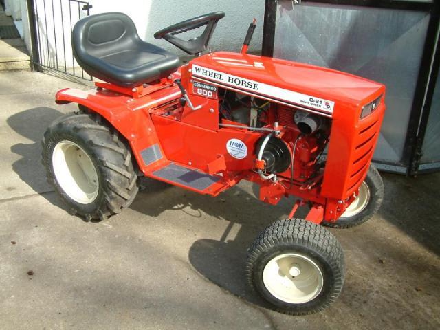

Stormin 4,458 #3 Posted April 29, 2015 That's what I've used on the C-81 and C-121. I've added a piece on the rear of the foot plate as well, to stop boot heels marking there. You can just see on the photo below. 3 neil, Alan and Triumph66 reacted to this Share this post Link to post Share on other sites
