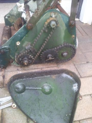

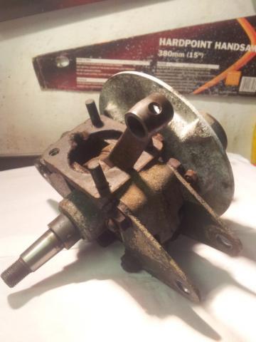

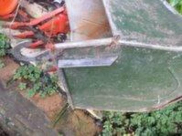

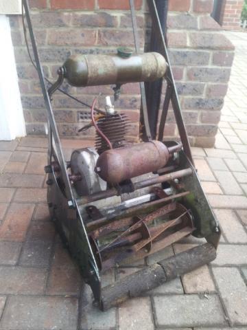

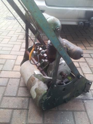

Darmic1 447 #1 Posted January 23, 2014 Well, this is what I'm currently working on. (Its also on the other site) Here's what it looked like when I picked it up. Share this post Link to post Share on other sites
Darmic1 447 #2 Posted January 23, 2014 It had quite a few things wrong with it. The carb slider was completely seized, the wrong grass box and some one had been at it with the spanners. Share this post Link to post Share on other sites

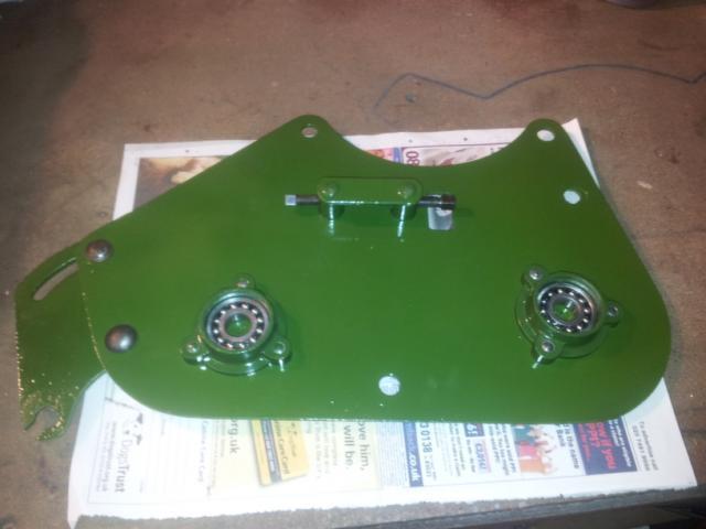

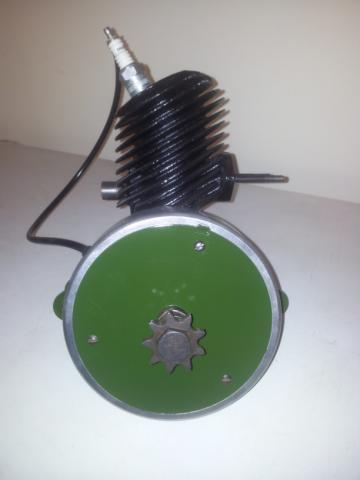

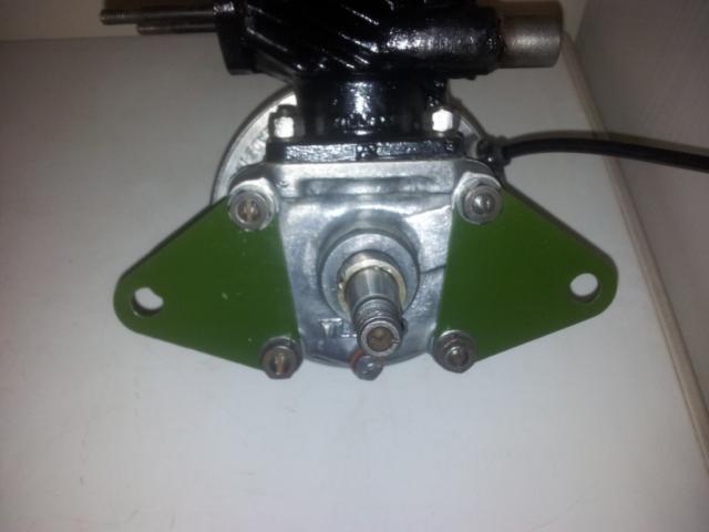

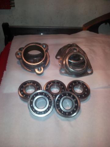

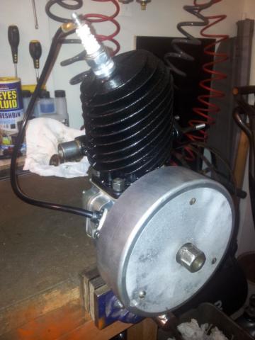

Darmic1 447 #3 Posted January 23, 2014 After many hours and a few £££s spent, the Engine is finished, New bearings were sourced for the entire mower, a couple of spares were donated to the cause and some other parts were repaired, overhauled or completely remade. Share this post Link to post Share on other sites

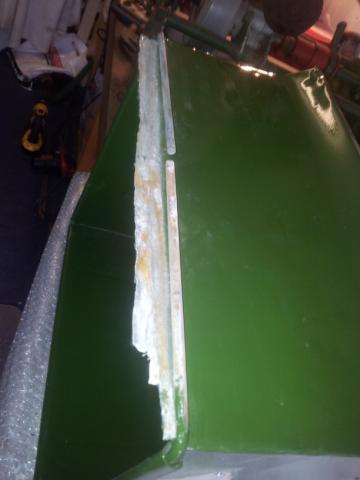

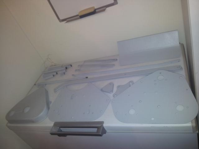

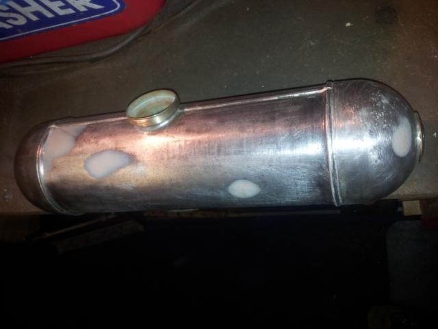

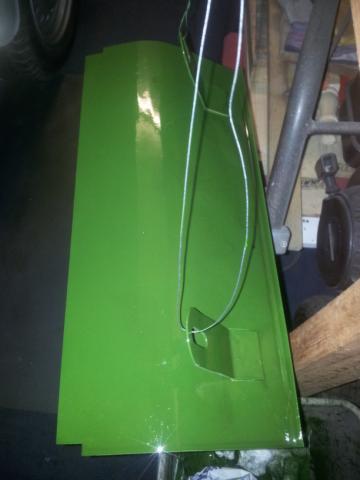

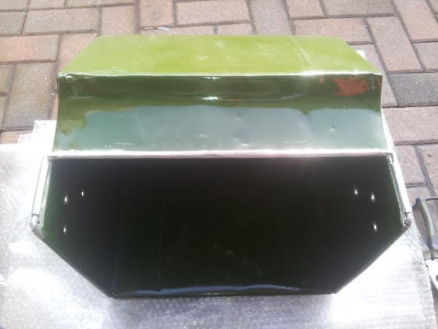

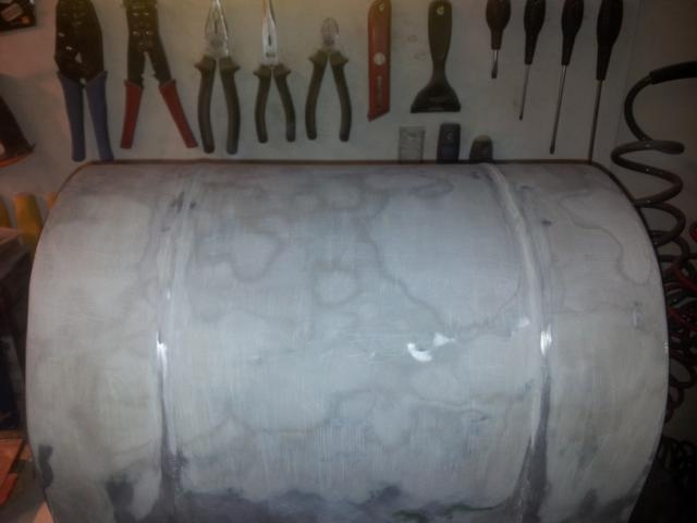

Darmic1 447 #4 Posted January 23, 2014 (edited) The fuel tank was stripped, filler applied where needed and the grass box had a make over. The rest of the metal work was shot blasted and coated with an epoxy powder, ready for painting. Edited January 23, 2014 by Darmic1 Share this post Link to post Share on other sites

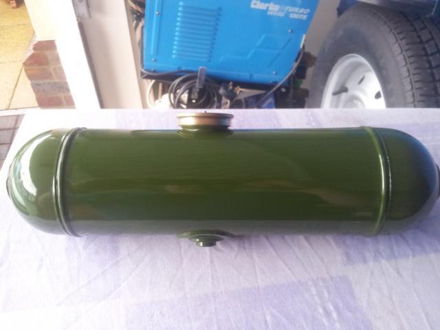

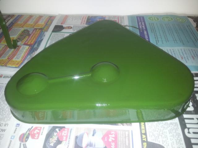

Darmic1 447 #5 Posted January 23, 2014 Then the Atco green was applied, here's the tank and a few other bits all painted. Share this post Link to post Share on other sites

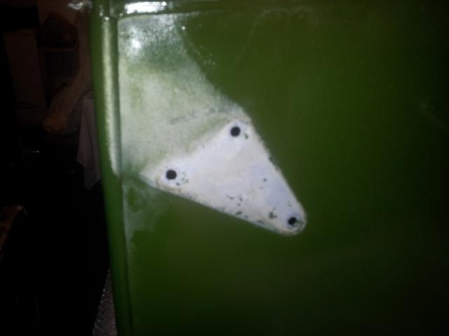

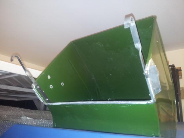

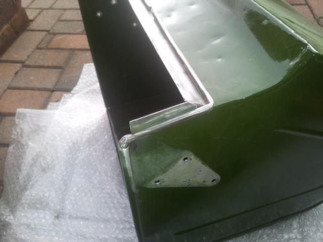

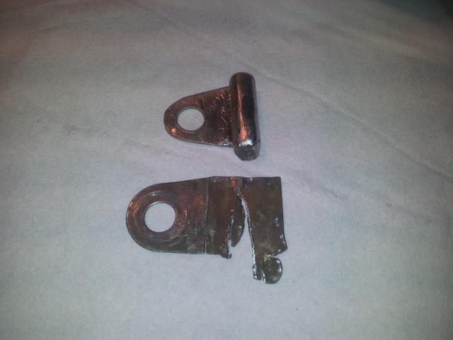

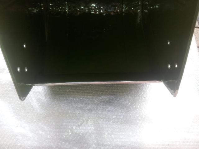

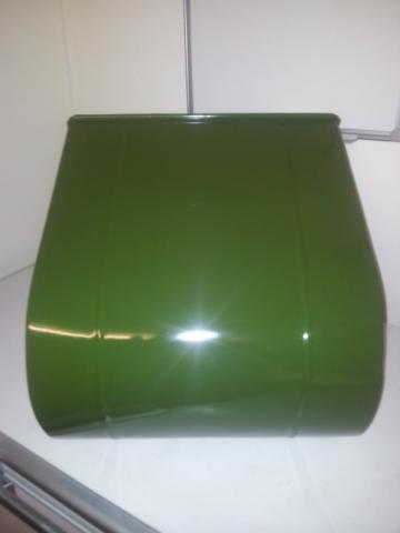

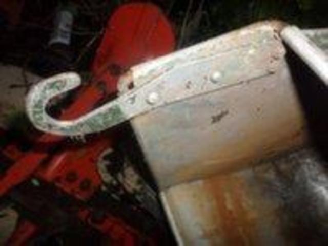

Darmic1 447 #6 Posted January 23, 2014 (edited) Then I discovered the earlier mentioned problem, the wrong grass box! S1G kindly sent me some pictures of how the box should fit, and so I set about modifying mine. Edited January 23, 2014 by Darmic1 Share this post Link to post Share on other sites
Darmic1 447 #7 Posted January 23, 2014 Here's the finished modified grass box, hope it works as it should! Share this post Link to post Share on other sites

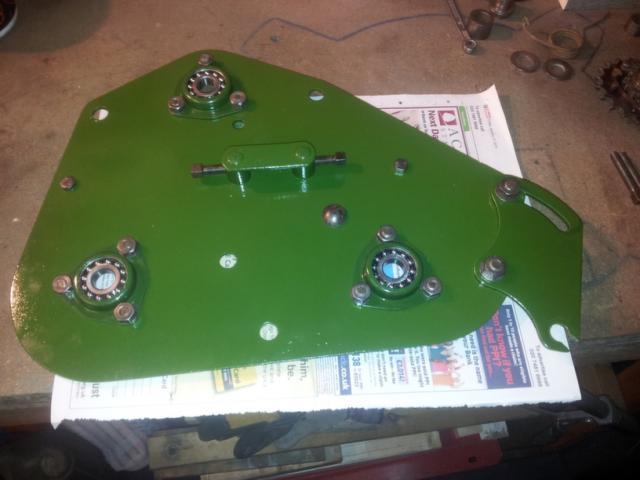

Darmic1 447 #8 Posted January 23, 2014 Finished the painting today and started to reassemble the mower, This is where I'm up to at the moment...... Share this post Link to post Share on other sites

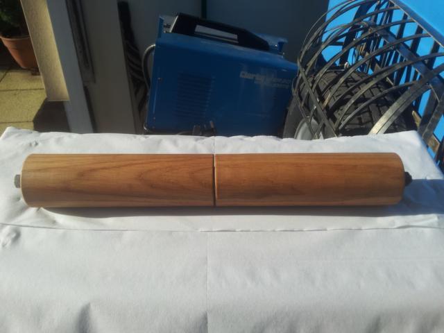

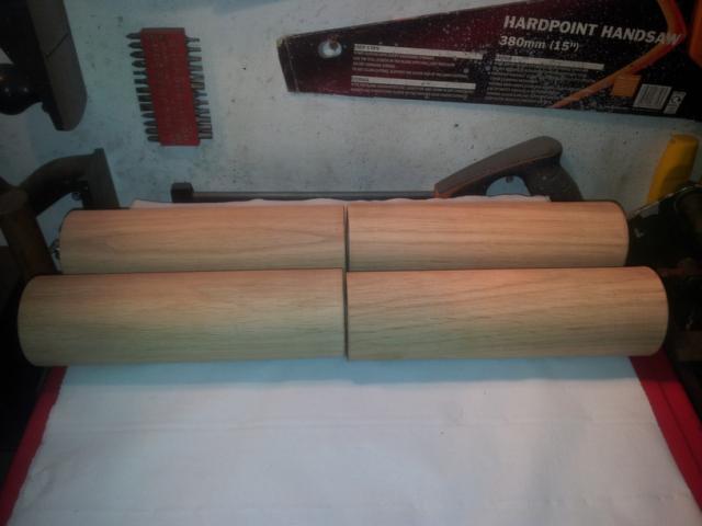

Darmic1 447 #9 Posted January 24, 2014 Also had a very kind fellow invite me over to his workshop to make these new front rollers. Made from seasoned English Oak, once turned I inserted the brass and soaked them over night in a 50/50 mix of Linseed Oil and Turpentine. Share this post Link to post Share on other sites
