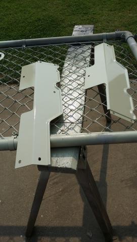

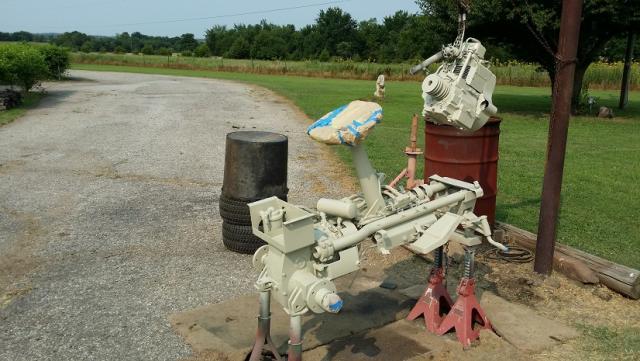

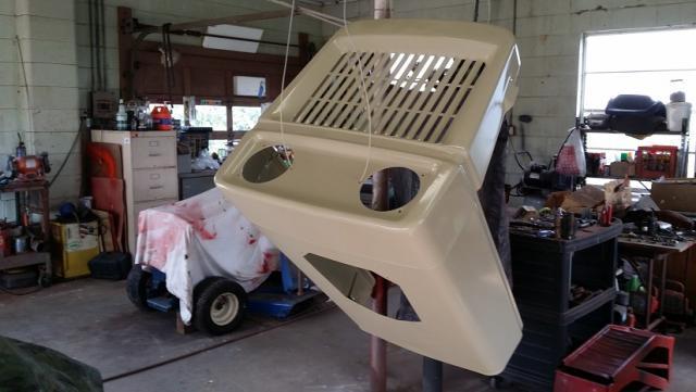

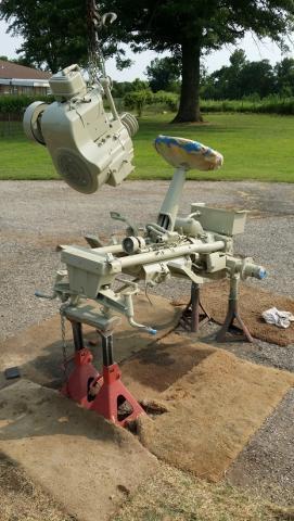

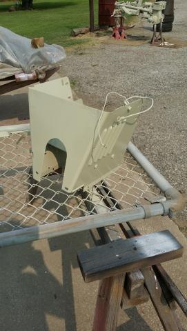

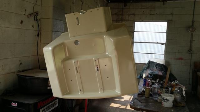

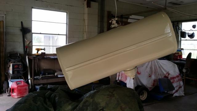

HeadExam 1,783 #1 Posted June 29, 2015 First and second coats are done, I'm putting on more for good measure 3 slf-uk, S1g and Triumph66 reacted to this Share this post Link to post Share on other sites
Triumph66 1,256 #2 Posted June 29, 2015 Looking great and your workshop is so organised. Cheers 1 HeadExam reacted to this Share this post Link to post Share on other sites

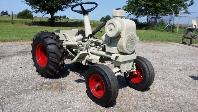

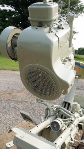

HeadExam 1,783 #3 Posted June 29, 2015 Thanks Andrew, it seems a mess to me, hopefully one day I will get it where I want it. I ended up putting three coats on the 1556, evening light makes it look more beige than it really is. 4 Triumph66, slf-uk, S1g and 1 other reacted to this Share this post Link to post Share on other sites
bowtiebutler956 166 #4 Posted June 30, 2015 Your doing very nice work there. That's going to be one sharp looking Bolens! Matt 2 Triumph66 and HeadExam reacted to this Share this post Link to post Share on other sites

HeadExam 1,783 #11 Posted June 30, 2015 The color in my last picture is a true representation, but the other pictures in the late afternoon light made the color very beige, almost ivory. That is why you cannot use pictures for color samples as there are to many variances in the camera, light, and age of the picture. I'm happy with the picture with the wheels on as that really looks like the Bolens off white of the day, more than that I know its the right color because I had it matched from inside the frame rail cover. 1 Triumph66 reacted to this Share this post Link to post Share on other sites
