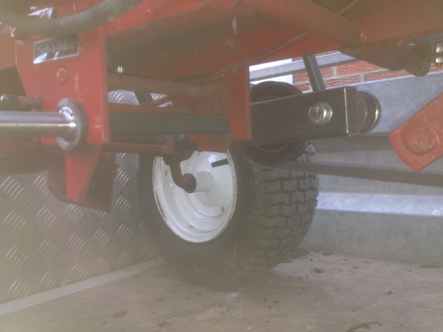

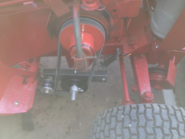

bubbalove 54 #11 Posted July 14, 2015 DO YOU NO IF MY WHEEL HORSE NEEDS THE MID IDLER SPOKETS LOCATED UNDER THE CLUCH PULLYS OR DO I NEED A LONGER BELT AS TO USE THE BELT TENTIONER AT THE FRONT WHICH YOU WOULD TENTION THE CUTTING DECK ?? MY 139 INCH BELT HAS ARRIVED BUT IS FAR TO SHORT TO GO ROUND FRONT PULLYS Share this post Link to post Share on other sites
HeadExam 1,783 #12 Posted July 14, 2015 Is your belt routed like this? Share this post Link to post Share on other sites
bubbalove 54 #13 Posted July 14, 2015 no i dont have the 2 pullys underneath the drive pully/clutch i first thought that i would be using the 2 pullys on the front belt tentioner but i can now see from your pic and a bit of digging around on the manuals you sent me ive got the middle idler assembly missing so ill have to get the lathe dusted down to see what i can come up with lol :hyper: 2 HeadExam and nigel reacted to this Share this post Link to post Share on other sites
bubbalove 54 #14 Posted July 21, 2015 not quite as neat a job as i would of liked but i think ive cracked it £4 on a bearing and i think ive done it its not finished but its usable not bad for £4 and a bit of time i might even tickle it with the paint brush lol 2 nigel and Stormin reacted to this Share this post Link to post Share on other sites
