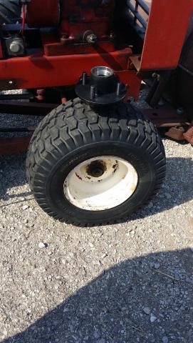

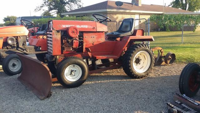

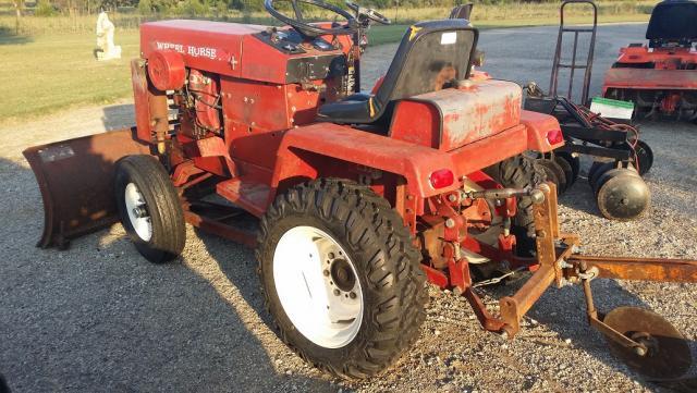

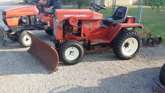

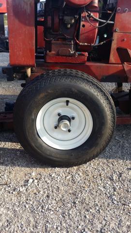

HeadExam 1,783 #1 Posted September 30, 2015 The front has 5.00-10 Deestone tires on 4-10 steel rims with cast iron four bolt shorty trailer hubs. the rears are 27-9-15 Maxxis Ceros ATV crossover tires on stock 15x7 Wheel Horse rims, all painted Wheel horse white which was matched from the inside of the rim. 7 nigel, Triumph66, C-101plowerpower and 4 others reacted to this Share this post Link to post Share on other sites

Joe the small engine man 89 #3 Posted September 30, 2015 That looks great! I want to change the front hub and wheel assemble from the circlip to the bolts and hub Wats the best way of doing it? 1 HeadExam reacted to this Share this post Link to post Share on other sites
Ian 2,417 #4 Posted September 30, 2015 Nice upgrades, those rear tires look like they should have plenty of grip Share this post Link to post Share on other sites
HeadExam 1,783 #5 Posted September 30, 2015 That looks great! I want to change the front hub and wheel assemble from the circlip to the bolts and hub Wats the best way of doing it? It really depends on the length of your spindle. I have three upgrade applications depending on length. Let me know and I'll post the info 1 Joe the small engine man reacted to this Share this post Link to post Share on other sites
