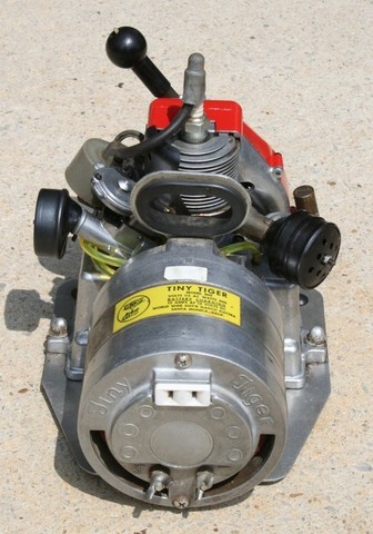

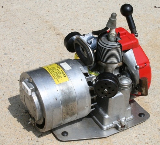

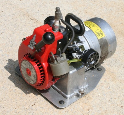

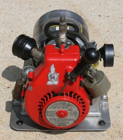

kd5byb 3 #9 Posted June 18, 2016 (edited) Good afternoon all, I check the governor this morning - it's working fine and not hanging up. Seems like 140 or so VAC is normal for these without a load. With a 60 watt light bulb (the old filament kind) it settled down to 125 VAC. Pretty cool little machine. Runs really nicely and isn't as loud as I thought it would be. Finally got some photos taken of it this morning as well. thanks much, ben Edited June 18, 2016 by kd5byb 2 pmackellow and Stormin reacted to this Share this post Link to post Share on other sites
Wallfish 716 #10 Posted June 19, 2016 NICE! Recoil / housing is nice without a lot of missing paint. Usually see them in much worse condition. Share this post Link to post Share on other sites
kd5byb 3 #11 Posted June 19, 2016 (edited) Thanks much! I'm pretty happy with the little generator. Looks nice, runs nice. thanks, ben Edited June 19, 2016 by kd5byb typos Share this post Link to post Share on other sites
Stormin 4,458 #12 Posted June 20, 2016 Lovely little machine. Share this post Link to post Share on other sites
