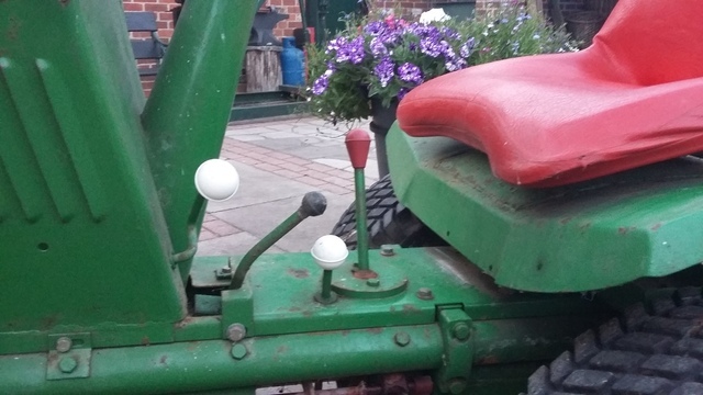

You're welcome. Thinking about it yours got a black steering wheel so it might be a 853 model? Also from your photos I can't see a lock diff on your rear wheel which is another possible indicator of a 853.  If it is, then it was made in 1970 to '73.

From the engine model and type you listed, I believe you have correctly read the numbers as 190401-013901. This would make the tractor a 1971 Bolens Husky 853 or to be more precise a 853-03. Various other things on the tractor confirm it as an 850 too. As Andrew said not many around.
You mentioned a high/low lever, that is the one with the shaft going into the dash tower. You should have two belts fitted, one on the high speed pulleys and one on the low speed ones. The lever moves the idler pulley from one belt to the other providing tension. They are a bit of a pig to set-up but when working they are great. Give me a shout if you need any help with it.
