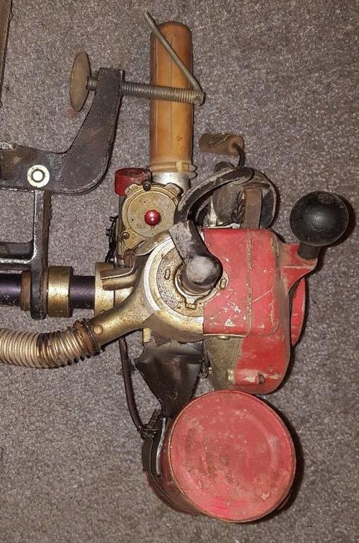

Wallfish 718 #61 Posted June 11, 2019 IMO they actually look better without the plastic cover. I attached a drillgine gas tank to one of mine and it gets a lot of attention at the shows. A vertical style normal O&R round tank with a bracket would look good too 1 pmackellow reacted to this Share this post Link to post Share on other sites

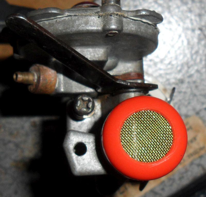

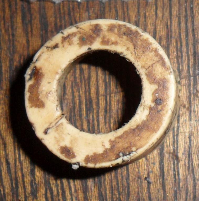

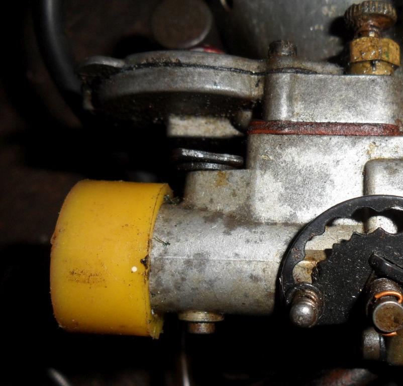

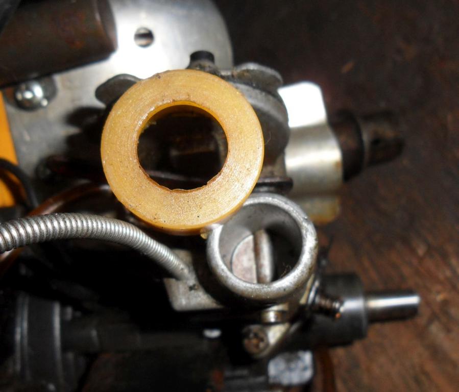

factory 487 #65 Posted June 11, 2019 For reference here are some pictures of the cover that retains the gauze for the carb opening on one of my Aquabug's, looks like a new piece of gauze can be fitted. Paul, I've sent a PM about the spares from the donor engine. David 1 pmackellow reacted to this Share this post Link to post Share on other sites

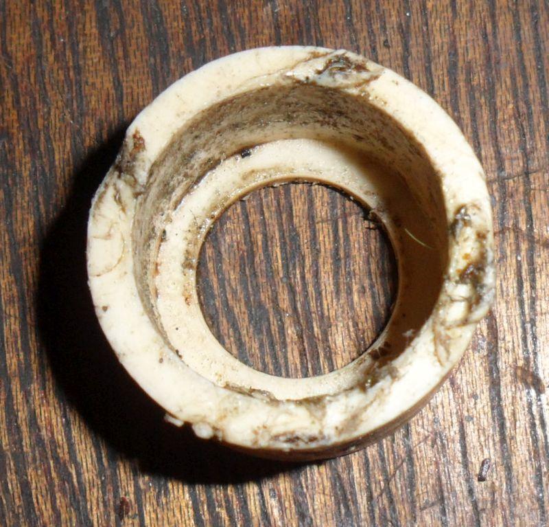

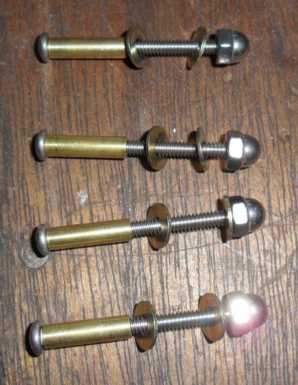

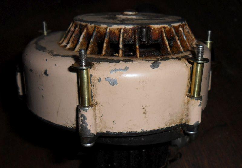

factory 487 #69 Posted August 7, 2019 I've recently been working on replacing the missing & damaged plastic spacers originally used for the Aquabug covers. I did initially test some plastic spacers I had in my spares, but they were a bit too large in diameter to fit properly and also didn't react too well with fuel. Anyway I quickly gave up with those and started looking for something better, eventually I found some brass tubing from Albion Alloys at a model engineering supplier. https://www.chronos.ltd.uk/acatalog/info-BT5.html Here are the finished spacers after cutting to size, together with the fixings (I've since had to order some longer screws), the second picture shows where they are used. David Share this post Link to post Share on other sites

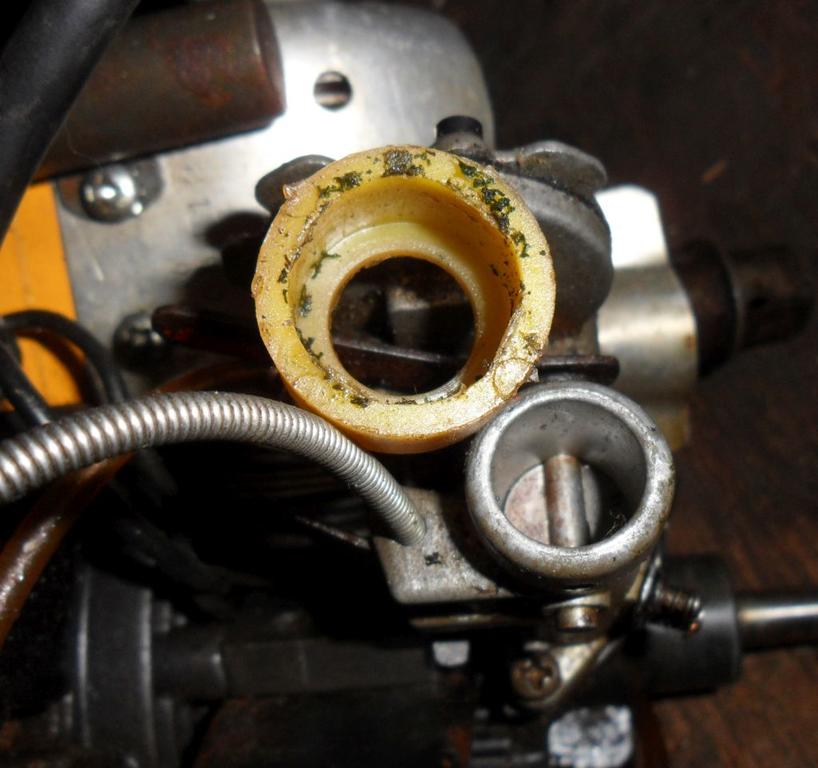

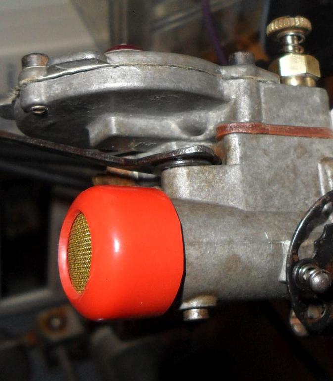

factory 487 #72 Posted August 26, 2019 Here is another part I have made for the Aquabug, the carbs don't have the usual air filter, instead they have a gauze filter held with a plastic retainer. Neither of my two Aquabug's had the gauze so I cut a piece to size, I made a retainer from a shortened plastic end cap with a hole cut in the end. David 1 1 pmackellow and CNew reacted to this Share this post Link to post Share on other sites
