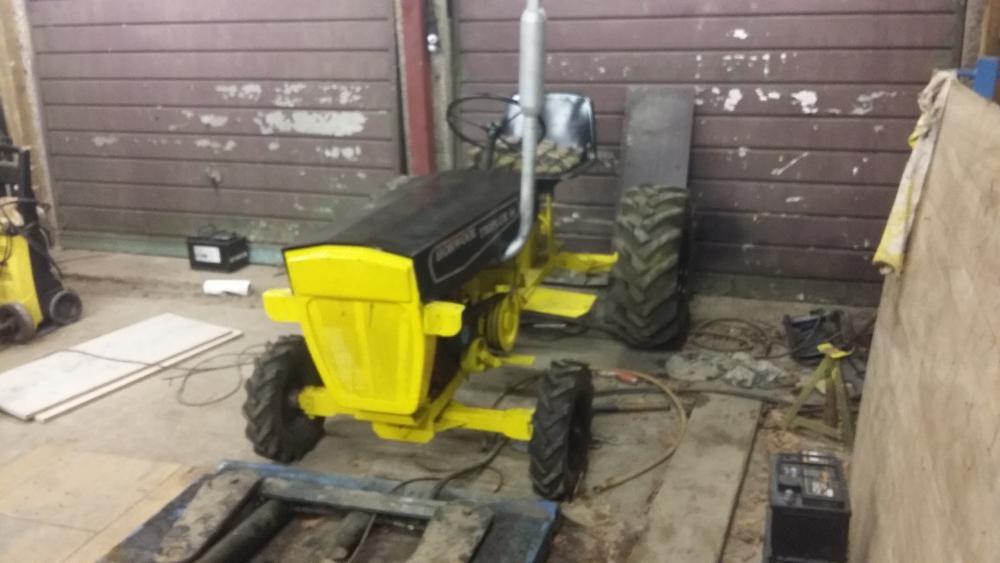

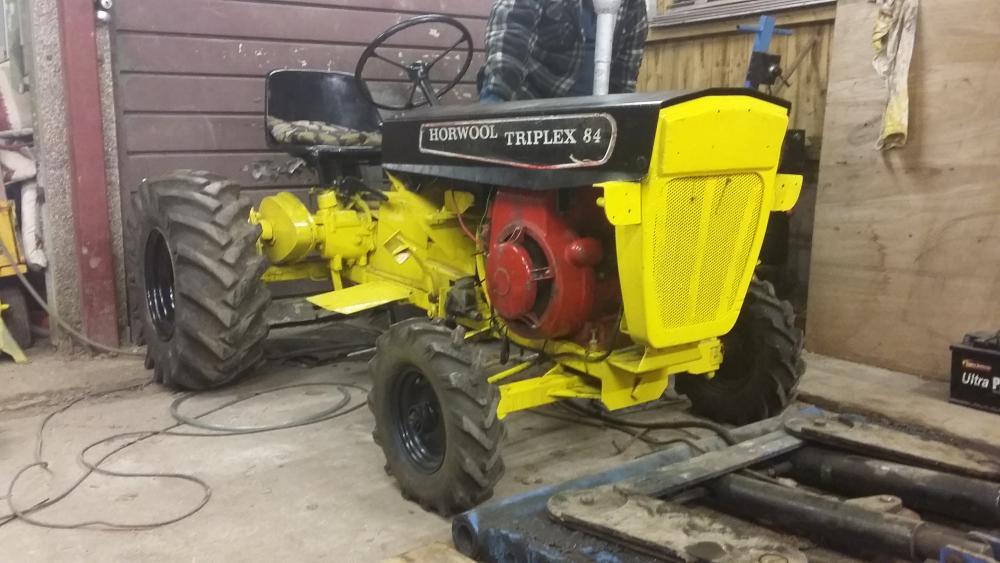

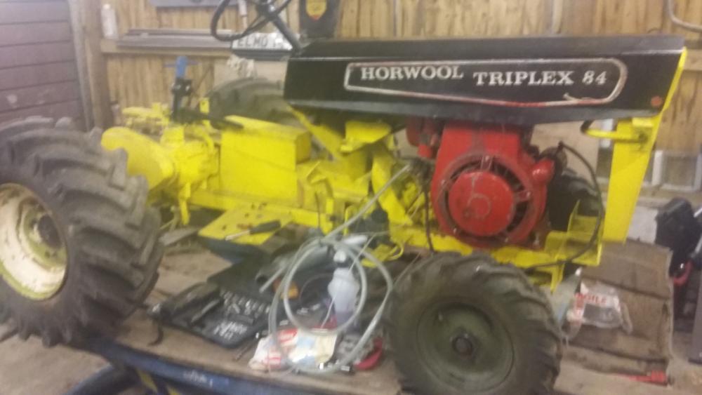

madmatt01 107 #1 Posted April 17, 2017 So today I have started to rebuild the horwool. Got the engine in place and rigged up the wiring. We got it to fire a few times but now nothing Can anone give me any pointers to look at.. Kohler k301s. It doesn't appear to have points. It has an external coil and breaker I think. Have checked it with multi meter... everything seems to be responding except the spark plug 😐 Il include some photos... Colour scheme the wifes choice. .. 2 Stormin and Alan reacted to this Share this post Link to post Share on other sites
Alan 1,274 #2 Posted April 17, 2017 Looks good. I know where those rear wheels and tires came from. Share this post Link to post Share on other sites
madmatt01 107 #3 Posted April 17, 2017 Yes.... dad machined a template at work and we re drilled to fit 6 stud. Sits well. Just hope I can sort engine. We have re wired as per online diagram with no luck. This solid state ignition is ment to be ultra relIable.... Guess il have to open my wallet Share this post Link to post Share on other sites

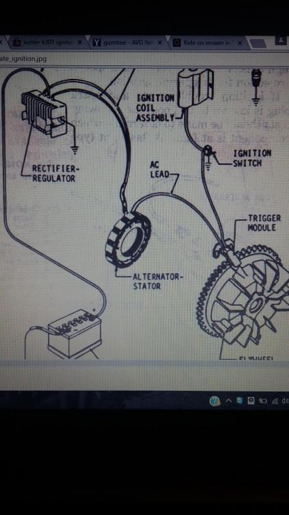

madmatt01 107 #5 Posted April 17, 2017 On this machine there isn't any safety wires. It is simply wired up as followed.. I'm worried the problem lies with the trigger module or ignition coil as can't find these parts anywhere Share this post Link to post Share on other sites
Wristpin 400 #6 Posted April 17, 2017 Quote I'm worried the problem lies with the trigger module or ignition coil as can't find these parts anywhere Not sure that I understand what you are saying as both the coil and trigger are shown in your original images. What is not clear to me from the schematic wiring diagram is whether battery current is needed for the ignition system or whether it is self energising and the battery is only needed for the starter motor. The danger is that if the ignition system is independent from the battery but due to a wiring error has received "a dose of volts" it may have died. Could really do with a better wiring diagram. I may have one and will have a look later. Share this post Link to post Share on other sites
madmatt01 107 #7 Posted April 18, 2017 When I bought the tractor it has the trigger wired to +. I think I may have burnt either the trigger module or the ignition coil. It provides its own energy behind the flywheel. Battery is just to turn over Matt Share this post Link to post Share on other sites

Wristpin 400 #9 Posted April 18, 2017 Hope that this may help, it covers both points and electronic systems and has a useful bit on trouble shooting electronic issues and testing the trigger unit etc. https://www.dropbox.com/s/22z2sei39yp70qy/Kohler ignition systems0001.pdf?dl=0 Share this post Link to post Share on other sites
