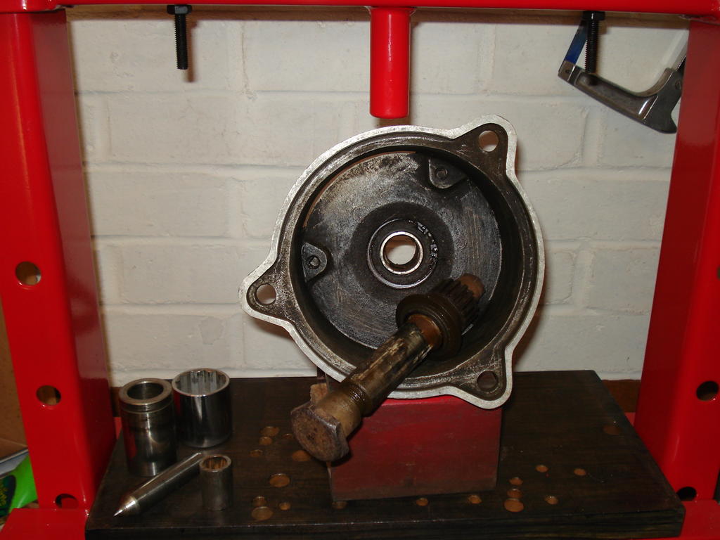

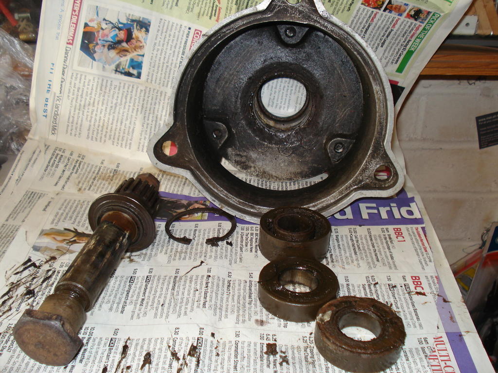

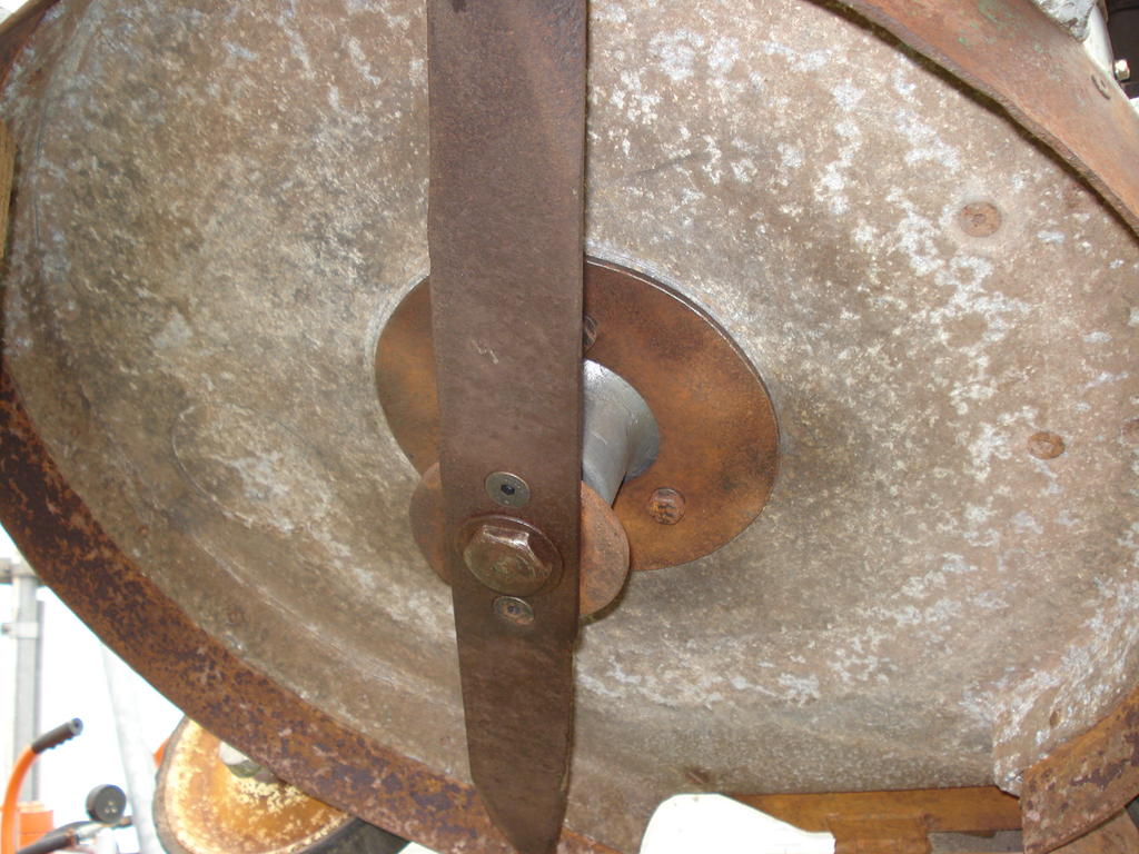

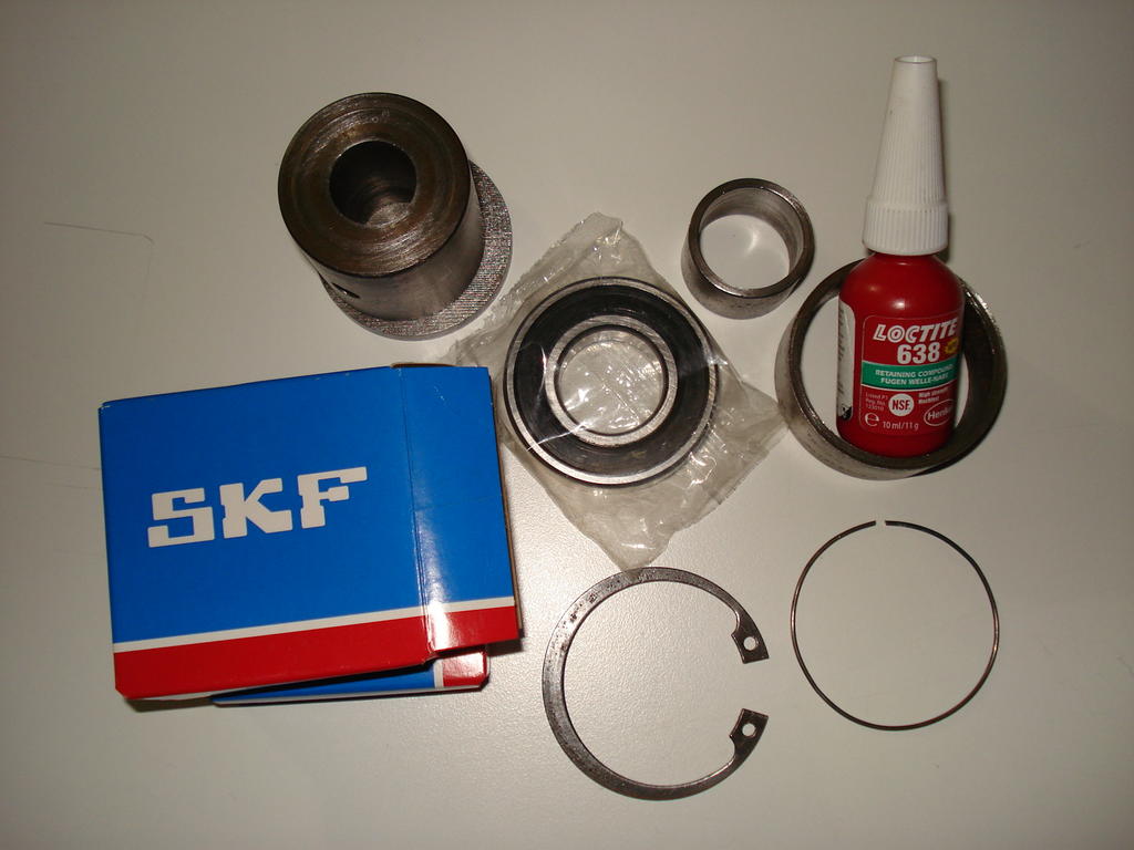

Anglo Traction 1,018 #8 Posted September 14, 2018 On 08/09/2018 at 6:15 PM, Sammoore13bolens1053 said: Sachs dolmar, the chainsaw brand perhaps? They used to make great machines, rubbish now Sorry for delay in reply. Nope, not a chainsaw. It is a Mower, but I don't think they are common in UK?. It was a bit of a wreck and on it's second engine (1965 mower model). Judging by the damage to the rather massive Spindle housing, it had a catastrophic bearing failure as well when the original engine let go of it's bits. Presumably, it had new bearings fitted when the engine was replaced, and it was these bearings which had also failed and I was tasked with extracting them for replacement- It took an awful lot of pressure just to get the 25mm diameter spindle out. I then had the same problem with the bearings and found they had been bonded in to take up the gap caused by the old seized ones wearing the Housing bore out- Found the housing bore was nearly 0.4mm larger after cleaning it out. That gave me a problem, as the usual Loctite bearing fit fluids could only cope with much smaller gaps. Searched and found one that specified use for up to 0.5mm gaps, obtained new quality bearings and had to make a circular wire spacer to hold the lower bearing away from a worn lip in the bottom of the housing- Reassembled and bolted up under tension to ensure everything was aligned while the joint fluid was setting. Installed the completed Housing back onto the Deck and fitted the massive sharpened/balanced blade. All now smooth spinning ready for running- It was then that I had to tear into the engine to find why no spark. Not impressed with the motor's design, over complicated and lots of work removing bits to get at the coil etc. Took a 4 foot (1.22mtrs) scaffold bar on both the Flywheel nut and then again to get the Flywheel off the keyed taper. Anyway, all sorted and got it running despite the iffy Carb (now you know where that Fuel Tap I fixed went to)- This machine had a serious impact on it's left rear corner. You can just see the (good) Ali weld repair bottom right. It had damaged the Drive unit housing etc and I had to pull that straight and fix the pulleys etc- So there it is, a 1965 SABO rotary mower with drive unit. I only have to fix the handles on and it's ready for testing and fine tuning. It has no remote throttle on the handle, only a lever that lifts the drive unit clear of the ground!. The throttle lever is on the Carb!. Interesting machine and a mildly enjoyable challenge, but give me an old british job with old whitworth spanners and a good chance of obtaining spares and info. Which spookily is what is lined up for me next edit- Mods can move this to another forum as it is a pedestrian op machine if desired. I kept it here for continuity Regards 2 pmackellow and Alan reacted to this Share this post Link to post Share on other sites
