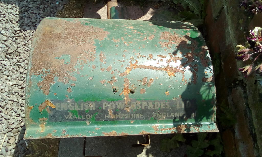

Picked up this unusual machine this morning. Have got the missing bits in a box. Fitted with a 2 stroke JAP 80 engine that is all ther
IMG_20180714_122026.jpg.13da53a122c74e28f93c3f91a8837ecb.jpgIMG_20180714_122026.jpg.13da53a122c74e28f93c3f91a8837ecb.jpgIMG_20180714_122026.jpg.13da53a122c74e28f93c3f91a8837ecb.jpgIMG_20180714_122026.jpg.13da53a122c74e28f93c3f91a8837ecb.jpge but has no spark (usual suspects no doubt). Made by English Powerspades Ltd who appear to have ceased trading in 1968. Looks quite well made & is certainly heavier than the Gardenmaster 85 that came with it.
Made a bit of a mess of this (it skills failed again) more photos
