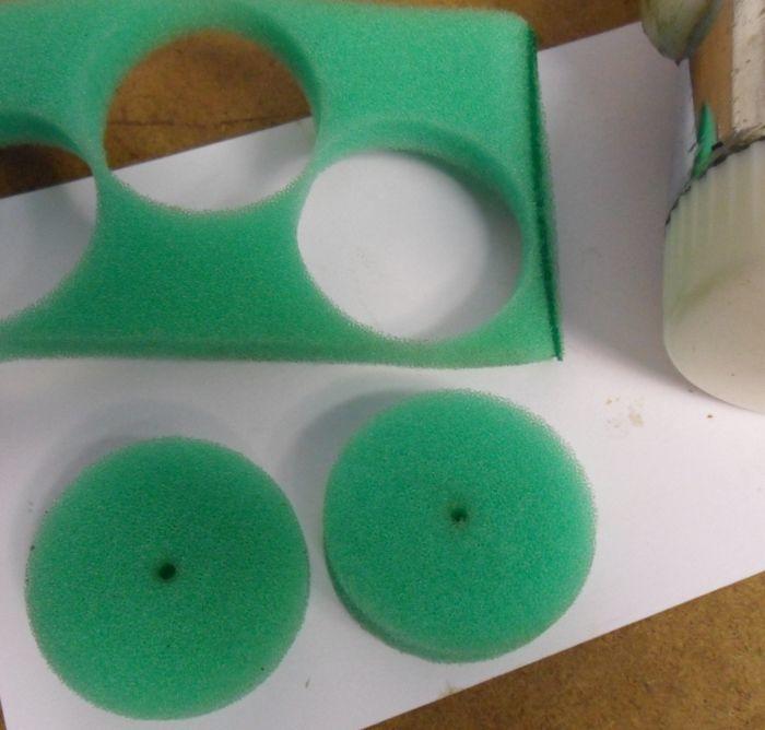

CNew 409 #13 Posted December 9, 2018 Thanks! It does appear that the air filter is pretty much disintegrated, not much left. What do you normally use to replace it, some new foam air filter from a modern engine cut down to size? I also just noticed that this engine has some sort of adapter where the spark plug threads into the head. I was able to unscrew it and remove it. It had a very small hole threaded into the center, could this have been for using a glow plug or something? With the plug out it actually looks like this engine may have never been run. Clint Share this post Link to post Share on other sites
Webhead 95 #14 Posted December 10, 2018 You can buy any foam filter material and cut it down to size. You will then need to stuff it through the mounting hole and I use a toothpick to even it out inside the housing. Share this post Link to post Share on other sites

factory 487 #16 Posted December 10, 2018 23 hours ago, CNew said: Thanks! It does appear that the air filter is pretty much disintegrated, not much left. What do you normally use to replace it, some new foam air filter from a modern engine cut down to size? I also just noticed that this engine has some sort of adapter where the spark plug threads into the head. I was able to unscrew it and remove it. It had a very small hole threaded into the center, could this have been for using a glow plug or something? Yes you can cut out a new filter from any suitable modern foam air filter material as Webhead said, I got some from my local garden machinery repair shop. The adaptor is indeed for a glow plug, I wonder why they didn't remove the magneto coil? Possibly they never completed the RC project it was bought for. David Share this post Link to post Share on other sites

CNew 409 #18 Posted December 11, 2018 Thanks David! The photos of the foam are helpful. I agree, the glowplug adapter is interesting. I’ve got it out now and will go with a normal spark plug. I may stop at the local hardware store again that sells Stihl and see if there is anyone there that might have some insight on the oil composition. Since Stihl doesn’t say anything on the official website I’m thinking it may be a hard fact to uncover. clint Share this post Link to post Share on other sites
