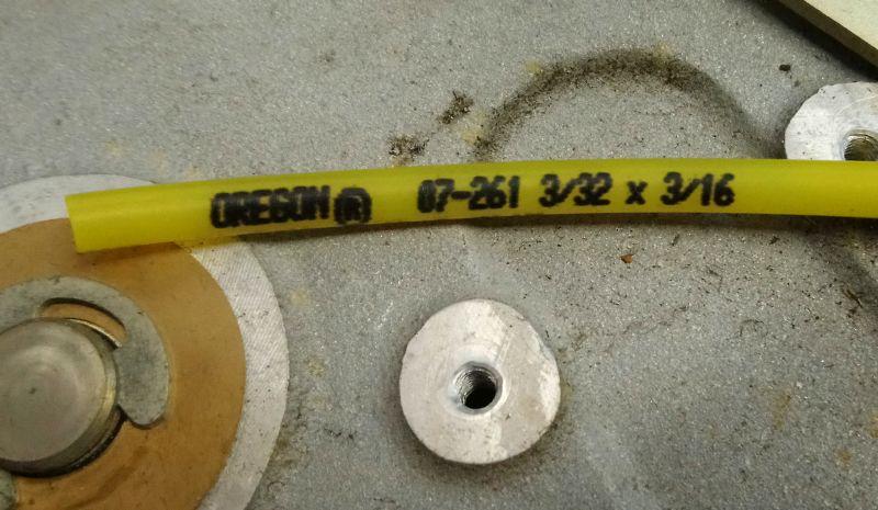

CNew 408 #7 Posted December 16, 2018 Just to ensure I get the correct size, what is the recommended fuel line size for these O&R engines? I was planning to get some Tygon line and there are quite a few options. Share this post Link to post Share on other sites
factory 487 #8 Posted December 17, 2018 My local shop doesn't sell Tygon, but the Oregon tubing I have been using from them is 3/32" internal diameter, note the external diameter (3/16") is bigger than the original tubing used by O&R so the original fuel line clamps/clips will no longer fit (I have kept those in case I find something smaller in the future), but the tubing seems secure enough without them. I'm sure the Tygon equivalent will be fine, maybe one of the US members can advise the type/size they use. David Share this post Link to post Share on other sites
CNew 408 #9 Posted December 17, 2018 David, Thank you very much, that’s exactly what I needed! I’ll check around for this size in Tygon but if that’s not available I will hunt down the Oregon tubing. Clint Share this post Link to post Share on other sites

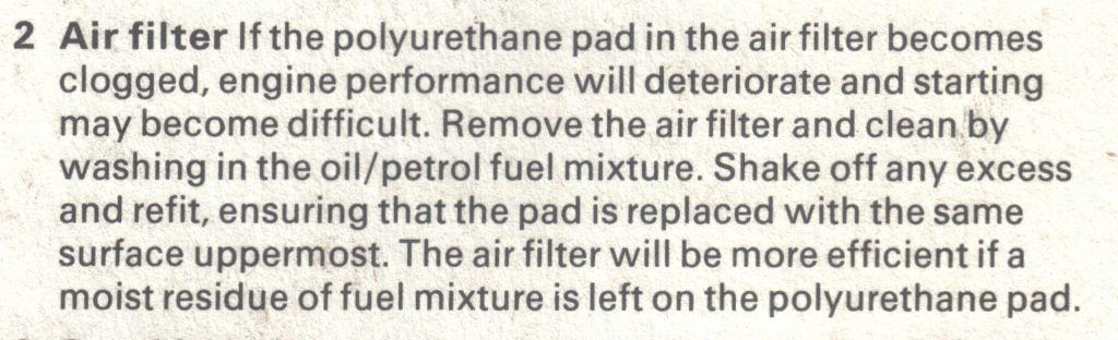

CNew 408 #15 Posted December 19, 2018 David, I bought some UNI brand green filter foam that is 5/8” thick and I can cut out the circles to replace the old filter that has completely disentigrated. Question, the UNI manufacturer recommends oiling the foam for proper filtration. Have you found this to be a good practice even for the O&R engines or should I avoid that step, just looking for a second opinion. Thanks, Clint Share this post Link to post Share on other sites
factory 487 #16 Posted December 23, 2018 I've had a look through various manuals for O&R tools and can only find one reference (in the Turbair manual) for using fuel mixture (which will become oil once the fuel evaporates) on the air cleaner/filter foam, most just mention washing with fuel or another solvent (not mixture). David P.S. I have heard of oiling air filters before (in the manual for an item of vintage 1960's HP electronic test gear, but OT for here but it's another of my hobbies), I haven't looked but I imagine the product mentioned is long since discontinued. Share this post Link to post Share on other sites
CNew 408 #17 Posted December 23, 2018 David, I’ve been looking on the UNI site and I think I’m now understanding that they are recommending just applying their special oil, to a mixture, to the foam filter. Sounds like it’s some sort of fairly thick and sticky oil that you massage into the foam- I’m guessing to help catch the dust. Then they suggest cleaning with their cleaner of course. Thanks, Clint ps: I was able to find the Stihl HP oil (orange container) and some high quality fuel in a can that is distributed/sold by Toro (I think it is 92 octane). This should eliminate the potential of harmful additives and ethanol that is common in the standard service station gas around here. Sorry, I mean to say “oil only, not a mixture” in my last post on oiling the filter. Share this post Link to post Share on other sites
