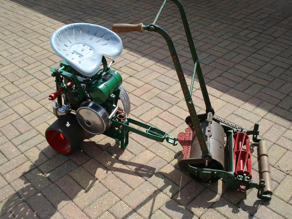

Anglo Traction 1,018 #52 Posted August 29, 2019 Will come back with an update on this towards the winter. It has now been married up to a good example of the original mower it used to push around in the 1920s- Needless to say in the meantime, it's being parked up on a display stand to earn it's keep at the Museum. I'm busy with miniature stuff at the moment. 3 Stormin, Cub Cadet and Alan reacted to this Share this post Link to post Share on other sites
kpthorsefan 25 #53 Posted August 29, 2019 Very very nice . Share this post Link to post Share on other sites
Stormin 4,458 #54 Posted August 29, 2019 That looks great matched to the mower, Richard. All credit to you. Share this post Link to post Share on other sites
Alan 1,274 #55 Posted August 29, 2019 Looking good Richard even before you have finished working your magic. Share this post Link to post Share on other sites
