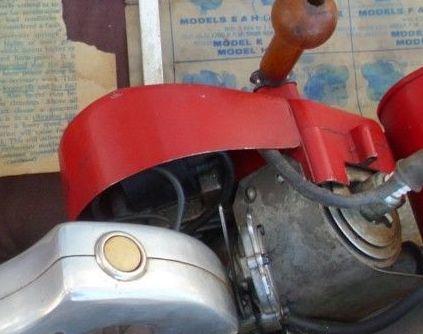

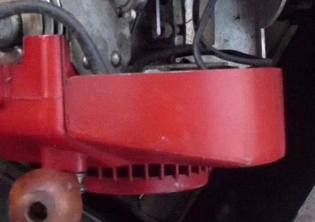

factory 487 #30 Posted July 28, 2019 On 7/26/2019 at 1:07 AM, JUST O&R said: I think that cover could be made it looks like just a thin metal cover. Once I get it going I might see if I can make one. It is thin steel & shouldn't be too hard to make, it attaches in the same place as the cylinder side plate, the later style coil cover would be trickier to make. Some close up pictures of the early cover. David Share this post Link to post Share on other sites

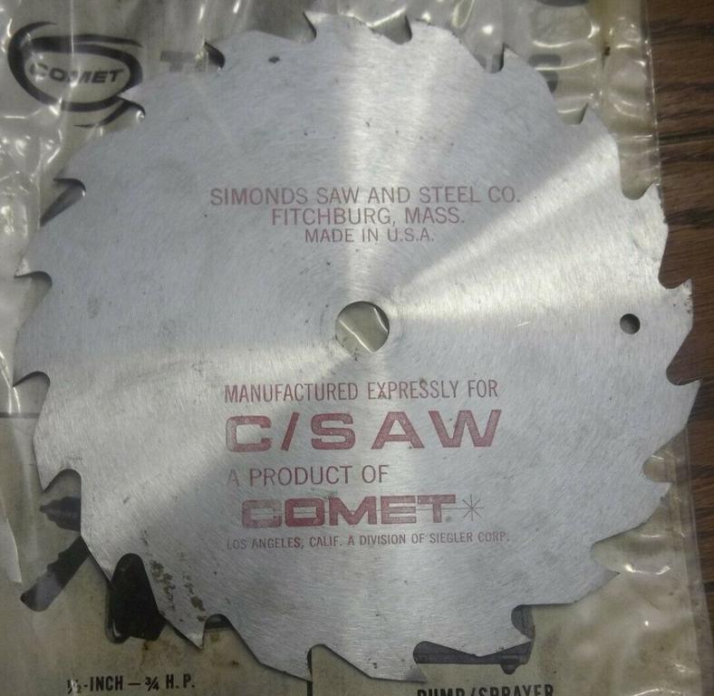

factory 487 #44 Posted August 1, 2019 1 hour ago, K-TRON said: Very nice Comet C-SAW. I have one identical to yours. If you click my user name you should be able to find the thread I have on it on here. Here is a link to Chris's nice Comet C/Saw. 1 hour ago, K-TRON said: I have an 8-1/4" fine tooth 5/8" arbor blade on my C-SAW. It is about all that it can handle. I have tried more aggressive blades and the drive belt will slip. Just had a look through my saved pictures and found this one showing the type of blade originally supplied with the Comet C/Saw, is this more aggressive than the one you are currently using? I'm also surprised that so many of these Comet Saws appear to have had very little use. David Share this post Link to post Share on other sites
K-TRON 25 #45 Posted August 1, 2019 I am honestly shocked that this saw was fit with such an aggressive blade from the factory. I had tried a carbide tipped blade much like that and the belt continued to slip no matter how I adjusted the drive belt, and how slow I fed it wood. I suspect that the reason for this was due to the inherently wider cut made by the style of blade that I used. The teeth are very closely set on the blade I currently run, and it works well. Chris Share this post Link to post Share on other sites
