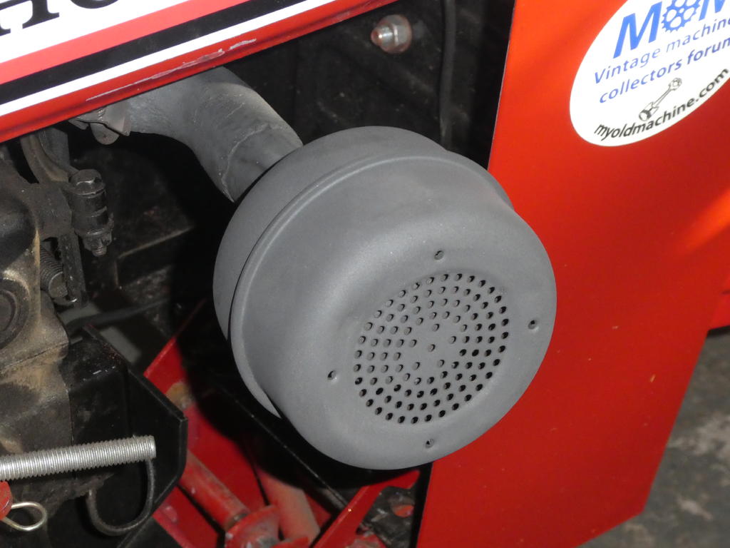

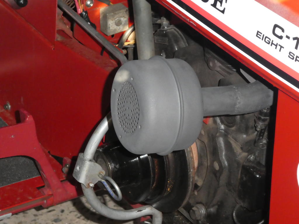

Stormin 4,458 #1 Posted July 31, 2019 Had a bit of a mishap when mowing alongside the pond, outside our abode last week. There's a big willow tree that I pass under and I push the hanging strands to one side as I do so. These are practically touching the ground and this time I didn't quite get things right. Some strands tangled round the stack and snapped off the silencer/muffler. Just above the clamp. Went to a local tractor, quad, garden machinery outfit to see what they had. Only thing kind of suitable was a silencer/muffler for B&S 10 - 12hp engines. Had to order it and I picked it up today. It was made to screw into the head, but as can be imagined, the stub in the Kohler head was not going to budge. A little bit of measuring told me the existing pipe O.D. just above the bend, was slightly bigger than the new silencers. So I cut the pipe just below the join and off to the farm workshop to borrow the ocy/acet and heat the end of the bent pipe up. Getting it red hot allowed me to screw the threaded end of the new silencer into it. Worked a treat and no welding was needed, as the fit was good and tight. Fitted to the engine and we're back in business. OH! The willow has had a bit of a trim as well. 3 1 Triumph66, Cub Cadet, nigel and 1 other reacted to this Share this post Link to post Share on other sites

Stormin 4,458 #5 Posted August 7, 2019 I found the exhaust as mounted, was sending exhaust fumes back towards my face. So it got modified yesterday. Not tried it yet, but should be a lot better. 1 WestwoodW8Gazelle reacted to this Share this post Link to post Share on other sites
