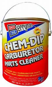

Wallfish 718 #55 Posted May 30, 2020 You can soak that head in a can of carb cleaner to remove the paint. Just let it soak for a while, use a stiff bristle brush and re-soak if it still needs it. 1 CNew reacted to this Share this post Link to post Share on other sites
