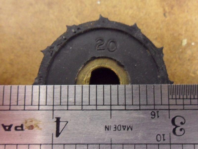

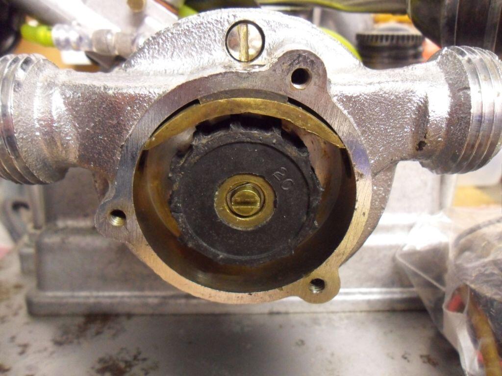

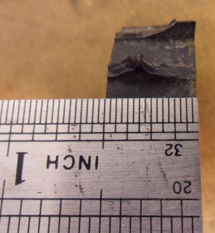

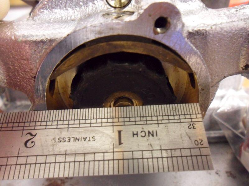

Mike in NC 37 #11 Posted July 12, 2020 We have a pump just like the one pictured. It is missing the pump impeller. Does anyone know where one could be found? Thanks in advance!! 2 CNew and factory reacted to this Share this post Link to post Share on other sites
CNew 408 #12 Posted July 12, 2020 Welcome to the forum Mike! Nice looking pump! I’m missing one of the little pumps as well for a different pump I have. I haven’t been able to locate anything like it yet. I’ve been tempted to try to find a used transfer pump kind of like this just to see if maybe it would fit. There are several off-brands of these small pumps so I’m sure one can be found on the cheap. https://www.northerntool.com/shop/tools/product_200352045_200352045 1 Mike in NC reacted to this Share this post Link to post Share on other sites
Wallfish 716 #13 Posted July 12, 2020 Direct from Northern Tool concerning the impeller for the pump in that link. Try giving them a call and I doubt that part can be very expensive. I do NOT know if it's a direct fit or not but certainly appears it can work 1 answer where can I get a new impeller for this pump?? by frankhus November 5, 2011 Was this question helpful to you? 6out of 6found this question helpful. Please call our parts department @ 1-800-222-5381 for price and availability. 1 CNew reacted to this Share this post Link to post Share on other sites
factory 487 #14 Posted July 12, 2020 17 hours ago, Mike in NC said: We have a pump just like the one pictured. It is missing the pump impeller. Does anyone know where one could be found? Thanks in advance!! Welcome Mike, there are several different O&R pumps that all seem to use the pump & impeller, I have three different ones here & only one where the impeller is intact, I should really get some measurements from it. This is the impeller remains from my Petro Chug-A-Pump with some measurements (pictures taken years ago). David 1 Mike in NC reacted to this Share this post Link to post Share on other sites

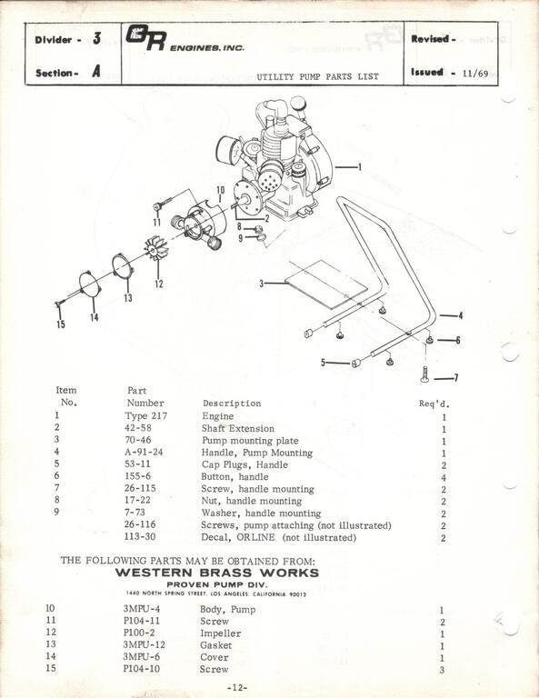

factory 487 #15 Posted July 12, 2020 I'm sure I've posted this somewhere on the forum before, here is the parts list for the Orline Utility Pump with O&R Type 217 engine; David 2 CNew and Mike in NC reacted to this Share this post Link to post Share on other sites
