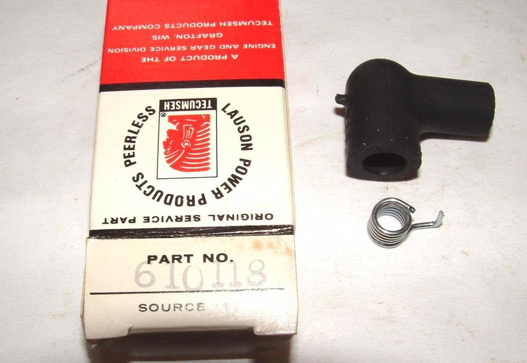

factory 487 #39 Posted November 16, 2019 3 hours ago, JUST O&R said: Will shes done this one didn't take to long tank was the worst. now on to the next ? what will that be ( yes it has the wrong coil ) Very nice , there is nothing wrong with using the replacement coil, that is exactly what would have been fitted if one had failed in the past. Did the replacement coil fit the starter housing OK? I found out that an older coil doesn't fit a newer housing. Did you get the original insulator cap for the spark-plug when you bought the engine? David Share this post Link to post Share on other sites
factory 487 #40 Posted November 16, 2019 3 hours ago, JUST O&R said: body filler. 3 hours ago, JUST O&R said: I get in the tanks first with these and push out as much as I can. I have bent them to get were I need to go first That tank looks like new now, excellent repair. Are those modified spark-plug/screwdriver tools that come with engine powered garden tools? David Share this post Link to post Share on other sites
JUST O&R 237 #41 Posted November 17, 2019 (edited) 12 hours ago, factory said: Very nice , there is nothing wrong with using the replacement coil, that is exactly what would have been fitted if one had failed in the past. Did the replacement coil fit the starter housing OK? I found out that an older coil doesn't fit a newer housing. Did you get the original insulator cap for the spark-plug when you bought the engine? David The coil fit rite in place the wire was to long and cracked had to do a little repair there. I don't like using new parts because once you put them on an engine there gone. still have a few used ones to use first. Yes I got the insulator cap with the Engine I'm missing about 6 of them don't know what I'm going to put it on. p.s. Those are plug wrenches Edited November 17, 2019 by JUST O&R Share this post Link to post Share on other sites
CNew 408 #42 Posted November 17, 2019 For th insulator cap would it be possible to wrap a little foil around it and then use heat shrink tubing to make a custom fit cap (then remove the foil of course)? 17 hours ago, JUST O&R said: body filler. By the way, what brand/color of red paint do you use- that’s a pretty nice match to original O&R? Share this post Link to post Share on other sites
JUST O&R 237 #43 Posted November 17, 2019 Not sure will look when I go to the shop. I know its engine paint Ill let you know. Share this post Link to post Share on other sites
Wallfish 718 #44 Posted November 17, 2019 2 hours ago, CNew said: For th insulator cap would it be possible to wrap a little foil around it and then use heat shrink tubing to make a custom fit cap (then remove the foil of course)? @usedtoolman did a write up a while back on some he did using the tool handle dip stuff. They came out really nice and resembled the originals pretty closely. Stuff like this in black https://www.walmart.com/ip/Dip-and-Grip-Rubberized-Plastic-Coating-8-fl-oz/114063539?sourceid=csebr0339853b01ce1b488d883413eb59d01d2f&wmlspartner=bizratecom&affcmpid=3179675693&tmode=0000&veh=cse&szredirectid=15740028324123095426410070301008005 Share this post Link to post Share on other sites
Webhead 95 #45 Posted November 17, 2019 52 minutes ago, Wallfish said: @usedtoolman did a write up a while back on some he did using the tool handle dip stuff. They came out really nice and resembled the originals pretty closely. Stuff like this in black https://www.walmart.com/ip/Dip-and-Grip-Rubberized-Plastic-Coating-8-fl-oz/114063539?sourceid=csebr0339853b01ce1b488d883413eb59d01d2f&wmlspartner=bizratecom&affcmpid=3179675693&tmode=0000&veh=cse&szredirectid=15740028324123095426410070301008005 What about something like this in the correct size? https://intothewind.com/gray-caps-337-350-inch-spars.html 1 JUST O&R reacted to this Share this post Link to post Share on other sites
JUST O&R 237 #46 Posted November 17, 2019 I like that stretch that out at the bottom and maybe heat it with a heat gun to swell it a little that would be almost perfect. Will try that thanks . If you made a small template that dip-and- grip looks like it would work great too. Might just have to try that too. I will let you know! Share this post Link to post Share on other sites
Wallfish 718 #47 Posted November 17, 2019 Usedtoolman Jim is a machinist and he did exactly that with using a template he made to match the original caps. I like the cap idea Joe posted too. Kind of funny how the picture they use to sell them looks like the bottom of it was cut off with a clam shell. Share this post Link to post Share on other sites
factory 487 #48 Posted November 17, 2019 I thought @usedtoolman might have machined a mould to make those spark-plug caps. If you need a later style cap then Tecumseh part no. #610118 is the same, just make sure it's an original one and not a later version (with same part no.) before buying, been there bought the wrong one got the t-shirt. David Share this post Link to post Share on other sites
