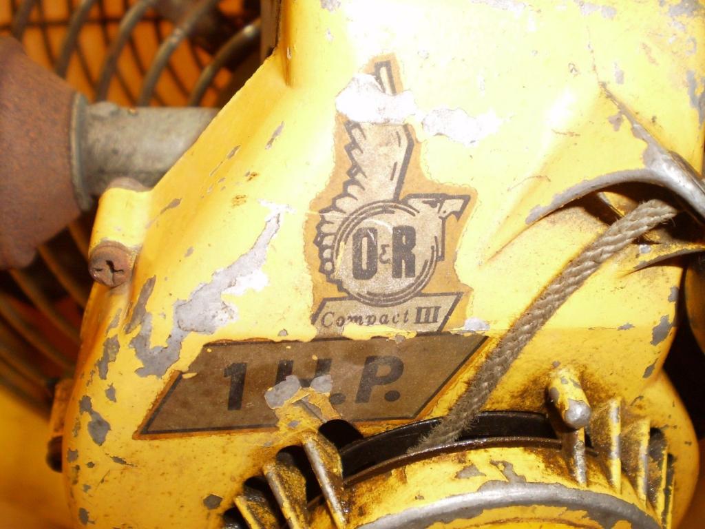

factory 487 #62 Posted February 17, 2020 Looking good, just needs a fuel line & a 1HP decal, it's one from either 1968 or 69 with the serial number decal on the cylinder cooling baffle. David Share this post Link to post Share on other sites
CNew 408 #63 Posted February 17, 2020 Do you have a photo of the other style 1 hp decal you’re referring to? Share this post Link to post Share on other sites
factory 487 #64 Posted February 17, 2020 It's the standard Compact III 1HP decal as shown below, I can't guarantee it but I may have one I can scan. David Share this post Link to post Share on other sites
CNew 408 #65 Posted February 18, 2020 Ok, how about this... 1 factory reacted to this Share this post Link to post Share on other sites

factory 487 #67 Posted February 18, 2020 20 hours ago, CNew said: Ok, how about this... That's better. David Share this post Link to post Share on other sites
