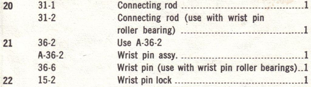

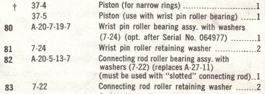

factory 487 #21 Posted February 22, 2020 On 2/19/2020 at 2:27 PM, JUST O&R said: From what I see they should fit a price list I have the numbers supersede I'm not sure on the a-27-3 I have no # change but it has a metal case. David will know for sure By the way the 1971 price list fails to mention* anything about the A-27-11 main con-rod bearing change to A-20-5-13-7, that must be used with a slotted con-rod and also a change of piston & wrist pin, here is the April 1964 parts list information; From the August 1964 parts list, the con-rod main bearing was changed to A-20-5-16-7 with 7-25 washers. David *Which is why it takes a long time to cross check to find the correct information, also note you will find more bearing differences with engines below SN 006072. Share this post Link to post Share on other sites
