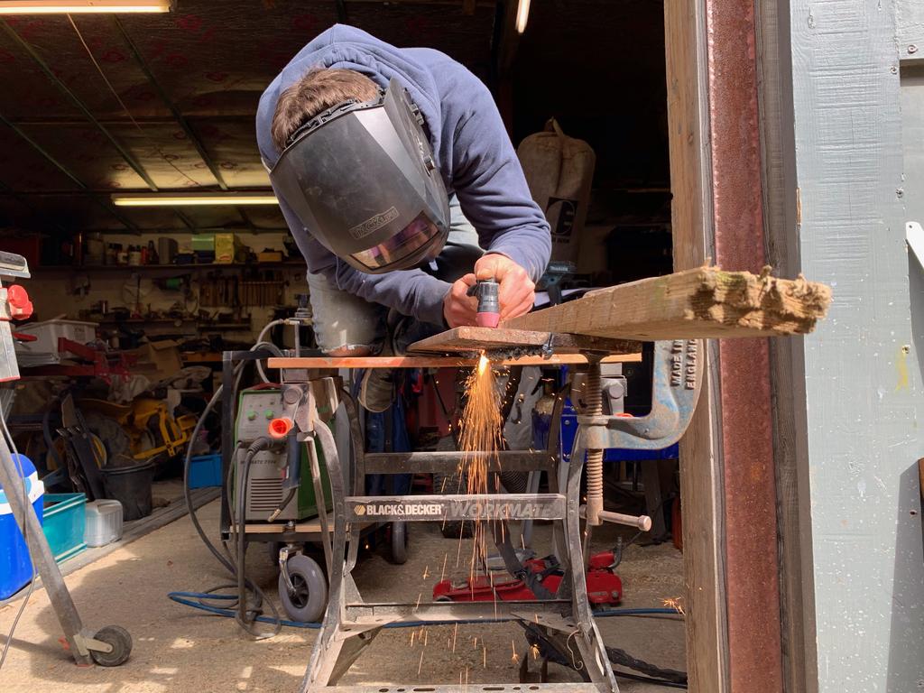

Cub Cadet 613 #9 Posted April 18, 2020 Nice buy Joseph, I bought one last year and its a great tool, I'd definitely recommend the cutting guide as it keeps the torch an equal distance away from the metal at all times as i've found the cutting nozzles wear out quicker if its touching the metal. You'll also find that its not necessary to clean all of the metal surface, just the part that the earth clips to. Heres me cutting some 1/2" steel last week and happy cutting! 2 Alan and Stormin reacted to this Share this post Link to post Share on other sites
