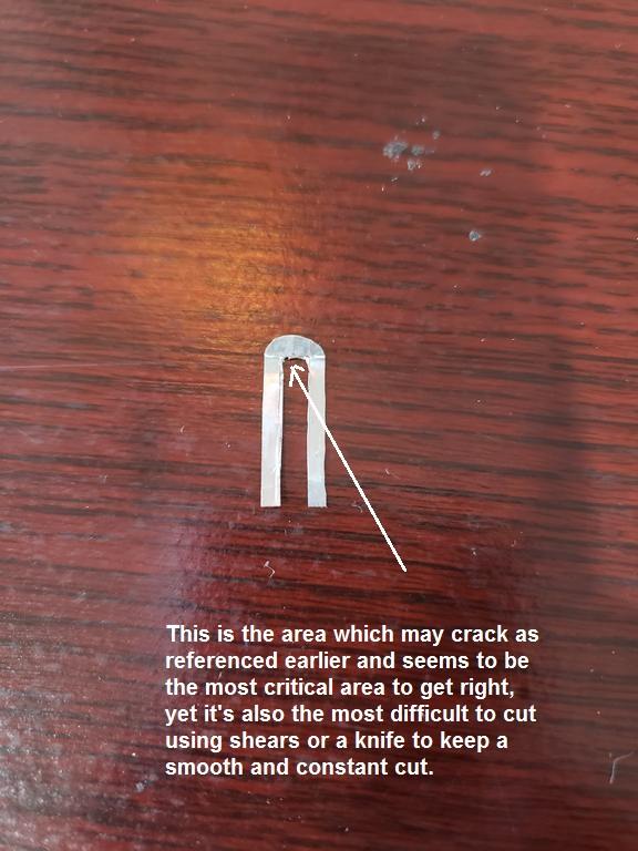

Wallfish 718 #18 Posted March 30, 2020 Trial and error is typically the process I use. The tension of the .002 spring installed into the carb should work but it does feel a little light. The .003 material is what I'd suggest trying next and at minimum that feeler gauge material at that thickness should work best (So Far). One thing to be careful of if cutting by hand, the spring steel will easily crack. Already had one crack off the little arm because of the cut on the inside corner. This is where a better cutting method will pay off. Tried cutting that inside piece out with an xacto, scissors and just bending to break it. That area is the most important it seems so even if a cutting method for that spot is used, the rest can easily be cut with shears. I'll try making my own die today to try and punch that out. Share this post Link to post Share on other sites

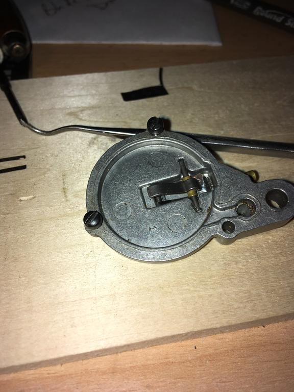

scott mok 3 #19 Posted March 30, 2020 Heres my first try, It me about an hour to make what you think Scott 2 CNew and Wallfish reacted to this Share this post Link to post Share on other sites
Wallfish 718 #20 Posted March 30, 2020 Guess you won't be able to FEEL anything at .003 either huh? Looks good. I'll get you some parts in the mail to give it a real world test in the engine. After closer inspection of the pics you PMd, that diaphragm body you have is a newer type which used a small rubber piece attached to the arm for the valve instead of using a ball bearing like the drawing you referenced. Unfortunately that particular arm is another part which is in very short supply. However, changing that bottom half to a ball type valve body with a regular type bearing valve and arm will solve the problem. I'll get you the needed parts to try that spring. Please look at that carb diagram thoroughly again and verify you have all of the gaskets and that thin little check valve which fits between the 2 halves. Share this post Link to post Share on other sites
