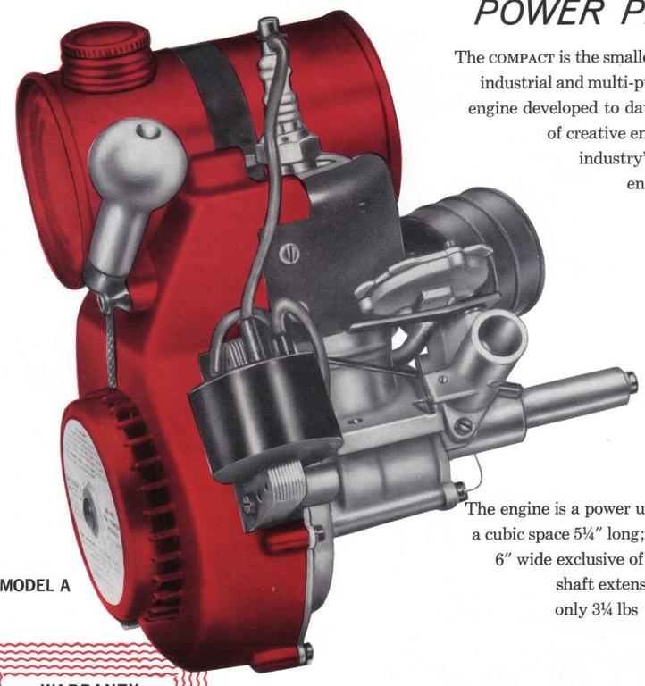

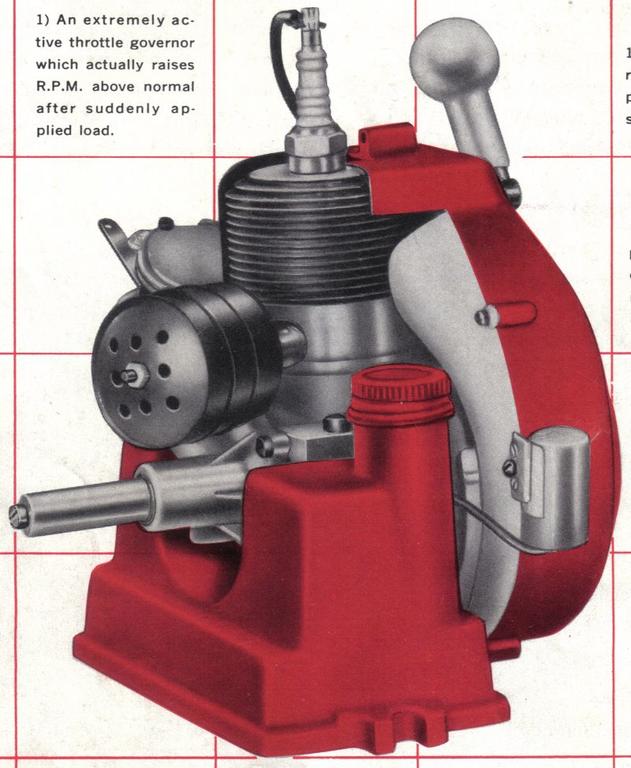

factory 487 #8 Posted April 5, 2020 These date from sometime between August 1960 to 1961, gearbox models were not available in August 1960, but were due to go into production soon. Here are some pictures from the first brochure, which show the features of these early engines. David 1 CNew reacted to this Share this post Link to post Share on other sites
