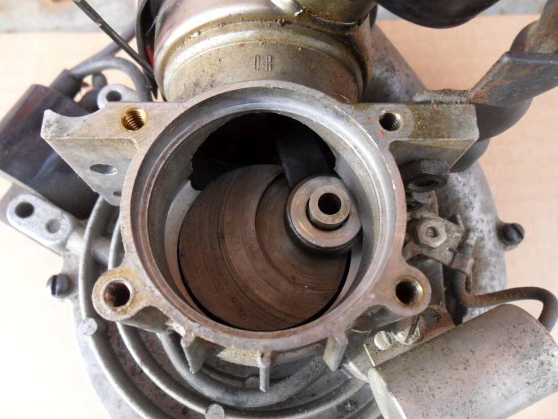

factory 487 #26 Posted April 6, 2020 17 hours ago, CNew said: The only thing that resembled a seal is some thin black coating stuff that looked like a thin layer of gasket maker where the feather vane gasket would normally go Mine has a rubber sealing ring for the feather valve to the crankcase seal (it is squashed into the what looks like a square section, I didn't take it off to check), no paper gaskets, they don't have them according to the parts list. The exhaust collector apparently also has a sealing ring, I haven't taken mine apart as I don't want to damage it knowing that no NOS ones exist to copy the sizes from (pre-squashed). You may notice mine doesn't have the fourth hole in the induction housing casting, the crankcase has all four threaded holes but no counterbore for the small o-ring (unlike yours which does). The bronze cages are also used in the later model aeroplane engines, I never took the bearings out of my early Compact, so never found out that they had used them very briefly for these engines, you should notice all the bearing cages (apart from the con-rod) are the half cage versions. Other differences you should notice are the stud & nut for the fourth threaded hole in the base tank and no oil hole in the starter rivet (with no mention on the decal either). David 1 CNew reacted to this Share this post Link to post Share on other sites
CNew 408 #27 Posted April 6, 2020 David, Do you have any way to measure the thickness of that black sealing ring? Mine must have gotten squished and deteriorated over time. The exhaust collector has a similar material/seal. I didn’t remove the seal from the collector, leaving it on there and hoping it will seal up enough for the shelf... Share this post Link to post Share on other sites
factory 487 #28 Posted April 6, 2020 The trouble is we really need new-old-stock ones to measure, mine will also be compressed between the castings and stretched around the feather valve, the sizes from the compressed seals will be exactly the same as the diameter & thickness of the gap it seals, I also don't want them disintegrate if I try to remove them. I have another early engine in bits which is missing all these seals, maybe it would be easier to measure this and find something just a little bit larger to allow it them compress & seal properly. David Share this post Link to post Share on other sites
CNew 408 #29 Posted April 6, 2020 Definitely don’t remove it! It looks roughly like 1/16x1/16 in the photo. I can probably get a square o-ring from McMaster Carr, although it might not be squishy enough. I just took another look at my induction housing and it looks like there might still be enough of that seal in there. It is compressed and formed in place so I think I’ll leave it be. Share this post Link to post Share on other sites

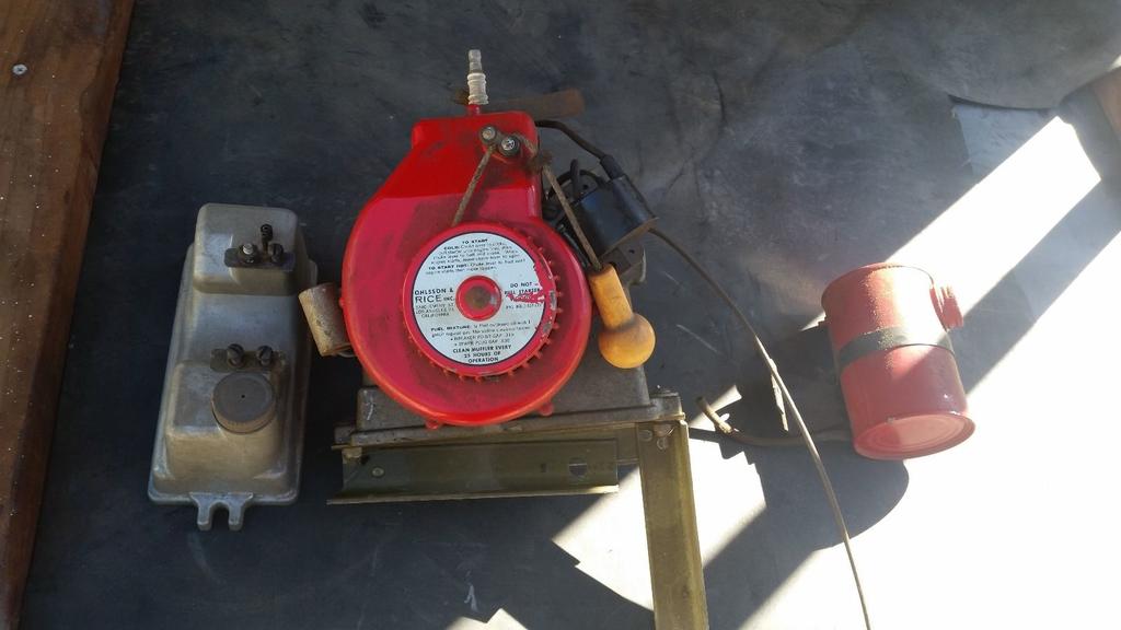

factory 487 #38 Posted April 13, 2020 Maybe as we have both seen it before. I was looking through my saved pictures yesterday and came across this one; David 1 CNew reacted to this Share this post Link to post Share on other sites

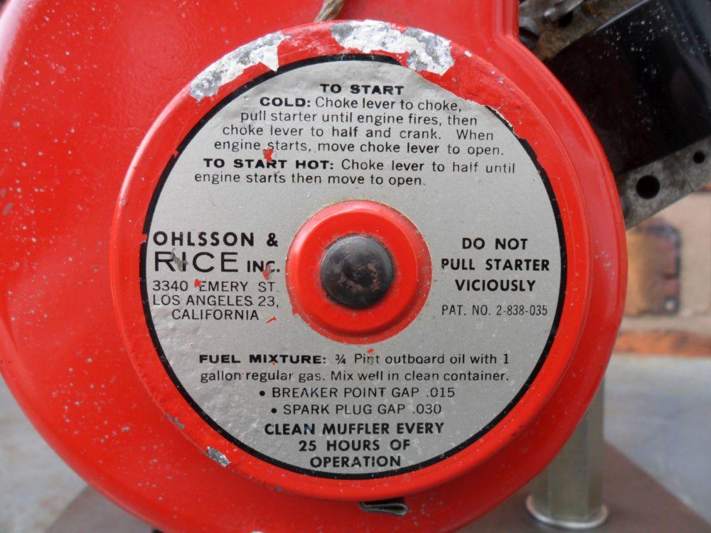

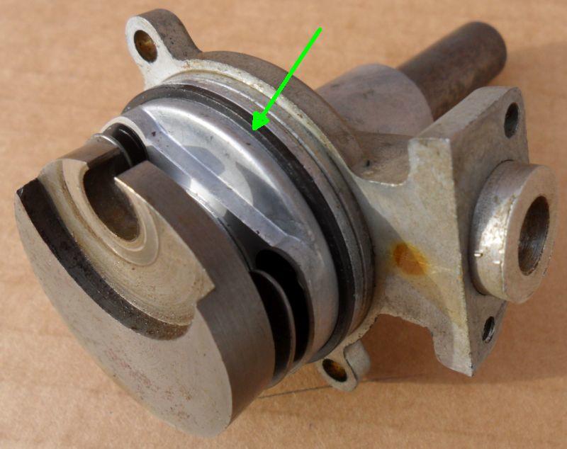

factory 487 #39 Posted April 19, 2020 The brochure, outline drawings & parts diagram (Model A) for these early engines has now been scanned & added to the manuals thread. That strange piston with three rings is mentioned in both the brochure & shown in the parts diagram/list. David 1 JUST O&R reacted to this Share this post Link to post Share on other sites
factory 487 #40 Posted April 19, 2020 On 4/13/2020 at 9:30 PM, Wallfish said: No, should I? I should probably explain, this unusual early engine with gearbox was on ePay about 3 years ago, unfortunately I couldn't bid (or even ask for more info/pictures) as the seller had the usual international buyer blocking, it was also payment in cash & collection only. You helped me by contacting the seller, but sadly they never replied, that one picture is all I have from the listing. It's good to know the engine survived & has found a home with CNew, as it never sold on ePay & I really thought it had been lost for good. David 1 CNew reacted to this Share this post Link to post Share on other sites
CNew 408 #41 Posted April 19, 2020 37 minutes ago, factory said: It's good to know the engine survived & has found a home with CNew, as it never sold on ePay & I really thought it had been lost for good. Small world, glad I was able to get this one. Sorry to hear it didn’t go so well when you tried for it a couple years ago. As far as I know it’s the oldest engine I have. 2 JUST O&R and factory reacted to this Share this post Link to post Share on other sites
