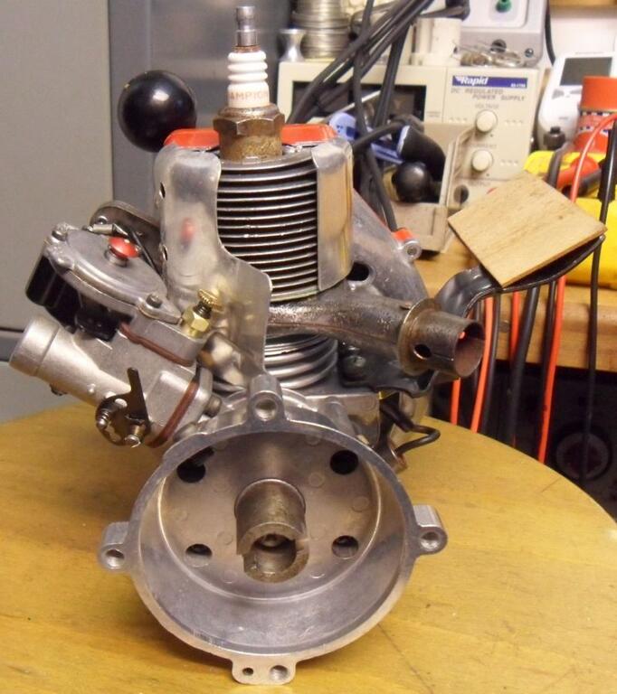

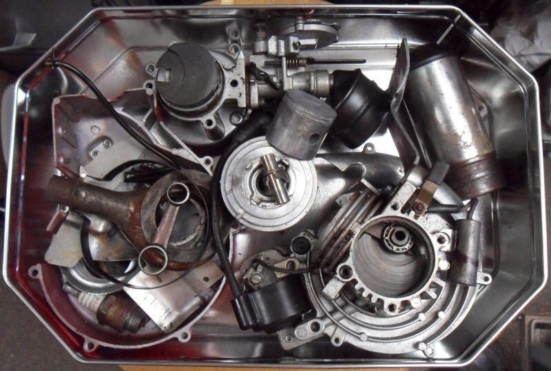

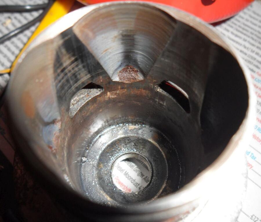

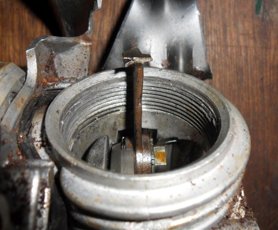

factory 487 #1 Posted May 27, 2020 I've had this for some time, it was seized & a previous owner had removed the cylinder without freeing up the piston resulting in a snapped con-rod. I dissembled it a few years ago & managed to remove the piston intact, unfortunately the rings are stuck for good, I suspect it got run without any oil. The engine has been in bits in this biscuit tin for far too long, it's time to clean & rebuild it. David 1 CNew reacted to this Share this post Link to post Share on other sites

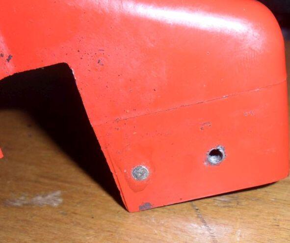

factory 487 #2 Posted May 27, 2020 Something else I noticed when I took it apart further, the wire for the coil primary to the points/condenser had been incorrectly routed & had got crushed between the magneto plate & cylinder, this will need sleeving. The HT lead also has damage to the insulation. Most of the parts got cleaned outside earlier, apart from the rusty exhaust it's all cleaned up nicely. David 2 Wallfish and pmackellow reacted to this Share this post Link to post Share on other sites

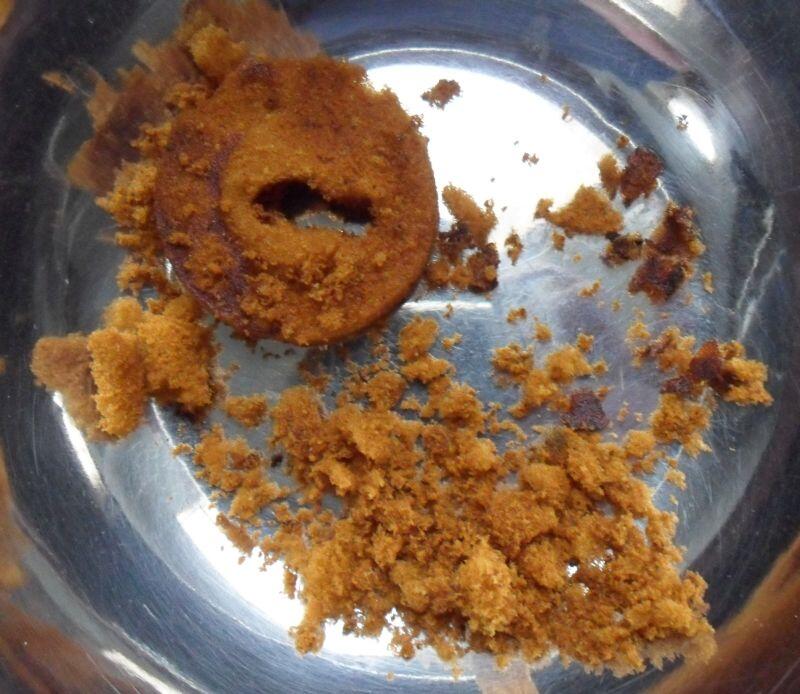

CNew 408 #4 Posted May 28, 2020 3 hours ago, factory said: Interesting exhaust, you don’t see those tube extensions very often. I’m assuming it’s just hollow or are there baffles inside? 1 pmackellow reacted to this Share this post Link to post Share on other sites
factory 487 #5 Posted May 28, 2020 11 hours ago, Wallfish said: Yeah, you're like me and have stuff sitting around waiting far too long to be the next project. One project I haven't seen yet is that hedge trimmer. Took me long enough to send it so thought you would've been excited to get that one going. I forgot to mention that this had been apart in that tin for at least 4 years, the last time when my health was poor & I couldn't work on anything, that very nice trimmer you sent will be one of the next projects once this one is back together (which hopefully should be more straight forward than some of the other projects). Still got to sort out one of these generators for you too. 9 hours ago, CNew said: Interesting exhaust, you don’t see those tube extensions very often. I’m assuming it’s just hollow or are there baffles inside? The extension contains a mix of what is probably asbestos with steel wire mesh, will try a get a picture with the end removed, but will be leaving the core inside the tube when it gets the chrome cleaned. Fairly certain it's only found on some UK tools. David Share this post Link to post Share on other sites
Fishnuts2 22 #6 Posted May 28, 2020 16 hours ago, factory said: Something else I noticed when I took it apart further, the wire for the coil primary to the points/condenser had been incorrectly routed & had got crushed between the magneto plate & cylinder, this will need sleeving. The HT lead also has damage to the insulation. Most of the parts got cleaned outside earlier, apart from the rusty exhaust it's all cleaned up nicely. David My first O & R chainsaw project had the same wire pinch with corresponding results. I used liquid tape and routed it properly. 1 pmackellow reacted to this Share this post Link to post Share on other sites
factory 487 #7 Posted May 28, 2020 I don't have liquid tape but as I also collect & repair vintage electronics I have a box full of various different sized heat-shrink tubing, I used a piece of 3:1 or 4:1 ratio heat-shrink tubing that just fits over the crimp terminal, thinking about it I could have removed the terminal & used smaller diameter heat-shrink, got to remind myself I have a good supply of ring crimp terminals I could have used. David Share this post Link to post Share on other sites

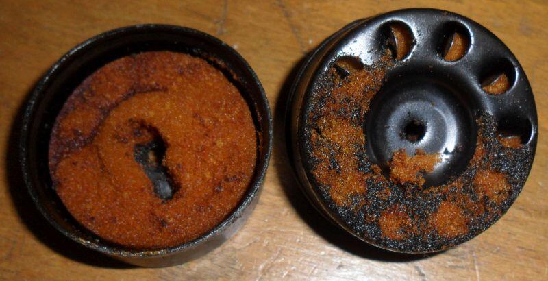

factory 487 #8 Posted May 28, 2020 20 hours ago, CNew said: Interesting exhaust, you don’t see those tube extensions very often. I’m assuming it’s just hollow or are there baffles inside? Here's a picture of the inside, looks like Hazmat to me, lots of chucks of rust fell out too. I'm not sure why all the plated steel parts have rusted so badly on this engine (see the threads on the end of the exhaust fixing rod for example), as the paintwork is in excellent condition and the engine looks to have had very little use before it seized. David Share this post Link to post Share on other sites
CNew 408 #9 Posted May 29, 2020 4 hours ago, factory said: Interesting, not at all what I expected that to look like. Share this post Link to post Share on other sites
factory 487 #10 Posted May 29, 2020 If you wanted a similar looking exhaust it probably wouldn't be too hard to make, if you can find the correct size chrome tubing, just don't go filling it with that stuff though. David 1 CNew reacted to this Share this post Link to post Share on other sites

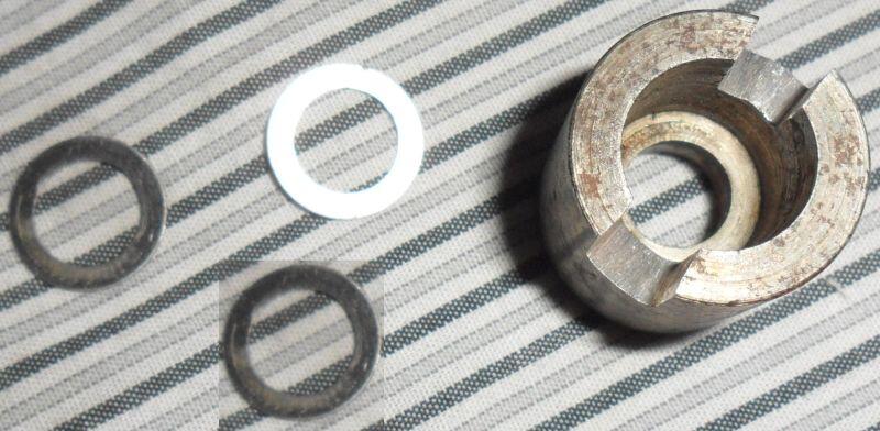

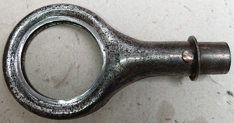

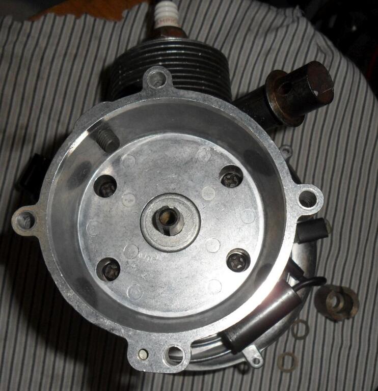

factory 487 #11 Posted May 29, 2020 (edited) The engine is now mostly back together apart from the carb & starter. This exhaust collector was a bit too far gone for the aluminium foil cleaning method, it was so rusty I had to use the big wire wheel to start with, followed by lots of sanding with the Dremel to get the gasket surfaces smoother (as best I could), forgot to take a before picture. I had to make a few more gaskets for the induction & feather valve assemblies. Here is the coupling used on these UK Champ generators, this one has two three thin washers as the coupling doesn't quite fit level with the PTO shaft. David Edited June 2, 2020 by factory Error with number of washers for coupling. 1 Wallfish reacted to this Share this post Link to post Share on other sites
Wallfish 718 #12 Posted May 29, 2020 1 hour ago, factory said: exhaust collector was a bit too far gone for the aluminium foil cleaning method, it was so rusty I had to use the big wire wheel to start with, Have had plenty of those over the years and there's a collection of them out there. Share this post Link to post Share on other sites
factory 487 #13 Posted May 29, 2020 I do have a couple of new & used ones, but don't want to use them unless really needed, I had one a while back that had been badly bent & the flanges would never have sealed against the gaskets (that got replaced). This one wasn't rusted through, just badly pitted, the Dremel has smoothed it enough that it should seal fine. David Share this post Link to post Share on other sites

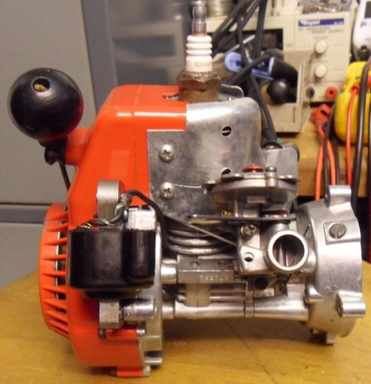

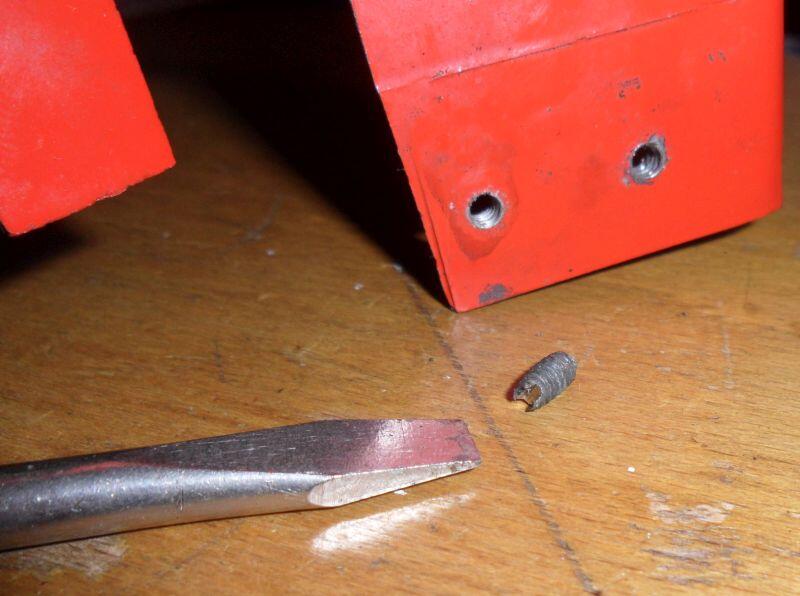

factory 487 #14 Posted June 2, 2020 Today's progress, the starter was in very good condition apart from a broken screw for the cylinder baffle plate, which soon got removed with the help of the Dremel cutting disc to add a slot. Also rebuilt the carb & cleaned out the air cleaner today, I still need to order some smaller HT lead to repair the coil & find a tank, but hopefully I'll get the rest of this one finished tomorrow. David 2 Wallfish and pmackellow reacted to this Share this post Link to post Share on other sites

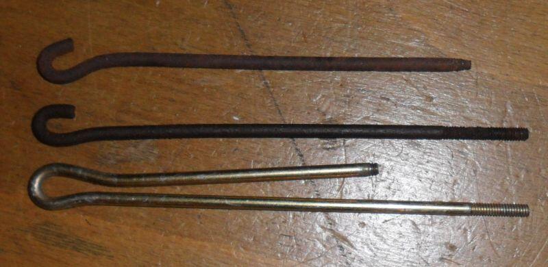

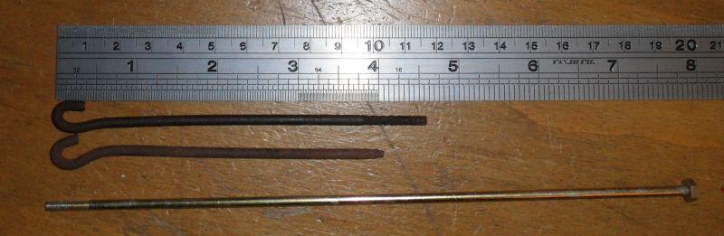

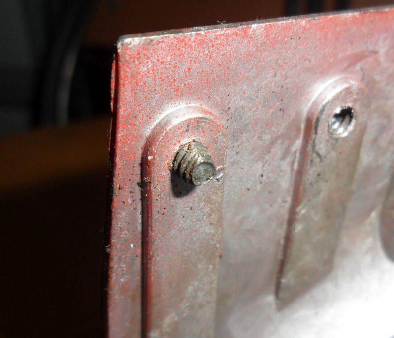

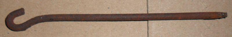

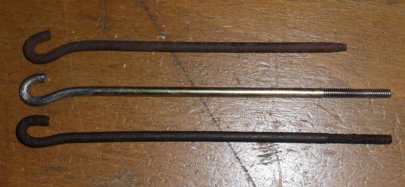

factory 487 #16 Posted June 3, 2020 All done apart from the HT lead & tank. The exhaust fixing rod was found to be too short, it had snapped off where the nut was fitted. Using one borrowed from another of these generators as a template I made a new one from some salvaged rod, the thread for both was #5x40, I also cut a new thread on the old one and added it to the spares box (it could be used for a different engine with a shorter exhaust). Hopefully it will be dry tomorrow & I can take some pictures of the generator outside. David 1 CNew reacted to this Share this post Link to post Share on other sites

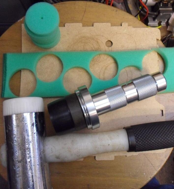

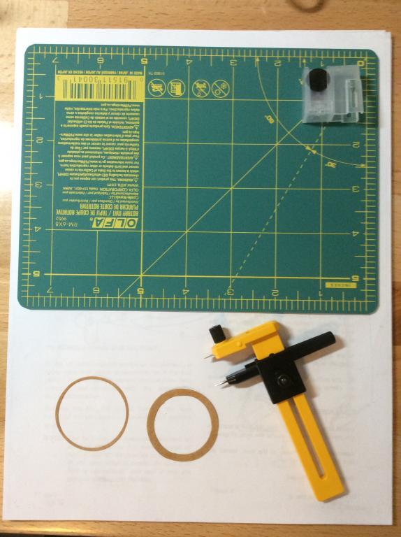

CNew 408 #17 Posted June 3, 2020 On 5/29/2020 at 2:59 PM, factory said: I had to make a few more gaskets for the induction & feather valve assemblies. David, I’m curious, what type of gasket paper and thickness did you end up sourcing for the induction and feather vane gaskets? Share this post Link to post Share on other sites
Daren89 18 #18 Posted June 4, 2020 2 hours ago, CNew said: David, I’m curious, what type of gasket paper and thickness did you end up sourcing for the induction and feather vane gaskets? how do you cut perfect circles Ta Daren Share this post Link to post Share on other sites
CNew 408 #19 Posted June 4, 2020 I use one of these Olfa circle cutters. For a couple gaskets here and there it actually does quite well, especially for the price. https://olfa.com/craft/product/compass-circle-cutter-cmp-1/ 2 Fishnuts2 and Daren89 reacted to this Share this post Link to post Share on other sites

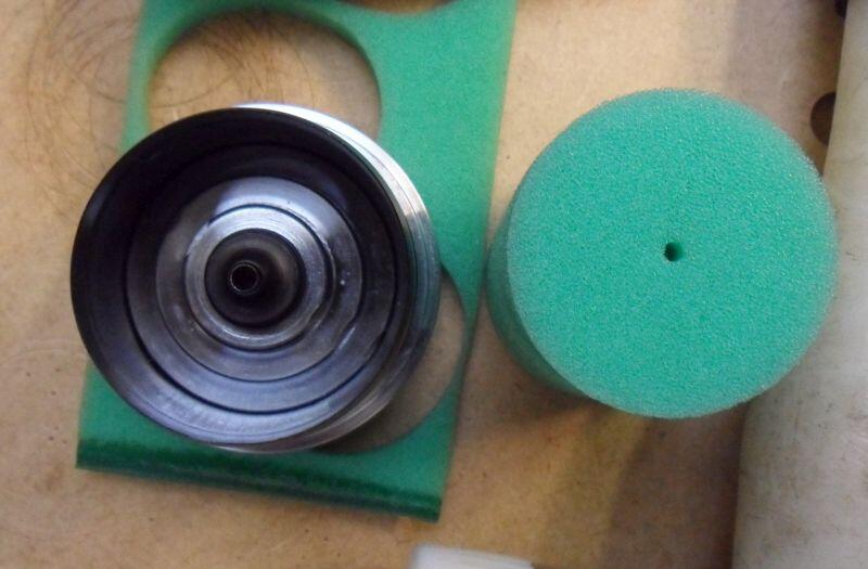

factory 487 #20 Posted June 4, 2020 20 hours ago, CNew said: David, I’m curious, what type of gasket paper and thickness did you end up sourcing for the induction and feather vane gaskets? The same Klinger Statite* gasket paper (cellulose fibre based) I've had for a long time, I bought a selection of small sheets in six sizes from 6 thou to 63 thou years ago. The size I used for the induction & feather valve assemblies for this engine was 6 thou, some later engines use a thicker size and towards the end they changed to using an 'O' ring seal (no paper gaskets). *The smaller sizes of Statite seem to have been discontinued, Flexoid also have the same type of gasket paper in the UK, similar gasket paper should be available from other companies depending where you are. 17 hours ago, Daren89 said: how do you cut perfect circles Ta Daren I have an industrial punch kit that also has a compass based cutter, it came from a business clearance company on ePay years ago for a third of the usual price, I suspect a lot more clearance stuff will appear later in the year from companies that are struggling at the moment. It got used again the other day to cut some more air filter foam, there is a point that can be fitted to the centre for locating the punches if you use two sizes that fit in the same place on the tool. The Olfa cutter looks a better choice if you only have a few engines. David 1 Daren89 reacted to this Share this post Link to post Share on other sites

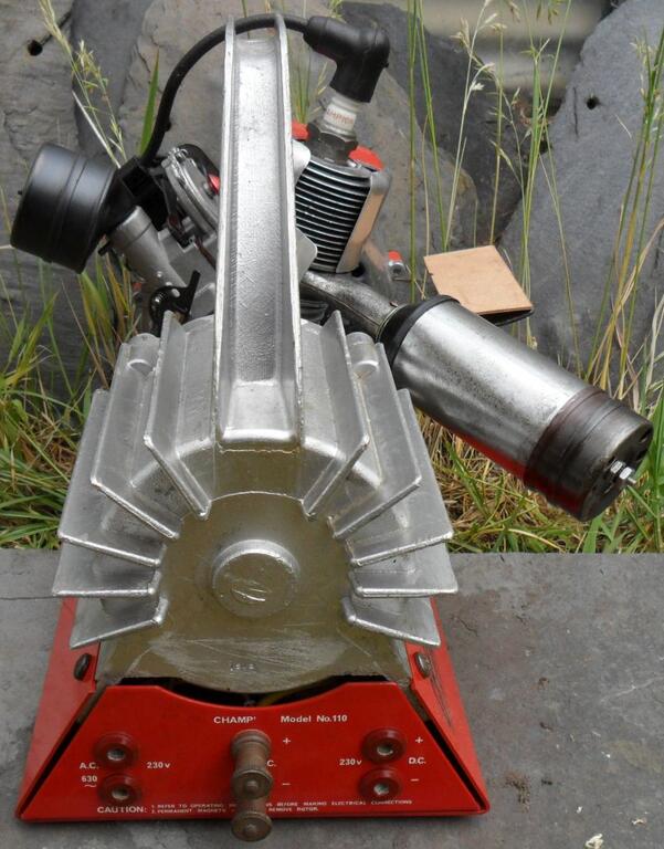

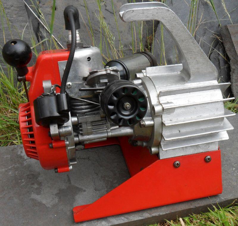

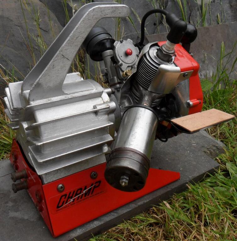

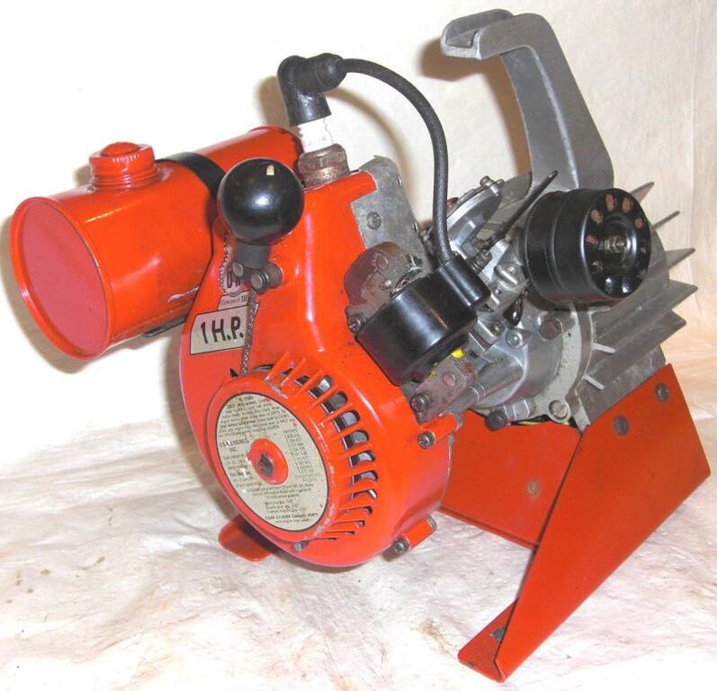

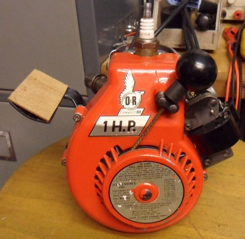

factory 487 #21 Posted June 4, 2020 Here are some pictures of the Champ generator now the engine has been reattached, taken in-between the rain today. David 5 pmackellow, Daren89, Wallfish and 2 others reacted to this Share this post Link to post Share on other sites
CNew 408 #22 Posted June 5, 2020 David, That turned out really nice, almost looks brand new! 1 factory reacted to this Share this post Link to post Share on other sites
Wallfish 718 #23 Posted June 5, 2020 NICE! Much better than a bunch of parts sitting in a box Glad to see you back in the restoration game 1 factory reacted to this Share this post Link to post Share on other sites
pmackellow 2,738 #24 Posted June 5, 2020 Nice job David ! 1 factory reacted to this Share this post Link to post Share on other sites
JUST O&R 237 #25 Posted June 5, 2020 That looks great keep up the good work 1 factory reacted to this Share this post Link to post Share on other sites
